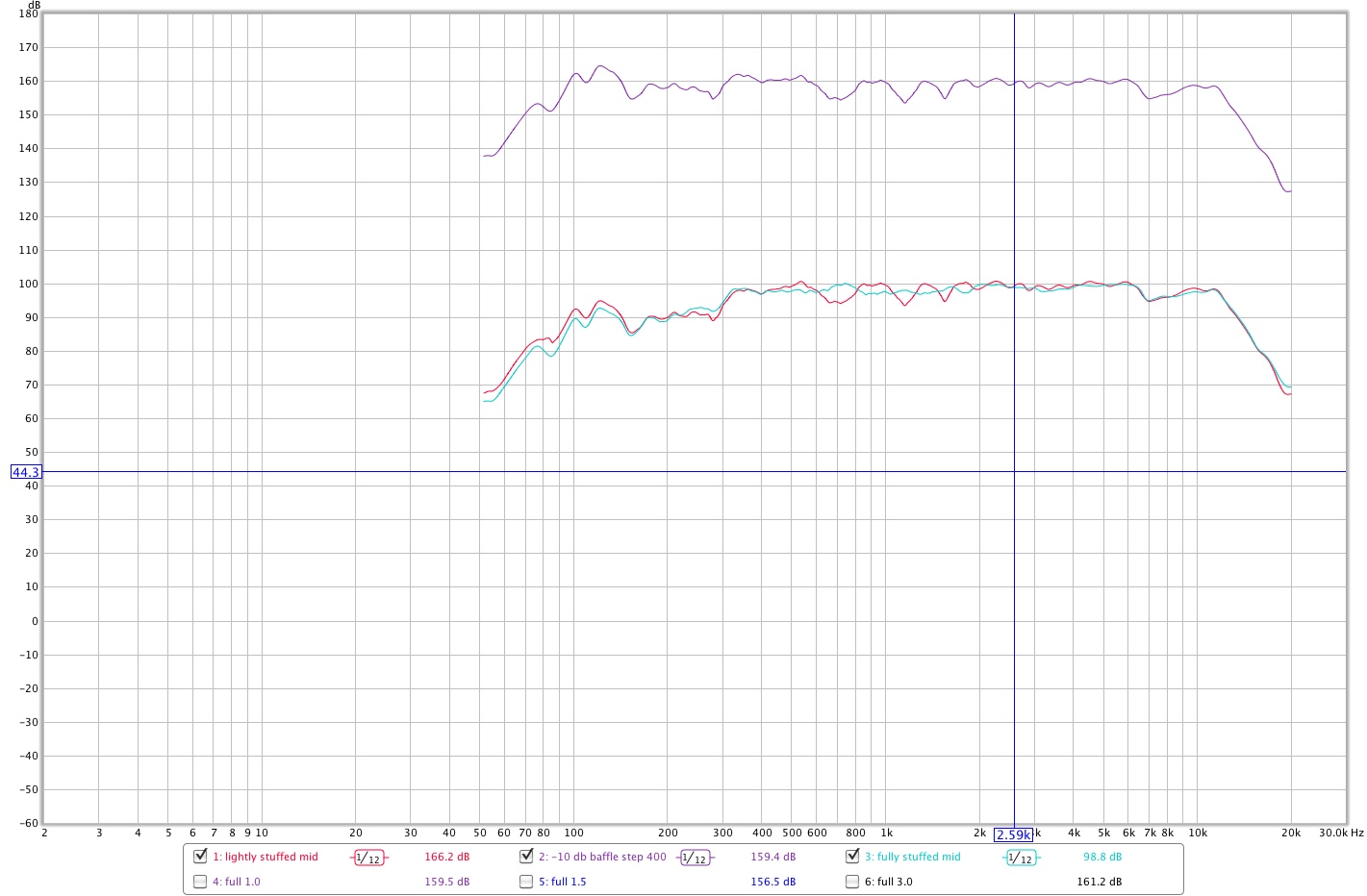

The image posted is of a Seas MCA15rcy, measured from 1 meter with no filtering applied, on axis and mounted in a 5 litre sealed enclosure. The optimum sealed volume for this driver yielding a Qtc of 0.707 is at around 1.7 litres. I have chosen an enlarged enclosure producing a Q of somewhere near 0.5 and completely full- though not packed - with dampening material.
These drivers phase track perfectly with the bass drivers from 220 to 330hz. In these enclosures however the roll off below 300 hz looks close to 12db per octave, which is very sudden. Ideally id love to cross these drivers over at 220hz however as you can see the amplitude at this point is at - 8db.
My aim is to extend the low end response of these drivers in this enclosure in order to achieve an even amplitude response of bass and mid at the crossover point.
I believe I have two choices. The first is to remove approximately 50% of dampening material. The second choice is to physically reduce the size of the enclosure.
A third more lateral approach would be to use a more gentle HP in the mid(12db) so as to combine the roll of to 24db per octave. Crossover between bass and mid is currently LR24.

I have posted a graph with three measurements. The green is the enclosure fully filled, the red is with virtually no dampening - just a one foot square piece- and the purple measurement is the unstuffed box with a -10db shelf applied at 400 hz as a baffle step.
As you can see the removal of dampening material has virtually no effect on the bass roll of and a large part of the response looks more ragged. I will however say that the unstuffed box is more dynamic and open. Over the coming days I'll ad dampening to arrive a a good balance with the impression now that the mids sounded slightly choked with the enclosure full of stuffing.
