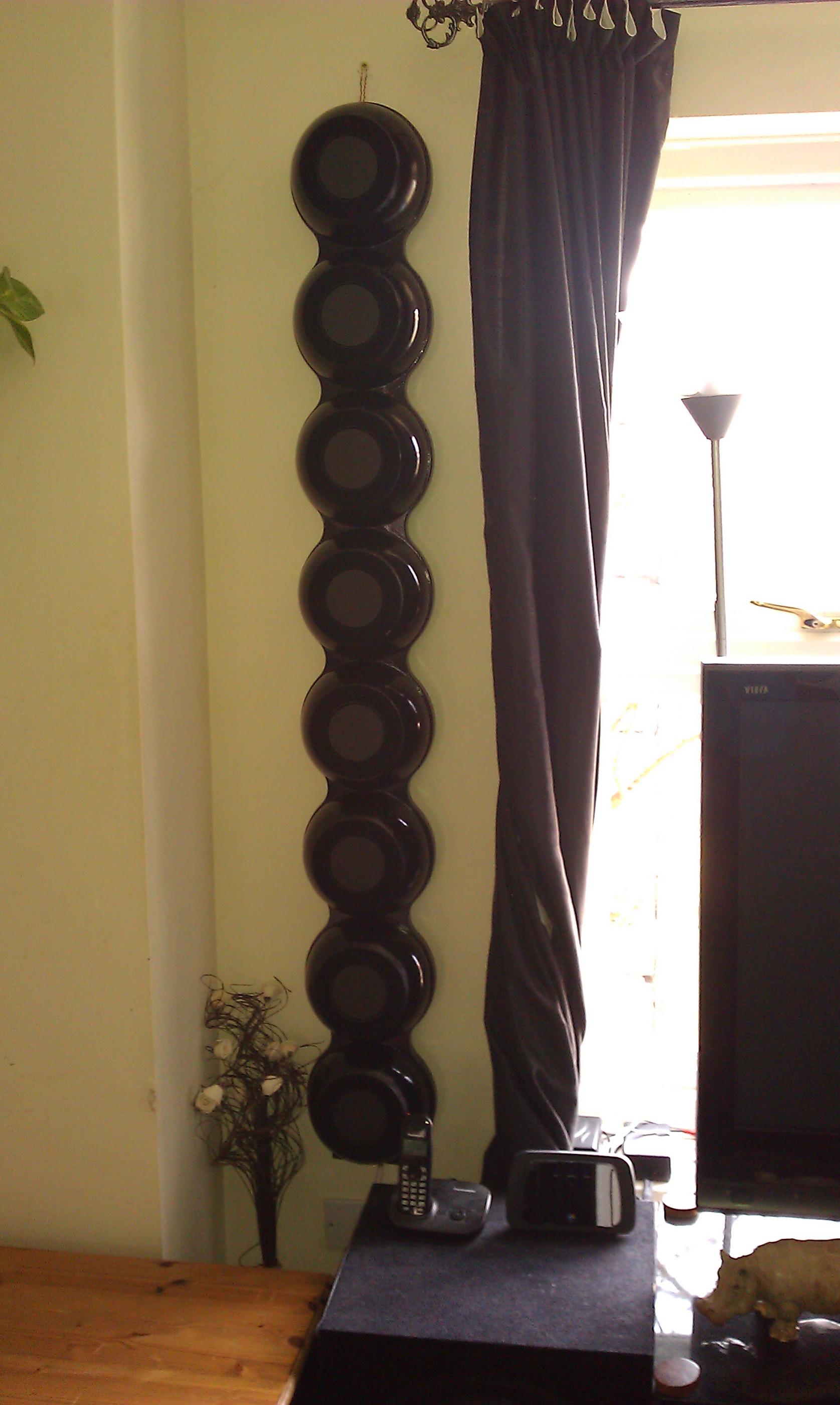

Sherical enclosure & flat over 200Hz to 8Khz
[QUOTE=ScottG;3873264
The problem with a larger sphere is that it usually moves the driver away from the next driver - with a resulting irregular response due to combing/interference. On the other hand if it's a small fullrane driver (with a lower freq. crossover to a bass driver)....
I agree with Scott, if you drop the crossover point to around 200Hz ( like the attached) you can increase centre to centre spacing up to 500mm if required.
The attached crossover at 200Hz ( active 24dB slope using AV amp DSP) to a pair of 6.5 inch Dynaudio bass mids.
They sound fab and fill a large room with low distortion coherent sound, you are welcome to have a listen as the owner is a local musician and loves to talk music and equipment!
The 4.5 inch Neo BMR is astonishingly flat over 200Hz to 8KHz, on and off axis....The off axis performance is unmatched.
I have also built 210mm diameter domes for enclosures ( will post pics in a mo) and in a 1.65meter tall line array sound great with no audible trace of comb filtering.
Cheers
Derek.

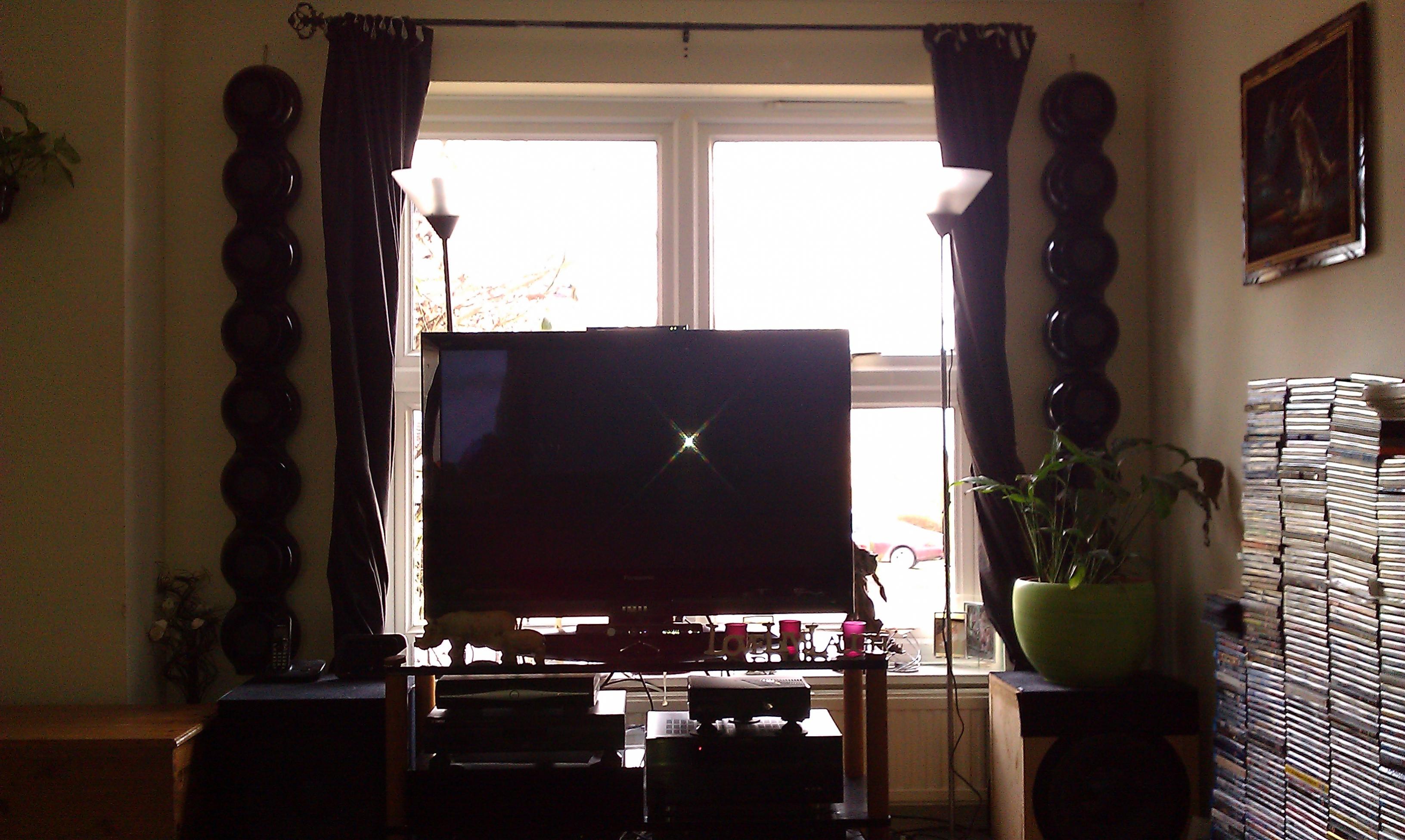

Dome enclosure pics
Here are pics of the 210mm diameter dome enclosures.
These used another version ( internal surround) of the 4.5 inch Neo BMR, still use these at home so happy to let you hear them.
I run them full range, with a wee bit of low end Eq they are flat over 45Hz to 15KHz....In room on the wall they really kick A++!!
Cheers
D

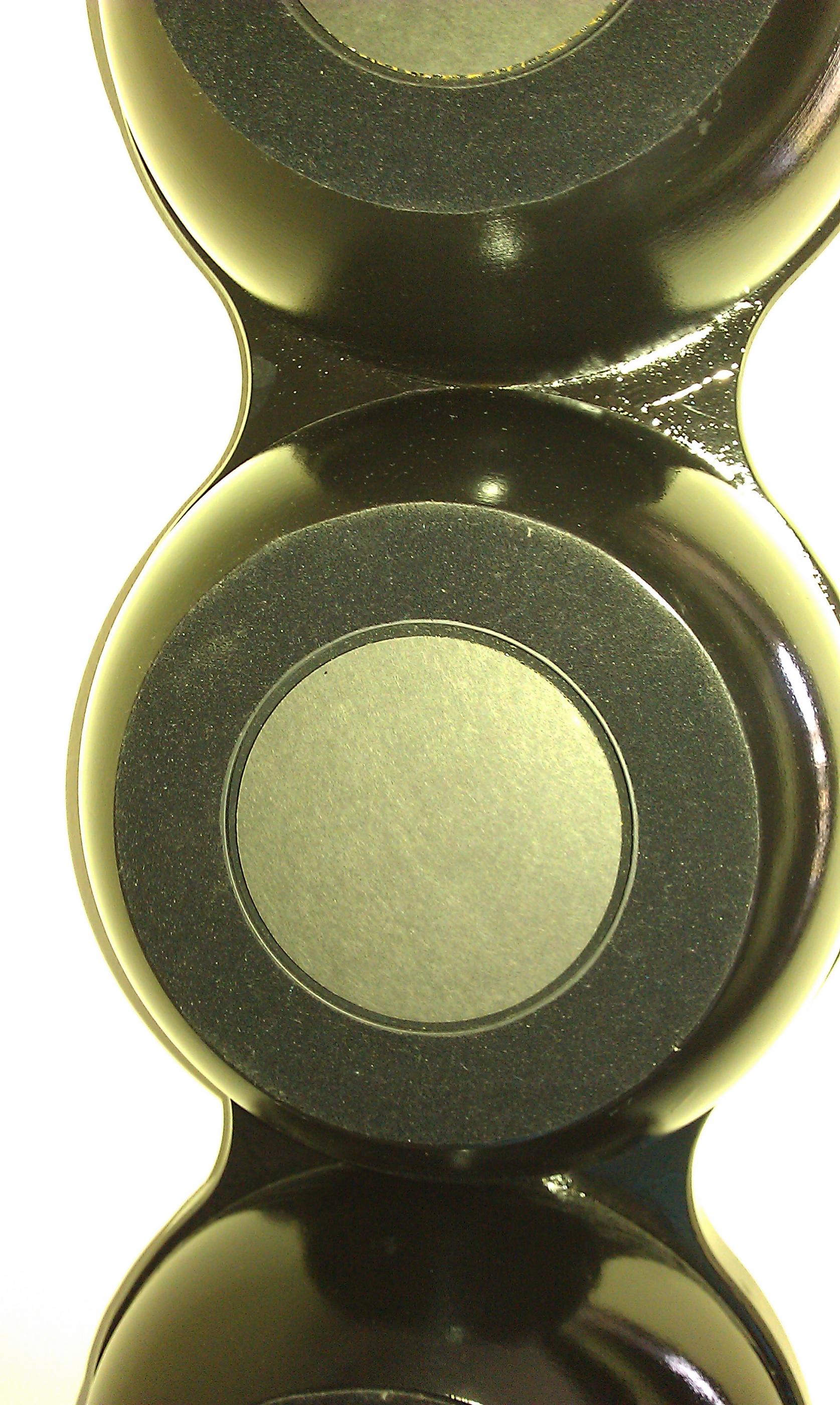

That has to be beaming quite badly by 8k.The 4.5 inch Neo BMR is astonishingly flat over 200Hz to 8KHz, on and off axis....The off axis performance is unmatched.
Cheers
Derek.
No beaming at 8KHz
Hi Face,
No beaming...!
😉Even the off the shelf BMR here has great off axis performance...
http://www.cotswoldsoundsystems.com/specifications/CSS_Specification_Sheet_BMR85DD_N4Y_r1.pdf
With a modified suspension / cone it really flies...Its naturally flat within plus / minus 2dBfrom 150Hz to 9KHz....Over a plus / minus 85 degrees ( approx. 165 degrees coverage with on wall mounting) .... That is both horizontal and vertical by the way!
