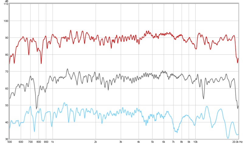

My horn:
The attached graph shows:
Middle (dark grey) 2445J (with replacement diaphragm) on cheap horn.
Top (dark red) 2445J (with replacement diaphragm) on modified horn. I added 3cm to the throat (I stacked and glued rings of 5mm HDF) to smooth the transition between driver and horn flares**. This modest effort is enough to make a clear improvement to the low end.
For both graphs: Crossover 500Hz, 10dB attenuation below 6kHz, no other eq.
Bottom (blue) is a P Audio 4" cone driver on the same horn (this is the stock horn, without the throat addition, so the best comparison is with the middle, grey, graph). Crossover 500Hz, 10dB attenuation below 3kHz, no other eq.
In all cases the horn was on the floor, pointing up, and I was holding the mic 1m over it. Horn is in this link:

My horn:
is 33cm rather than 23cm long
has a customised smooth throat transition
is a simple biradial - no diffraction slot
Also:my drivers have aftermarket diaphragms*
my measuring system is sloppy as

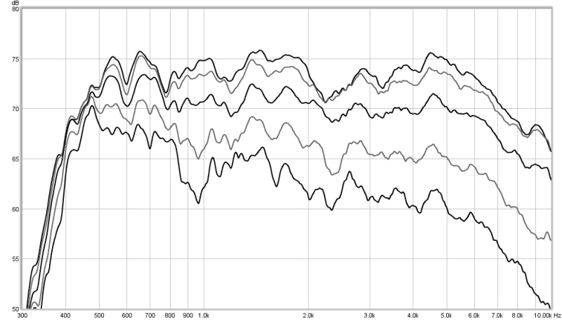

I tried ~10 drivers. The ones that worked best were the current P Audio 4" (SN4-60F) and a no-name 2" salvaged from a bad 5.1 system. Most of what I tried (including the FF105WK, which is very similar in size and specs to the P Audio driver) had a big suckout ~2kHz. I wonder if cone rigidity is the key (the Fostex cone is 2g lighter, presumably less rigid).
These attachments show:
1) the (horizontal) polars for the JBL. Horn and mic were on the floor (hence no highs). It seems to lose pattern control at ~900Hz, which is what "DrWho" estimated on the klipsch thread I linked to earlier (same mouth size on that horn).
So this horn is a little undersized to be perfect for a 700Hz crossover.
If you cover the <900Hz range when looking at the graph, then it looks good, parallel lines - so equalisation to flatten the on-axis response should flatten the response everywhere.
I didn't do verticals, I expect they'd be as DrWho predicted, with the loss of control happening ~1.7kHz. As I understand it, that's what 'pattern flip' is, and what the big 'lips' on Iwata horns are there to address.

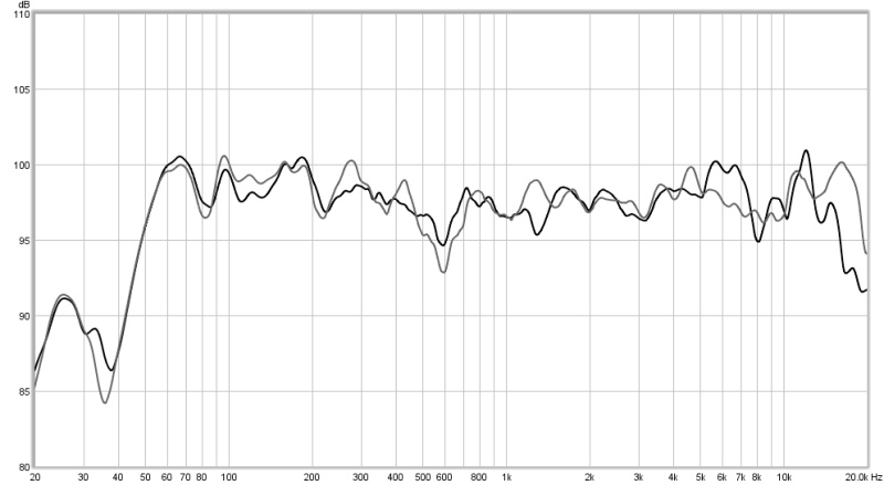

3) The JBL running as a 2-way vs the P Audio running as a 2-way. Both are pretty good. There's no eq on the HF, I just removed the 7kHz lowpass, so this is just a smoothed version of all the HF gunk you see on graph 2. I don't think the >10kHz stuff is that bad. Maybe if I was still in my teens and could hear it better I'd object to it.
The JBL has better HF & more potential to be tweaked to excellence as a 2-way (new diaphragms or good luck with 2nd hand, horn mods, careful setup, eq).
The P Audio is cheaper, and would suit a lower range in a 3-way really well (400-4kHz), if you can live with a really big horn, and size is truly no barrier.

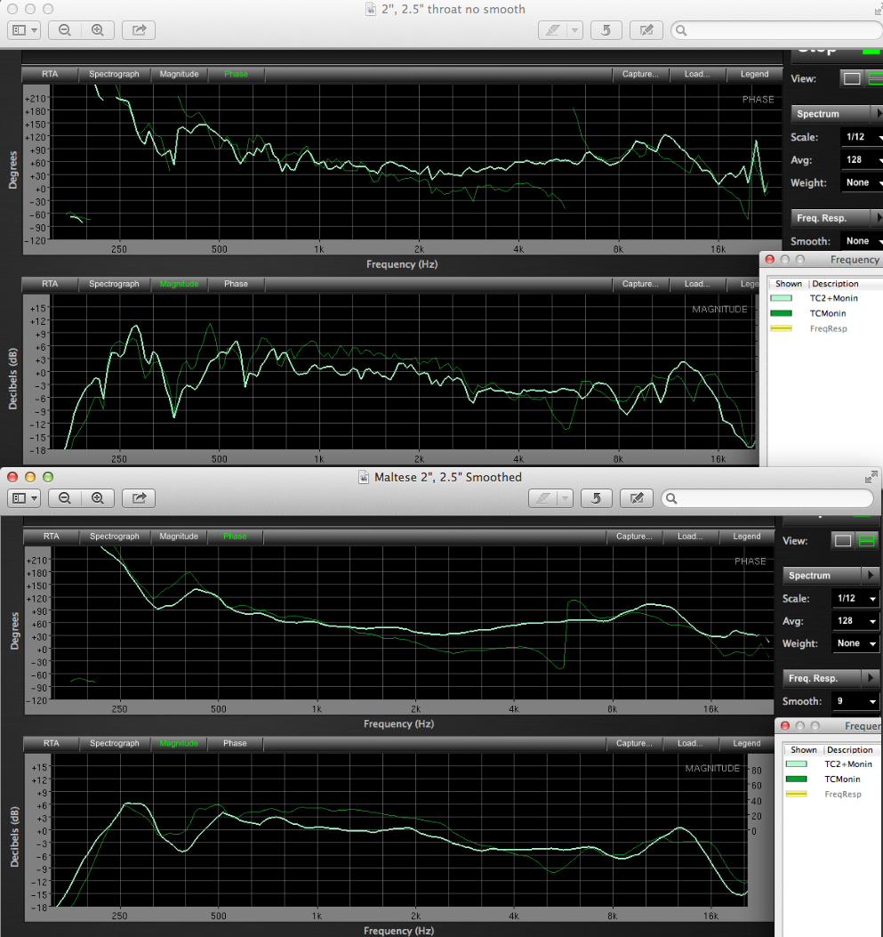

EDIT I think I found the 'secret' to the throat; posted by djk on another forum, quotation follows:
A 2" throat will (normally) have about 62.5° dispersion at 8Khz. A pancake driver (no long snout) will be better than theory predicts if the phase-plug parts come all the way up to the mounting plane of the throat (as they do for the K-69 driver used in the plots). Theory predicts about 31.25° at 16Khz, but the -7dB points on this horn/driver combo are about 60° at 16Khz with the phase-plug geometry. A old-school driver (JBL 2445, etc.) with a long snout (stub) inside the driver will have substantially worse performance above 8Khz or so.
Yes - a P.Audio BM-D750 (Series I or II) with a K-402 horn. It looks like the Series II driver is using ferrofluid, and I haven't heard that one, per se. However, it's a good bet that it was redesigned to correct its most apparent deficiency: 13.7 kHz ringing.
The K-402 throat directly expands from the throat with no transition. The expansion is what most call conical until you reach 12" axially from the throat, then it's tractrix. The angles are 56.6 degrees x 35.3 degrees (half angle to the circular 2" [5 cm] throat entrance). Mouth dimensions are 36 x 21 inches (91.5 x 53 cm) at the intersection with the mouth flange (about 2" [5 cm] all the way around). No other geometries are involved, and the throat is of course the most critical area to get right. I wouldn't change anything.

Actual raw measurements of the real horn measured below, the top graphs with no smoothing applied, the lower charts with smoothing applied, using two different throat sizes, 2" and 2.5". Measurements were taken outdoors, at 2 meters high, two meters distant.
Art

Here's an example of a project that I did recently. This is the distortion and frequency response of a AuraSound whisper on a very simple waveguide that I made for my car. Because it's made for a car, it's far from ideal, and the filter is far from perfect. But despite these shortcomings, I'm still getting almost five octaves of bandwidth out of a $20 driver. Even better, the waveguide raises the efficiency into the 90s, and gives me directivity control too. The blue line is the response of the Aura without a waveguide; the red line is *with* the waveguide. You can see it raises the output by over fifteen decibels in the midrange, which is how a $20 computer speaker can compete with a $100 compression driver.
That measurement was from one of my posts over at Diymobileaudio, take a look at some of my threads for more data
