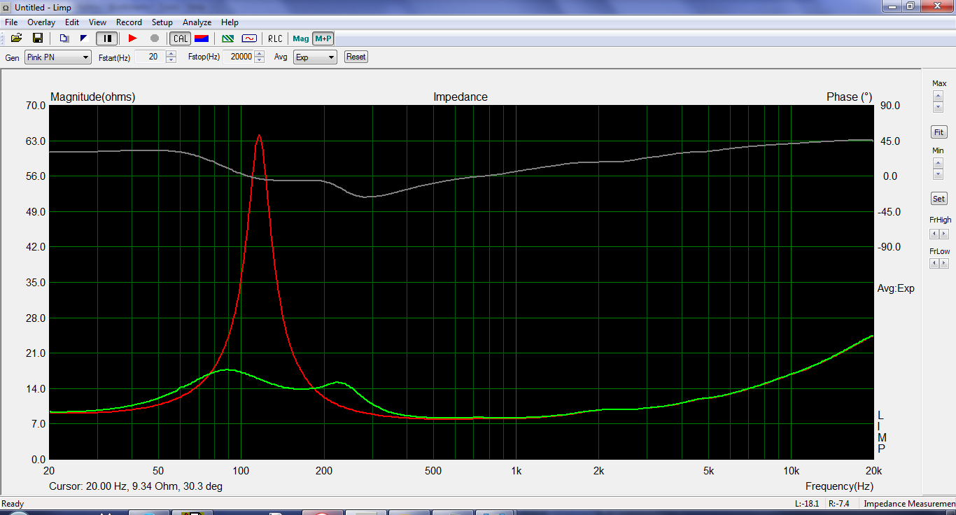

Here something I did just yesterday. Fostex FF85WK in a 3" diameter tube, 12" long, stuffed with 24g of polyfill:
Should facilitate a fairly low Xover as far as impedance interaction goes. Simply make the tube long enough to exit the back of the enclosure, but there is a minimum length to respect. You get some bracing as a bonus. 🙂
Thread about this
