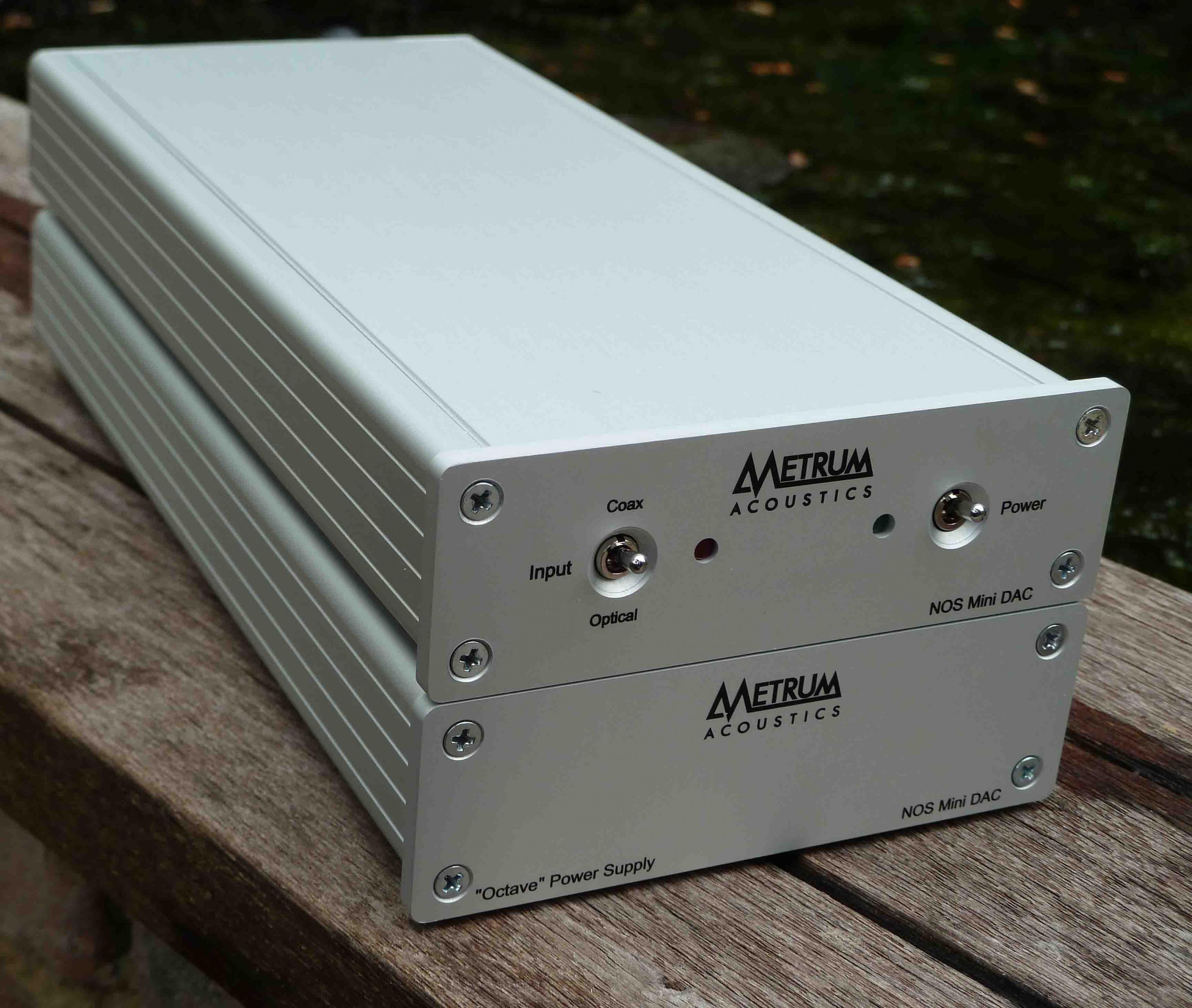

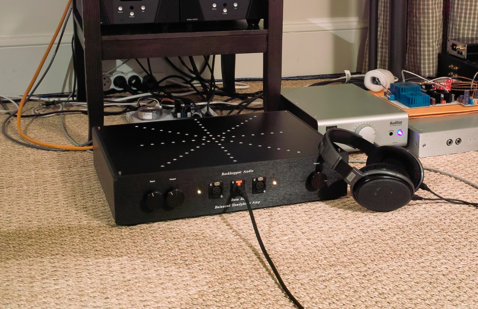

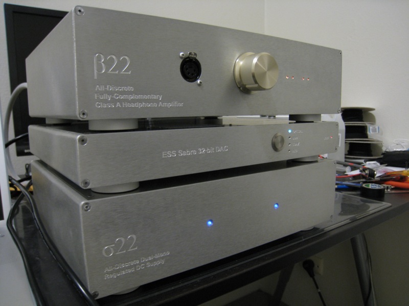

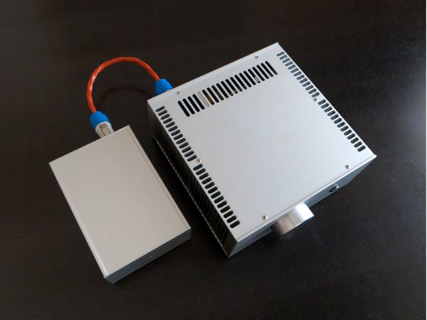

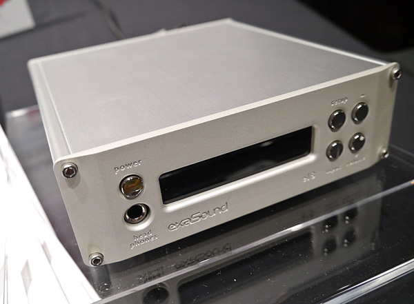

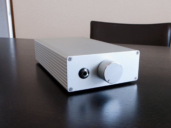

Regarding enclosure, I have tried Modushop, and find the finish sub-par (tolerances are rough, anodizing cheap, etc.) Prices are good for a big amplifier case, but for small enclosures, some research has led me to prefer the following:
Desktop Enclosures available from Context Engineering
Desk Top Enclosures (same products as above it seems)
ALMINIUM ENCLOSURE | TAKACHI ENCLOSURE
Hammond Mfg. - Small Enclosure Index
Lansing Instrument Enclosures E Style Overview
Box Enclosures - Product
Here are some examples of what is achievable with some of those cabinets:
