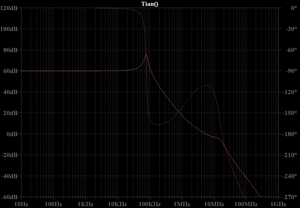

Cordell HEC Return Ratio
OK. here is the Return Ratio (A.K.A Loop Gain), at the OPS of the Cordell HEC amplifier.
At least, it's a macro-model-front-end version from JCX, that I have modified to use semiconductor models from Cordell_Models.
I made the modification because the JAES article did not have details of semiconductor types so I chose convenient ones.
I can't be sure the result is completely accurate but I think it shows the correct type of behaviour.
The low frequency peak has a scary look but is harmless, just like the similar peak in TPC.
In fact the entire plot looks very similar to TPC, and HEC can be considered as a TPC scheme from the perspective of the OPS.
The OPS is the dominant source of distortion in a well done class B+ amplifier so HEC is then, essentially, another TPC scheme.
Note that the peak means the Return Ratio starts to climb from 20 kHz.
This extra feedback is perfectly placed to hammer the distorted harmonics of a 20 kHz signal. No wonder this amp did well in 20 kHz THD tests.
Note also that the peak in the phase curve happens essentially perfectly at the ULGF, as one would want for stability.
There may be a little luck in there, I haven't simulated the front end details and the models are only reasonable guesses, but I assume Bob tweaked the amp based on real world tests.

Funny to see that both Bob's and other's plots show this 'step-up' in gain just after the gain passed below unity. You can get to smooth that out by adding capacitance from the collectors of the driver transistors (that drive the mosfets) to their bases. It comes at the cost of phase margin; the phase peak lowers a bit likewise.
Still, I somehow do not trust my loop gain plots because of contrary results between plots and simulations.
...I can see that with output inductor it would be stable...
It does not need an output inductor to be stable, it already is stable.
Of course, an output inductor will help it stay stable with a capacitive load.
This is not a coincidence, it's called a Bode Step and helps the stability of the amp.

No! We are suspicious of bumps in the input-to-output response of the amplifier, often called the closed loop response.
That name can confuse because people assume we want the response of the loop itself to be smooth.
But the optimum "loop gain", better called Return Ratio, is not a simple line!
Bode showed this in his book back in 1940 (I don't want to be repetitious but I really recommend it).
This is similar to my comment to Paul that his concern about the peak is also mostly unwarranted.
Exactly. We put the step in precisely to raise the phase peak and improve the PM.
Perhaps you have not checked at the correct points. Even Dr Middlebrook says this is an easy mistake to make, and even some of the experts in DIYAudio have done it.
Post the contrary results and we can check them and try to understand better.
Best wishes
David
Yeah I specifically meant with a capacitive load. The plot indeed looks like a TPC compensated network and found an input inductor to be necessary to deal with pure capacitive loads.It does not need an output inductor to be stable, it already is stable.
Yeah I have been using this as a tuning mechanism to trade between PM/GM. However, if those caps I spoke of are too low, those bumps below UG may peak back above UG. Is that not disturbing? In spectra plots this comes back as a lot of harmonics 'activity' around the ULGFThis is not a coincidence, it's called a Bode Step and helps the stability of the amp.
This might be well possible. I'm still using the Tian probe in the global feedback loop as demonstrated by LTspice's demo file, but maybe with the HEC I have to relocate the probe.Perhaps you have not checked at the correct points. Even Dr Middlebrook says this is an easy mistake to make, and even some of the experts in DIYAudio have done it.
Best wishes
David
I'll take your advice and see if I can work myself through Bode's book. I fear it will only give more questions lol.
P.S. I fear posting my full schematic as it is a bit different from the mold and my point is getting it to work and build a working prototype, both to create a wire with gain and for the technical challenge / achievement, much like mcduk99 is doing I want to prove my VAS topology does work in real (bread-board prototype already does), but also want this to be the best amp I could possibly achieve myself. Here, 'best' means as in specs performance. As long as it fulfills the "wire-with-gain", then I'll be satisfied sound wise.
- Middlebrook "GFT" probe?
