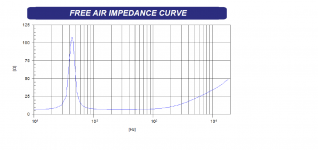

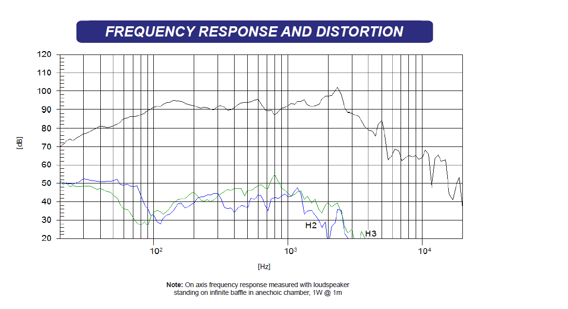

Attached are the frequency and impedance plots from the manufacturer. The rising you mention is the one up to 150Hz or thereabouts, right?
"...that the goal of the box is to simply offset that slope by loading or boosting the bass response in the lower frequencies.

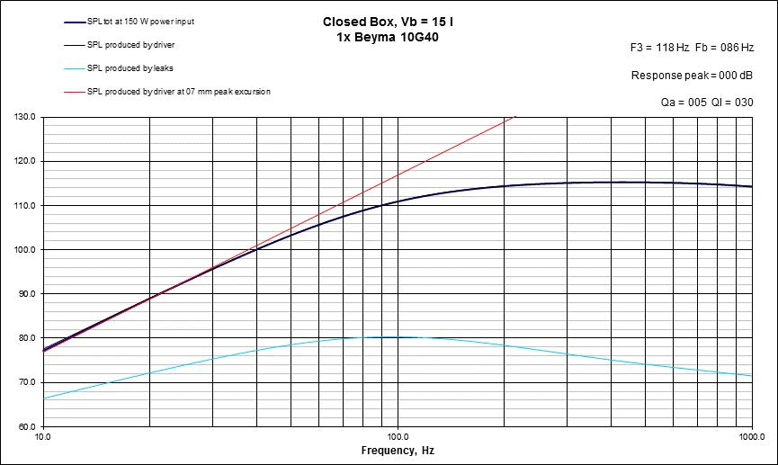

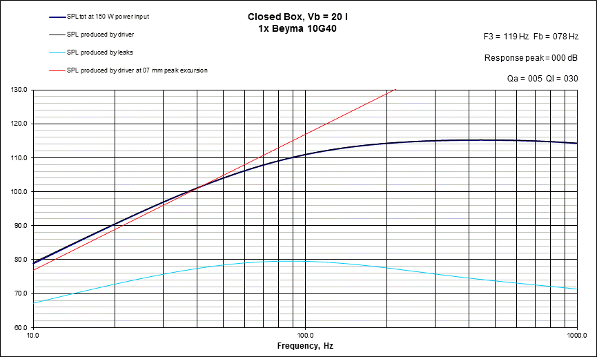

I know I want to build a sealed box, and I'm using UniBox, which is similar to WinISD I believe. Atttached are three plots of a single driver in a sealed box, heavy filling, driven at 150W even though I highly doubt I'll ever go that high.
6.3 liter box has Qtc of 0.709 and Fb of 122 Hz
15 liter box has Qtc of 0.53 and Fb of 86 Hz
20 liter box has Qtc of 0.49 and Fb of 78 Hz
What is the peak generated by the box you are referring to? The max SPL rolls in and off very gently.
I was thinking a larger box, such as the 20 liter, generates higher SPL at lower frequency (e.g. 70Hz) at a given power (150W). Since I'll use DSP to trim response, my idea was to start at 70Hz and make the response flat from there at the SPL achieved at 70Hz. I can do that with whatever size box, but I guess I was maximizing SPL at a given power usage. What you are saying is it will sound better with a smaller box with Qtc closer to 0.707, right?

Oh okay. I see. I thought it was a more of a mid driver like my RCF L10-750, which has a lower Qts and 100db effieciency vs the Beyma, which is 95 and more "woofer". So it doesn't exhibit the rising response I was mentioning. I would start with the recommended ported enclosure of 1.5 cuft, with/without port, and go from there.
Interesting: 1.5 cu.ft equals 42.5 liters, which is pretty close to the 40 liters I started with.
Of course USSpeaker suggests a ported 1.5 cu.ft enclosure vs. mine that is sealed.
What next? 🙂

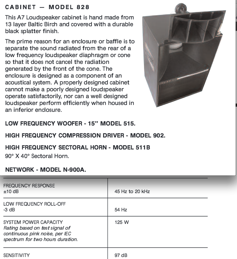

An Altec A7 type horn does exactly that in addressing a rising response in 80-500hz range, if you have the room of course. (But you gain like 10db in efficiency, and you don't need the massive back enclosure as you're running subs.
The model 828 A7 cabinet was only rated as 97 dB 1 watt one meter.
The small A7 mid-bass horn gives roughly a 3 dB boost in the 200-600 range, the huge box and high bass reflex tuning fills in the bass in 60-80 Hz range, but still results in a "stepped" response, the mid higher than the bass.
