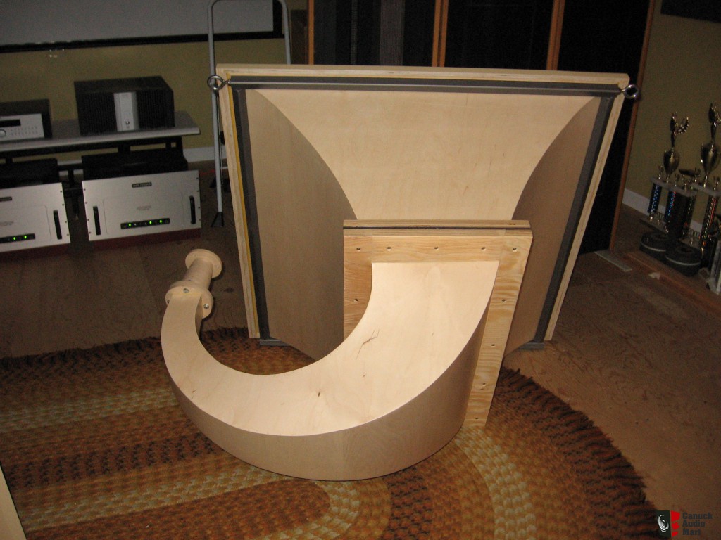

We are discussing horns on another thread..
Hope you have lots of room to spare, they can get rather large. This one is the SATO horn, built by a gentleman from Japan, hence the name. His low end cutoff is 280 Hz. 200 hz will be another factor larger.
________________________________________________________Rick........

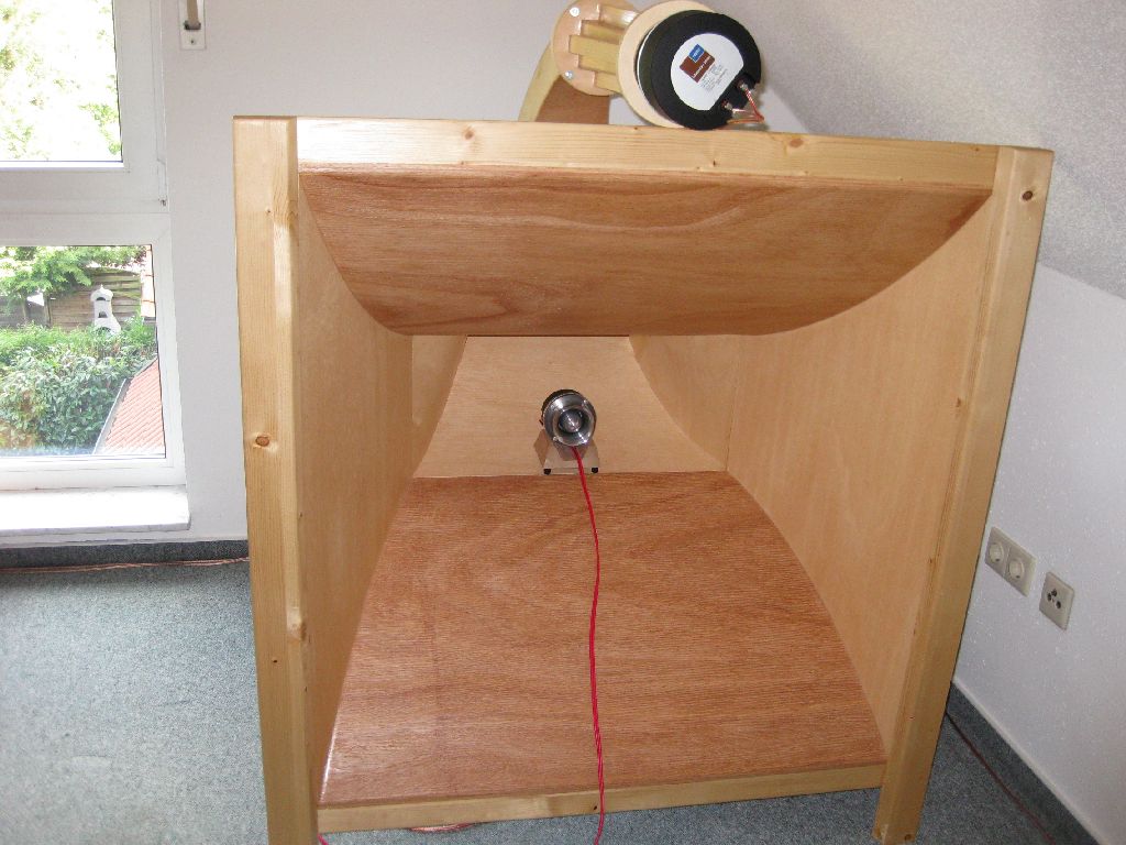

Hi unaHm,
I too am thinking about an all horn loudspeaker around a cheap phenolic midrange driver. Since these type of drivers seem to be the only way to close the +- 500 - 5.000 Hz range on a budget.
50 - 500 Hz 8 or 10 inch, in a folded frontloaded horn Klipsch / Vitavox Thunderbolt style.
500 - 4.500 Hz Selenium D250X on a big biridial ABS horn 18" w x 10" h x 12 " deep.
4.500 Hz -> "Denovo DNA 150" type neodymium driver on a small biradial horn. Eminence EM 200 ish.
