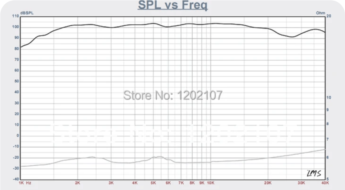

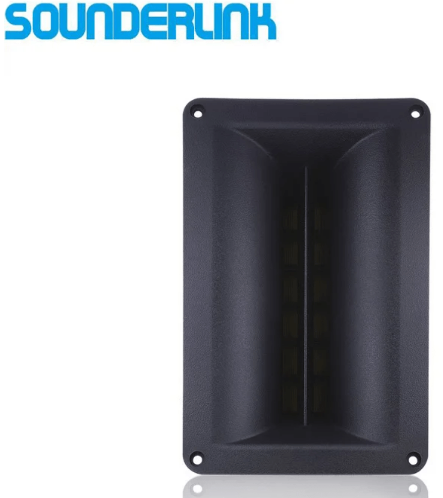

I keep coming back to this monster:
https://www.aliexpress.com/item/1824798165.html
$360 for two of them shipped to me here in Mexico. Horn loaded (105db sensitivity), easily crossed over at 1200 and a very respectable response (if the graph can be believed).
Seriously thinking of taking the chance on this and reporting back for those who may be interested. This looks like a very capable driver for pro-audio applications.
Availability of the Bliesma T34A-4 (especially here in Mexico) is not good. Most sites show it out of stock.
The Dayton AMTPRO-4 seems known to be less-than-stellar FR-wise and falls short around 18k.

Looks like it's down about 20 dB from 2 kHz to 1 kHz though.this monster
Without seeing distortion measurements, it's hard to judge tweeter suitability for low cross points.
Using this driver in MMT setup, crossed around 2k... I can get that driver mounted close enough that the only distance which matters is center of the top mid and basically... the edge of this ribbon driver, no?
The midbass drivers should not start beaming until around 2800, so pushing the xover up as far as 2200 or 2400 would be fine I imagine.

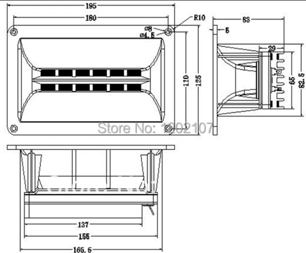

I am assuming the vertical center of a ribbon driver does not matter since it is a line source - correct?
Or am I sweating too much over the issues of potential beaming and driver spacing? lol
The tweeter is comparable in height to the mids so it will beam as much as they do, in that dimension, in theory. What is it about beaming that concerns you?

Yes. What I'm trying to say is that beaming isn't a good or bad thing. When you want it, you want it and when you don't, you don't. Eg waveguides beam deliberately, and they are popular.
You have chosen a ribbon. They will produce an asymmetric radiation pattern until low enough in frequency that they lose their line status and look more like a point. They will then be more axisymmetric and they will be wide.
