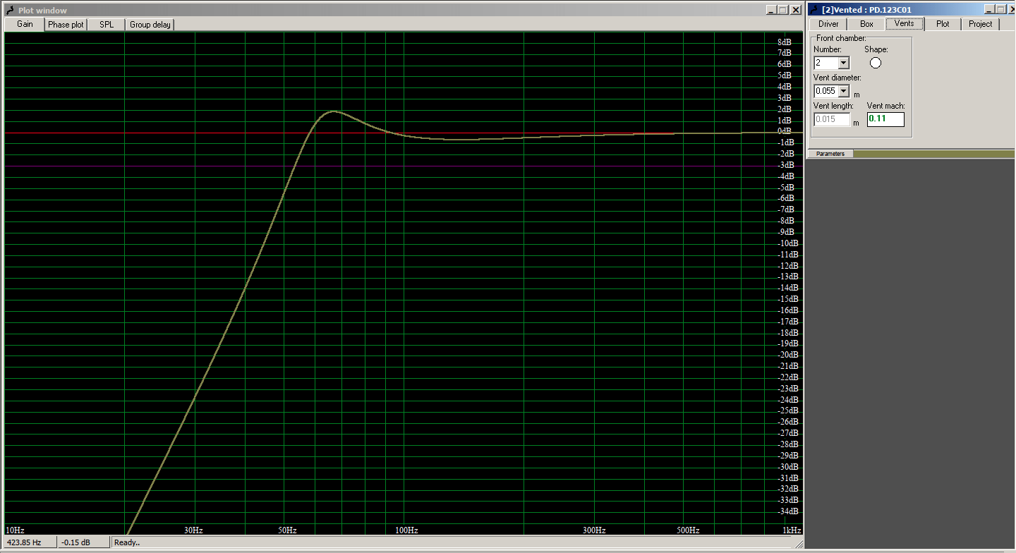

Finally after much faffing around I have winISD on my mac! So here is my first ever, extremely basic attempt at modelling! Hurray
Thanks tommus your words have confirmed the model, 2 vents at 55mm = 15mm depth (my front baffle will be 15mm) - i was going to confirm whether baffle depth counts as port. Port mach 0.11 is to do with air through the port not chuffing right, seem to be in the clear there.

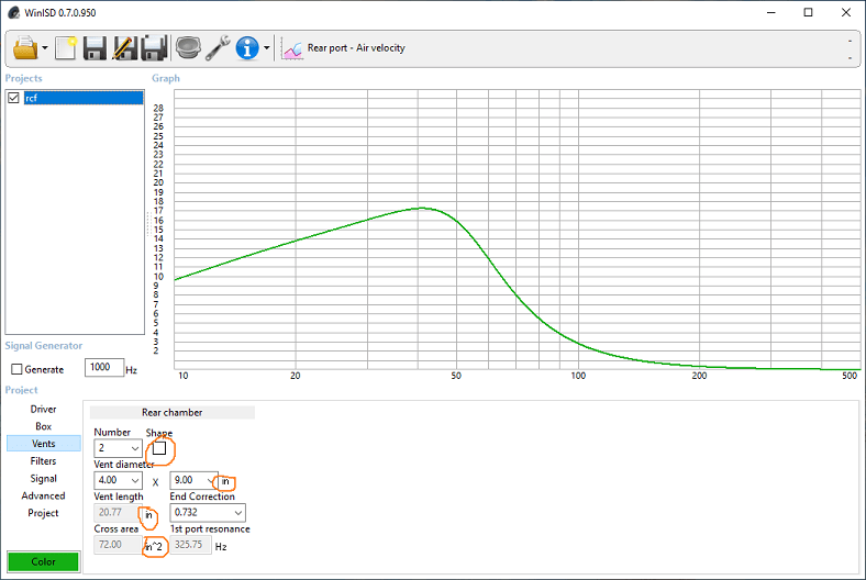

Also note that many things in the program can be changed on the fly just by clicking on them. Examples of this I have circled below, change from circular ports to square/rectangular by clicking on the shape, change the units displayed in a window by clicking on it. Also note that I have previously set the input power in the Signal tab to a value that produces xmax, then the port sizes can be modeled to keep vent airspeed to an acceptable level.

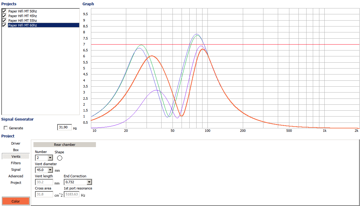

So its probably nitpicking but ive crunched some numbers anyway

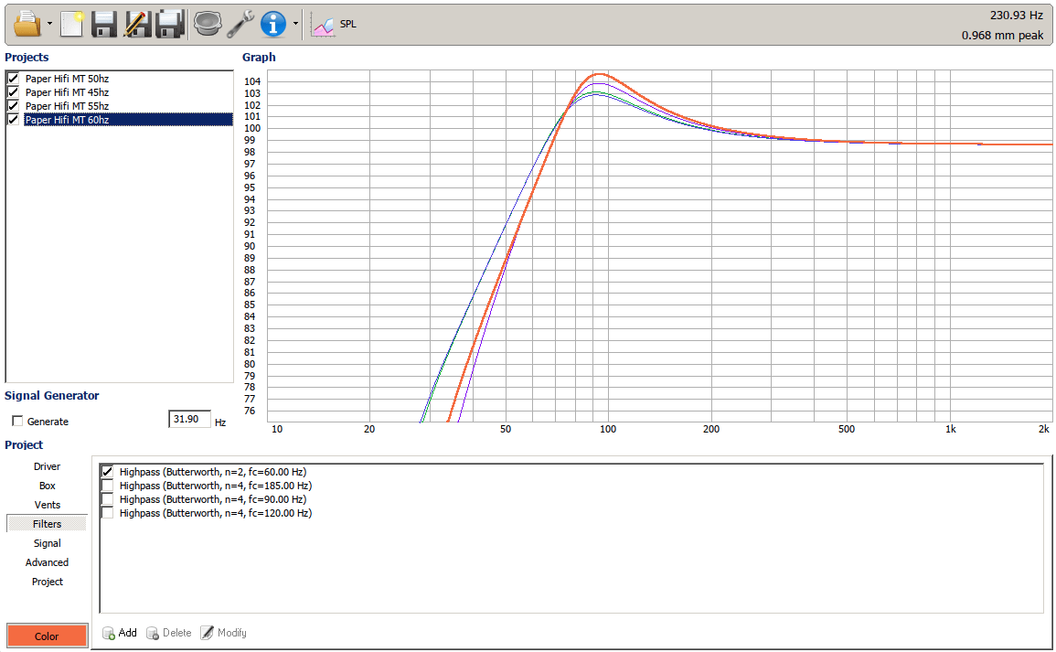

I have modelled 45/50/55/60hz enclosure tunings and the lower tunings exceed Xmax 70-90hz at 300w, so that rules them out i guess. Higher tuning frequencies give higher port resonances (safely away from woofer range) and less change of exceeding Xmax, but also a big bump around 100hz (+6.5db for a 60hz enclosure) which i suppose I would EQ out?
LMK if ive missed anything stoopid or ill start doing my drawings of the boxes... thanks all 🙂
all with same filter applied @ 60hz

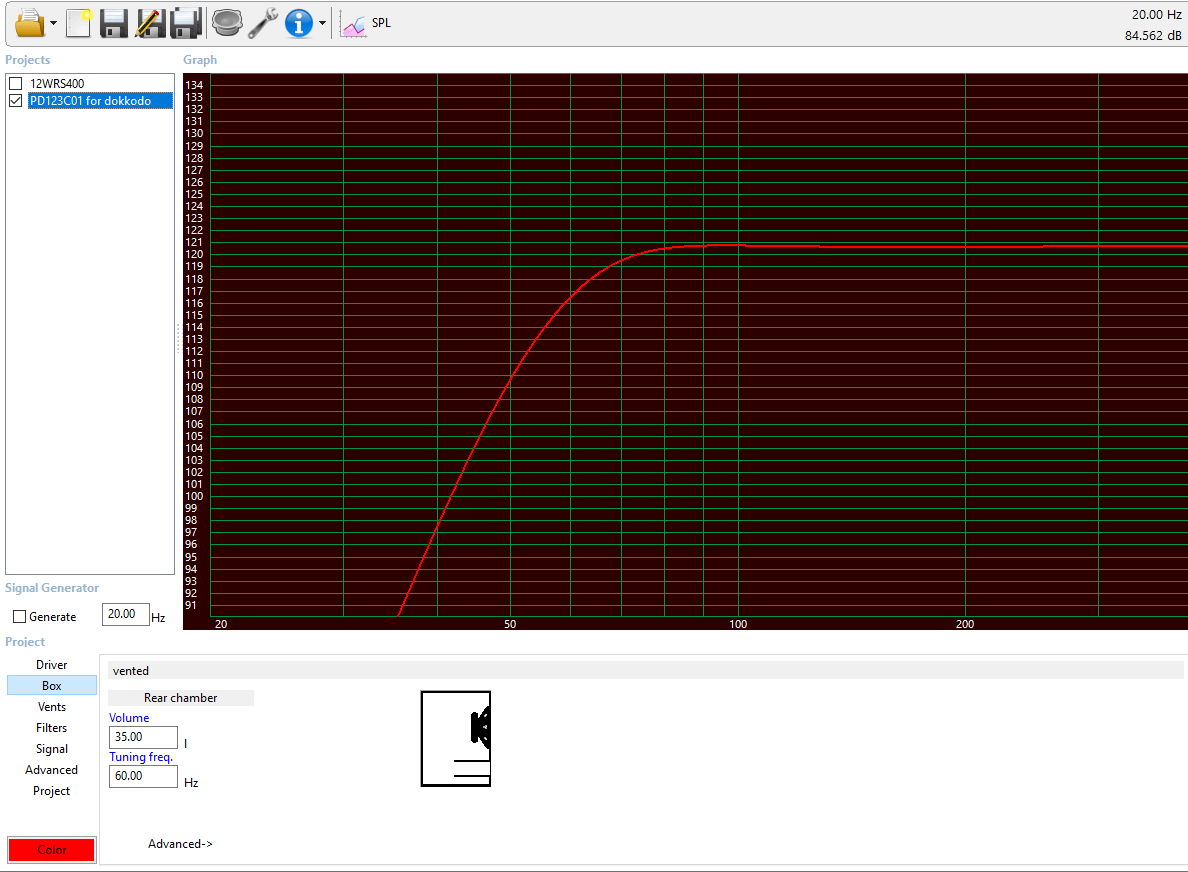

Here's my effort in 35l tuned to 60Hz @ 350W with no filters - you can see it doesn't even hit the 7mm of the manufacturer's Xmax in-band:
SPL:

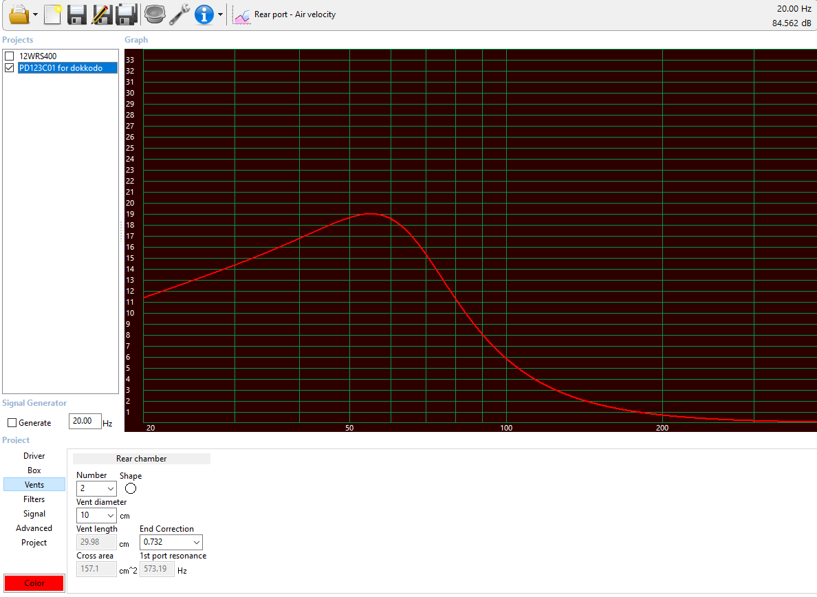

Airspeed with two 10cm diameter vents - this would be no problem after an HPF is put in place - 24dB Butterworth @ 50Hz would be ideal here IMO.:
I'm also attaching my WinISD project file in the zip in case you want to compare with yours to see how the differences have arisen.
