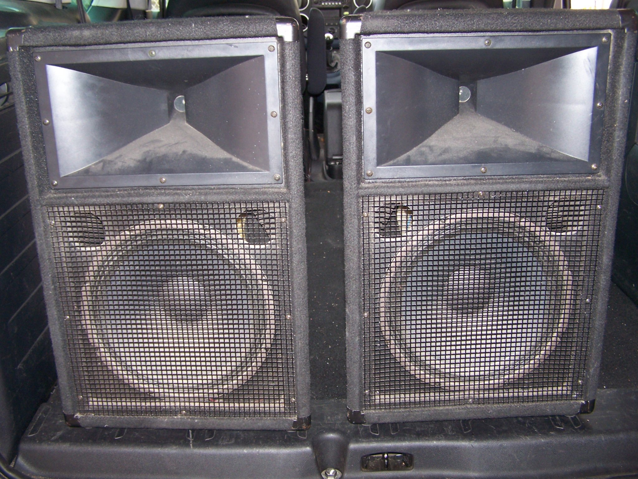

Hi all, looking to build some mid tops to go with my PA rig, 2 B&C sub15 mod kickers and a dual 15" ppsl sub - i have lying around a pair of PD.123C01 and B&Cde750 2" CD drivers so just need something to base a design on for some reflex tops. Had some yamaha club 12"s which i liked before and was thinking to more or less copy the design but without modelling and measurement knowledge not sure how to mod to best serve the PD drivers I have. Help appreciated!
Since those are going to be used as a mid driver in the two way box no porting is needed. A solid and braced box of convenient size for the components and portability will work.

Ah thanks Mike! Ok well in that case I’ll probably copy the Yamaha design more or less. I’m a joiner by trade and have a workshop so making the boxes is the easy bit it’s the science I’ve not wrapped my head around yet.
It would be nice perhaps to have the option of having them play low-ish for applications when they will cross straight to the sub or have no LF backup at all so if I do want to maximise their lower potential, or at least not limit it, would it be wise to vent or port the boxes in that case?

If your crossing into them in the 80hz to 100hz range sealed will work better. Now if you would ever want to run
them full range two way then ported would be better.
As just mentioned a double 12 two inch is a classic mid hi box just because that combination works well.
You'll just have a lot of headroom on the two inch driver.
Just a quick note that I'd always go ported for PA use. Ventilation is important for keeping the drivers cool.

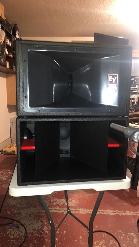

The Paraflex 1x12 looks like a neat design but I don't think you will be able to mount the CD coaxially in front of the 12... you will have to stack it on top due to the size of horn needed to load the driver down to around 800hz. This pic from the SoundForums thread seems to suggest at least one person has done just that. Of course if the other option is going to be a reflex design then there is no real downside to this.

Yes I’m happy to load the horn above, nice to gain a bit of extra height too and I’ve seen people tilt the recessed baton the horn fixes to to angle it slightly down as well which seemed smart. I also accidentally bought some 1" horn flares annoyingly, got a job lot of 3 pairs cheap and the larger pair were so large I assumed (n00b error) that theyd be for a large CD, but alas no. I have found a pair of JBL 2380A's that I will get for my de750's.
So im just now a little torn now what to do with the 12" section... but I suppose the Para 1x12" (assuming my drivers are appropriate - ive got the question pending on the FB group...) would get more SPL and keep up better with the horns. Bit more unwieldy in terms of size/shape/mounting but thats an ok trade off for better sound.
I guess I can let the deciding factor be whether or not the PD drivers work for the para design.

I was thinking to more or less copy my old yamaha S112iv's but they just have two holes in the front face so no port length to speak of, can I just do that....?
