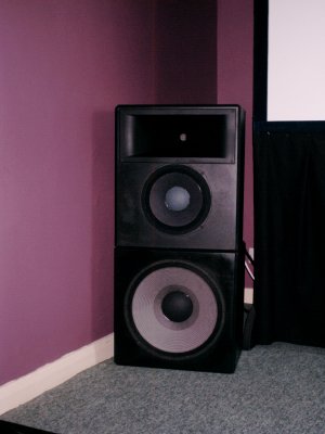

Lots of people seem to think the 'kick' in a system is from 60Hz - 200 / 300Hz.
To get decent output there I've used 15" pro drivers in sealed enclosures to good effect - the right ones will also fit in perfect with a home theater set up (xo @ 80Hz)
Try modelling the JBL 2226 driver or the Beyma LX60 15" driver for an example.
Here's my old setup:
Dynamics weren't a problem.
Rob.
