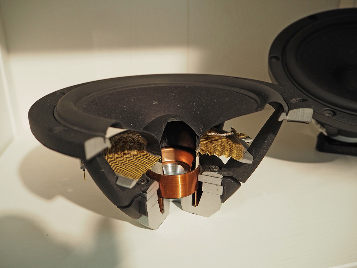

Satori MR16P - 4ohm.
SD is only 119cm.
Mms = 11.2grams.
A measured glue bead around the rear cone has been added to smooth SPL.
A ~2kHz crossover has some hearing advantages, and a smooth controlled directivity curve to a normal dome tweeter is easy to achieve.
