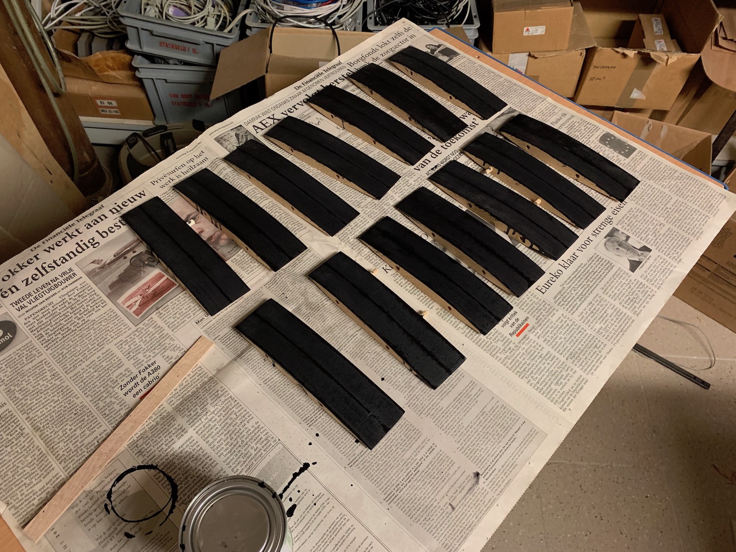

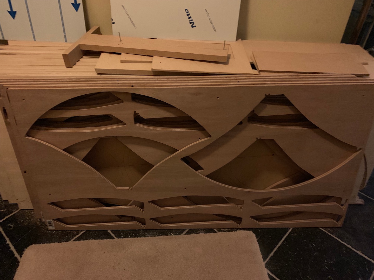

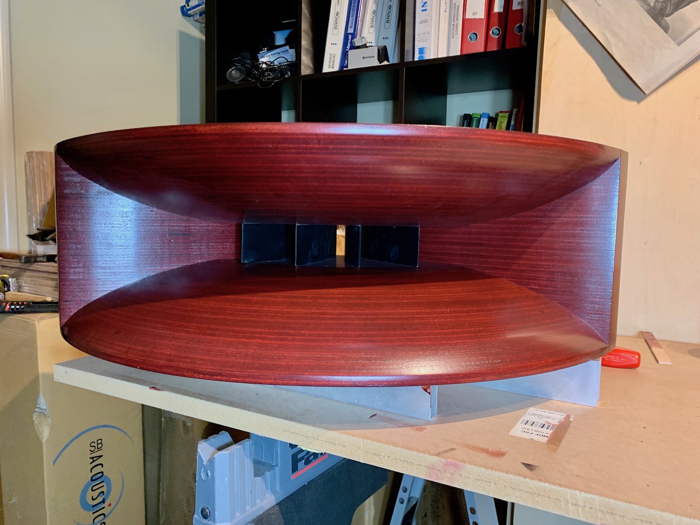

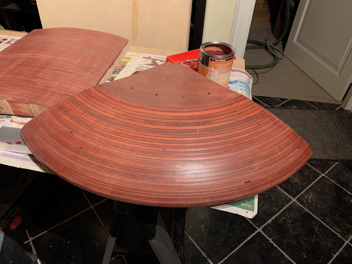

Here are some pictures of my A-290 Uchi horn I build.

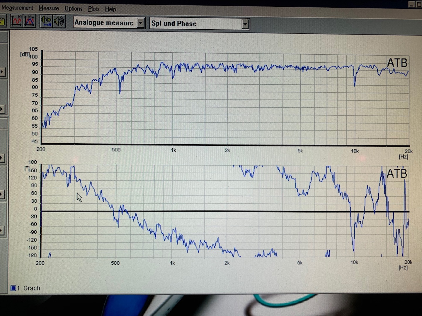

And the measurement with a JBL 2445 and passive EQ.
For SPL you have to ad 20dB because my measurement mic cannot deal with that high SPL
Rob

That uchi horn looks great, the measurements look really smooth too.. It looks like it should sit above a pair of boutique pro 15's in vented boxes..

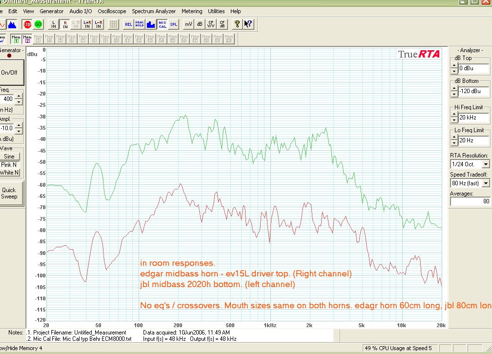

I've been going through my old files and found this measurement of the evm horn vs the jbl horn I built so I can say that the plot I posted earlier of the evm horn would have been at 1m groundplane outside.
Rob.
