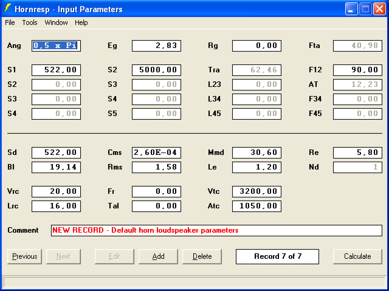

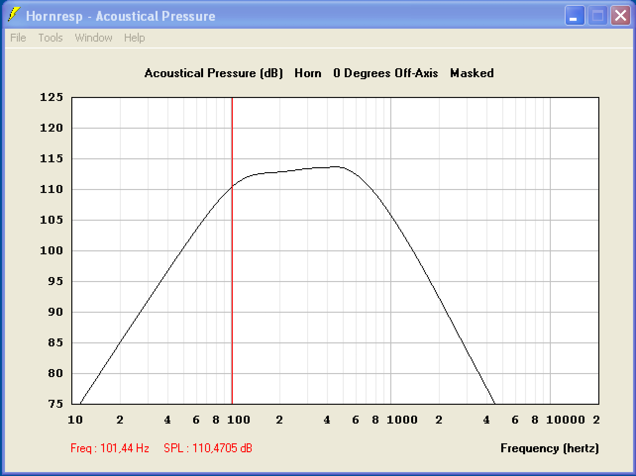

I simulated a tractrix horn with B&C 12PE32.
That simulate really good also.
What do you think about this design?

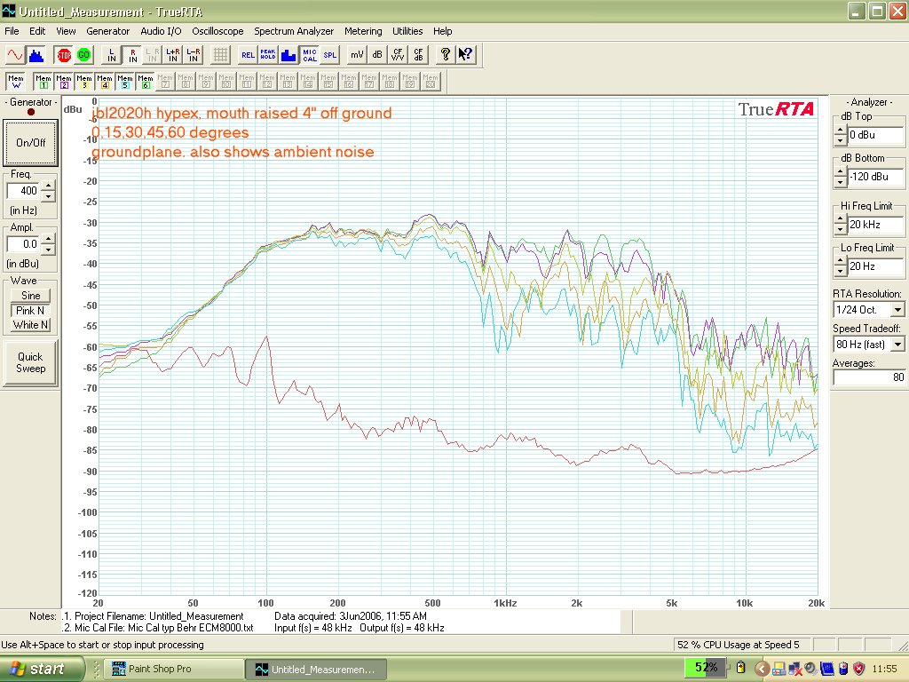

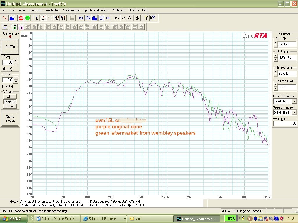

I have a pair of 80Hz horns similar to the Edgar horns using Electrovoice EVM 15L drivers. I'm pretty sure they have a throat around 500cm2. If you are using a 12" driver then I think the throat can be smaller. When I prototyped these horns they ended up around 60cm long. I also built a prototype JBL 2020H 12" driver horn that worked out around 80cm long with a smaller throat suited to the smaller driver.

@ RobWells - that's a fabulous graph with the EV15L horn
Rob what was the Mic distance to mouth from those measurements?
The JBL horn was outside measured groundplane at 1m.
The EVM I'm not sure possibly in room at seating.
These were built around 13 years ago and I'm having trouble finding the off axis measurements for the EVM horn. Will measure again once the weather gets better.

Ang 0,5 x pi seems too optimistic. Or will you really place horn mouth in corner?..
No gonna change that Thanks
