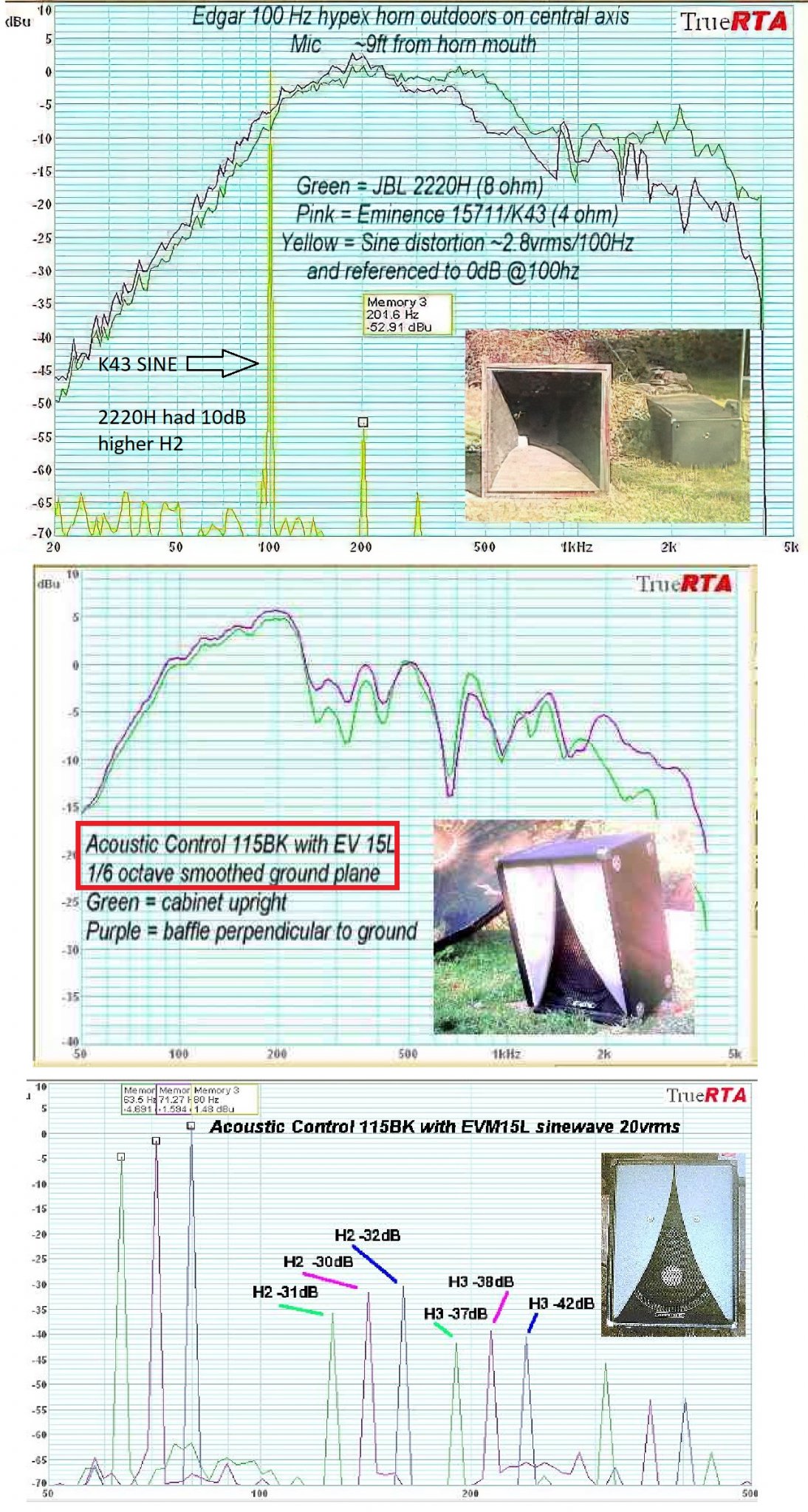

OK - skip folding - straight it is. Is there a big advantage for horns with bent sides compared to one with built with flat sides. Only straight lines seem to much easier to build ;-)
what kind of amplifier will it use? IF I were running 30-300 watts per side I might take a cut in midrange efficiency and go with a little Karlson such as the one produced by like five (?) companies
A 115BK would be 27" tall by 20.5" wide by 13.5" deep without the baffle inset
what might you use below the 100Hz midbass?

I have 2 subs as well as alternatively corner (floor-ceiling) line sources (18pcs 4" in each).
I will suspect that a mid-bass horn will be much more potent than both alternatives but it is OK - the capacity of both my options are OK for my room and needs (24 sqm).
For this reason I might get away with some EQ of the mid-bass horn to reach the BW desired without getting into trouble... a couple of dB or 4 maybe? 🙂
So why do it of I have the described options... the subs only do 2-300 Hz. The line sources are problematic in the 200-700 - they get to "big" so to say...
