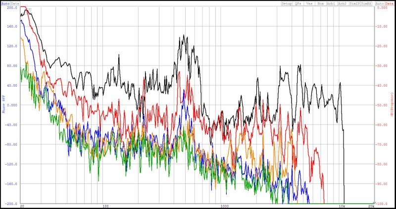

Does anyone know the cause of the distortion spike in the 10P and 12P drivers around 500Hz or so? 😕
I've attached an example nicked from Bob Brines spike showing what seems to be 15% distortion at 500Hz with the Alpair 12P drivers.
This seems to be absent in the metal drivers...

But back to mid-band distortion, is this due to some sort of break-up mode as hinted at by the Beyma paper? Presumably metal, being stiffer (and hopefully more so in the Pluvia drivers 😀 ) won't suffer from this. At least it seems that way looking at Bob Brines' THD plots.
That distortion peak is on CHN70 also. It might have something to do with the mechanical handoff from main pistonic mode to drum head membrane distributed complex modes used to get the HF's. There is perhaps some noise from the bending of the paper membrane and it's not really harmonic noise.
Hmm... Looking at Brines' THD plots, there does seem to be a little spike of distortion on the metal drivers in the same region, but much lower in amplitude and width, thankfully.

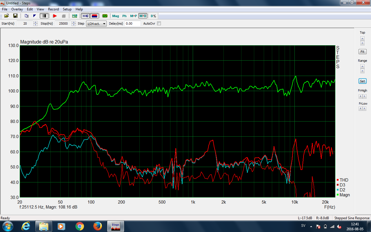

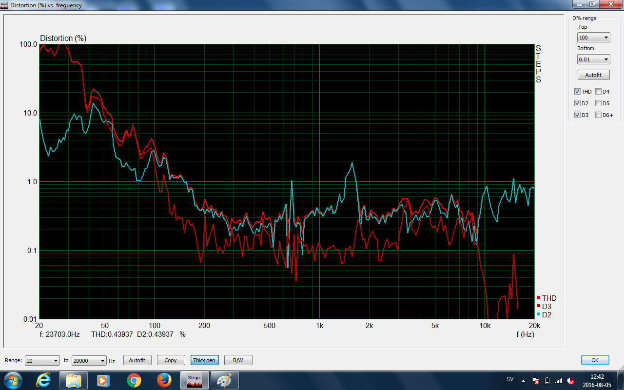

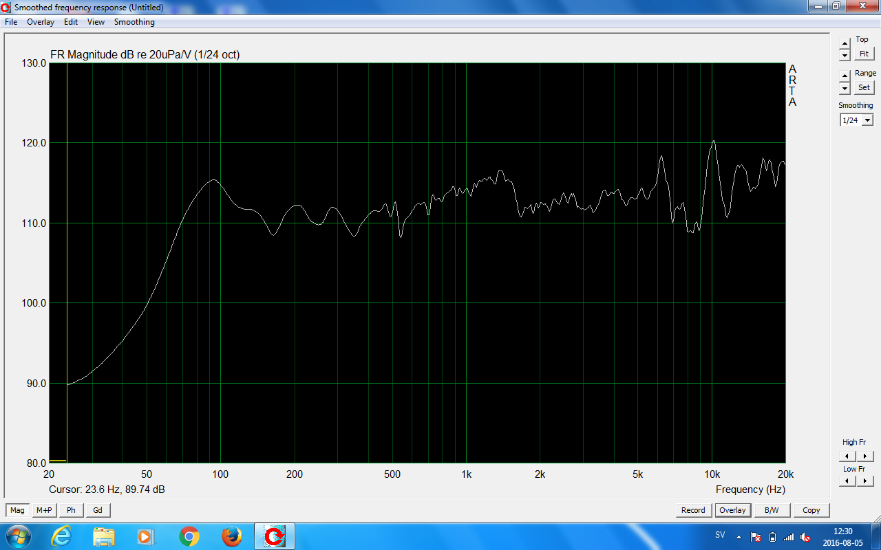

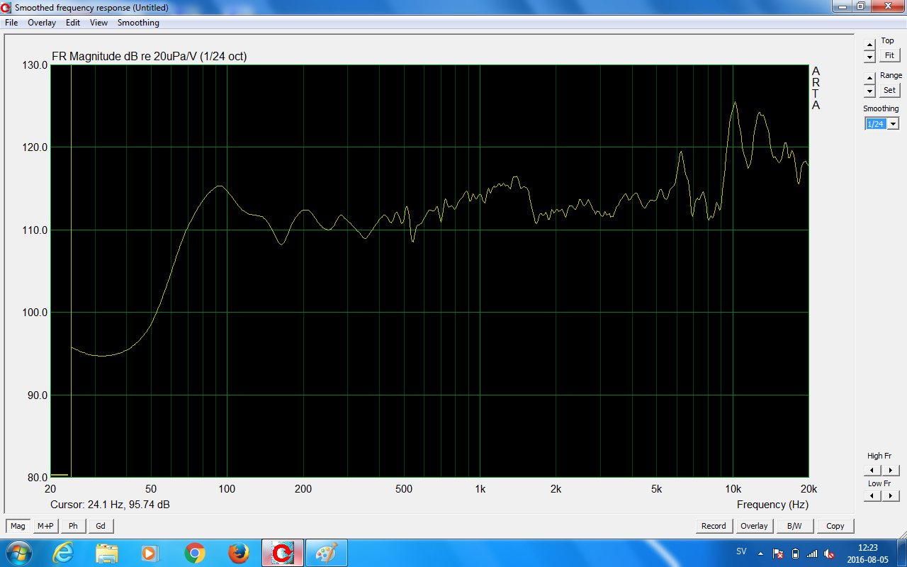

I have also measured a peak in distortion in my alpair 7.3 equiped frugelhorns (mk3)
(ECM8000/ focusrite 2i2 / F1J i.e 3rd order bottoming out at 0.1% is the amp, measurement level is 2.82V @ 1kHz, there is allso a notch filter, measurements performed indoor with 20cm mic distance)
