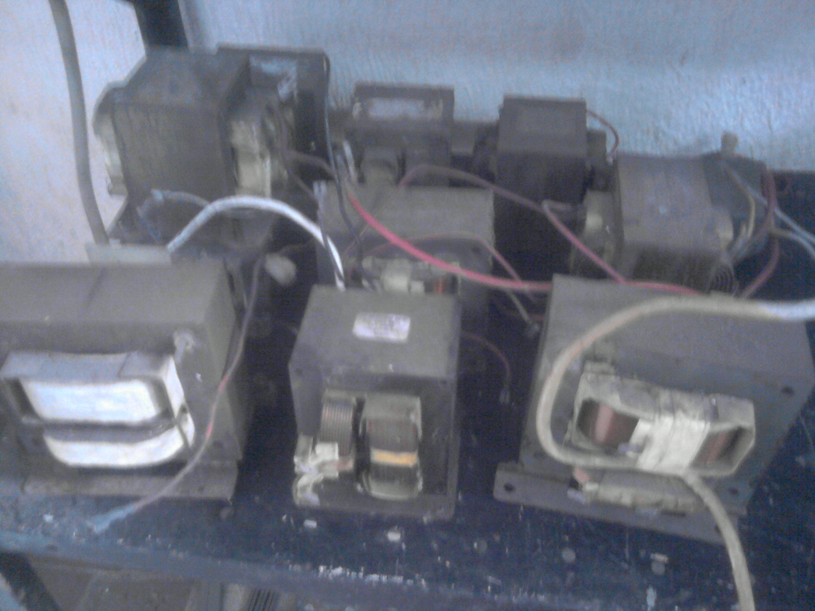

It's possible to use microwave transformers to tube amps? Of course that is needed rewinding the secondary, unless that I try to make a amp that need 2.5kV.
I already read about someone that used microwave transformers to obtain 12V at high currents, like 60, 50A... But my question is for tube amps...
I have a few MOTs here, and thats why I'm asking.

Sure, it's possible, but probably overkill, but if you have some, and the primaries aren't fried, you could do it. If you're certain of the primary, connect it (beware of that HV seconary!) and see how much voltage the heater winding for the magnetron gives you. Then see how many turns it has to get your volts/turn ratio.
Once you know that, and your design nominal voltage(s) you can replace the HV secondary with whatever secondary(ies) voltages you require. The "traditional" wire sizing is 700cm (circular mils) per amp for most PTX's. You might go 1000cm/A just to be on the safe side, and run a bit cooler.
I got a some of these MOTs as well. Some for HV experiments, some for u-wave experimentation, and some fried ones that I might recover the iron from to make high current choked for a parafeed MOSFET SS design some day.
What you need to look out for are the MOTs that include a "magnetic shunt", that has to go, or you need a different MOT. These mag-shunts ruin voltage regulation.
You'll find there's two soft iron slugs, that form the magnetic shunt.
I beat them out with a punch! You can make some useful transformers with these after that. They will happily run for hours after these are removed.

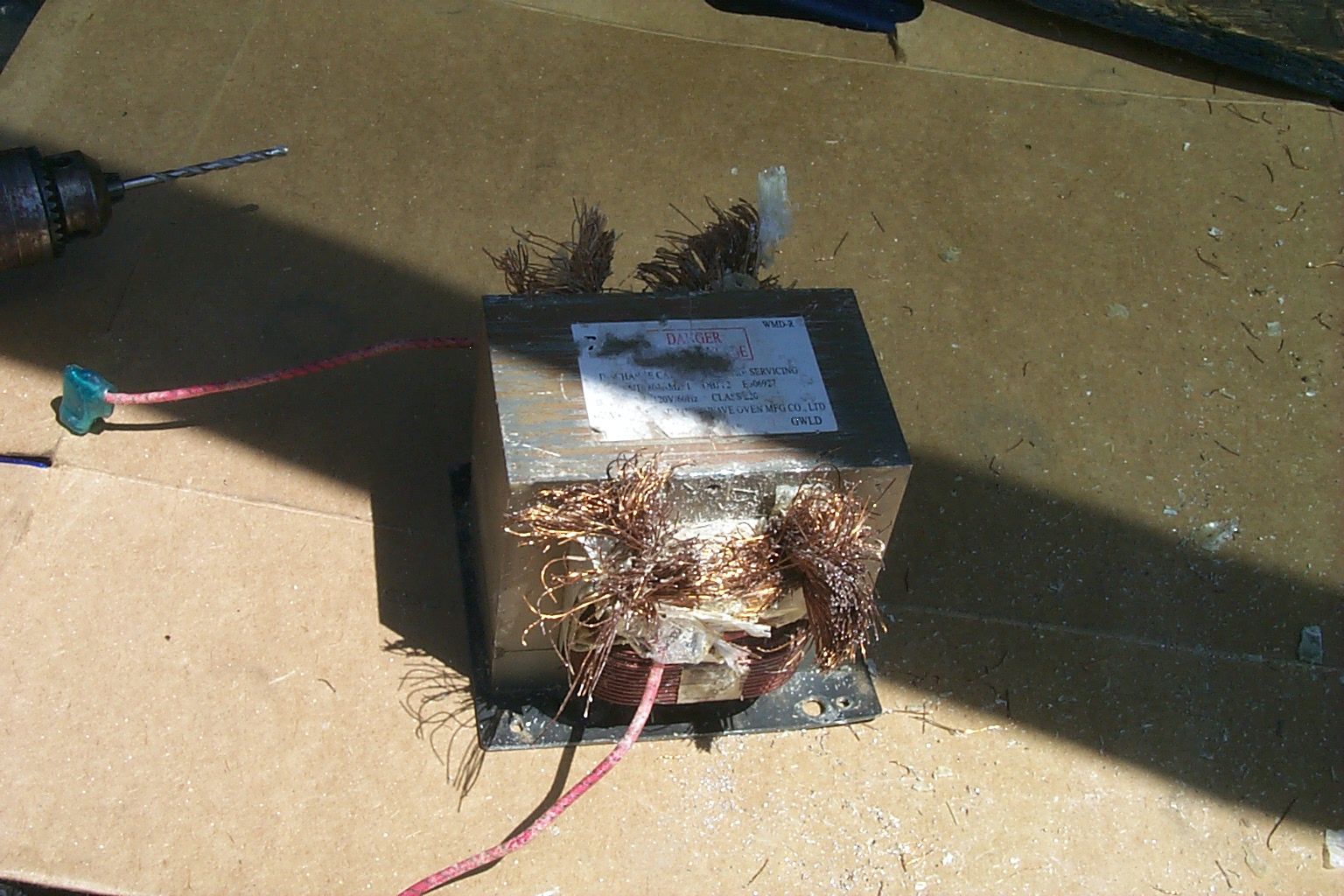

The secondary is wound so freaking tight in there - even if you got rid of all the lacquer, ther is no room. The secondary is the limiting factor. I think it had something like 20,000 windings of 30-33 gauge wire. You will never get 1 turn out ... you cant. The best way it to cut off the exposed parts. Then sink a drill through the part between the EI core and after you get 3-4 holes per side, you can knock it away from the wall and knock it out. That secondary was machine wound outside and then stuffed with the core laminations.
Now the primary - there is a ton of room. Loosen the lacquer and it will come apart turn by turn. Anyway my nicked primary, I am not risking the thing blowing. Its been cut out and removed just in case in a round of idiocy I decide to use it.

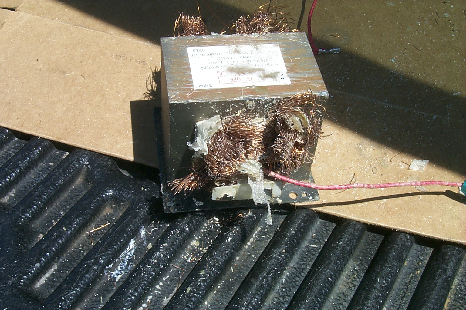

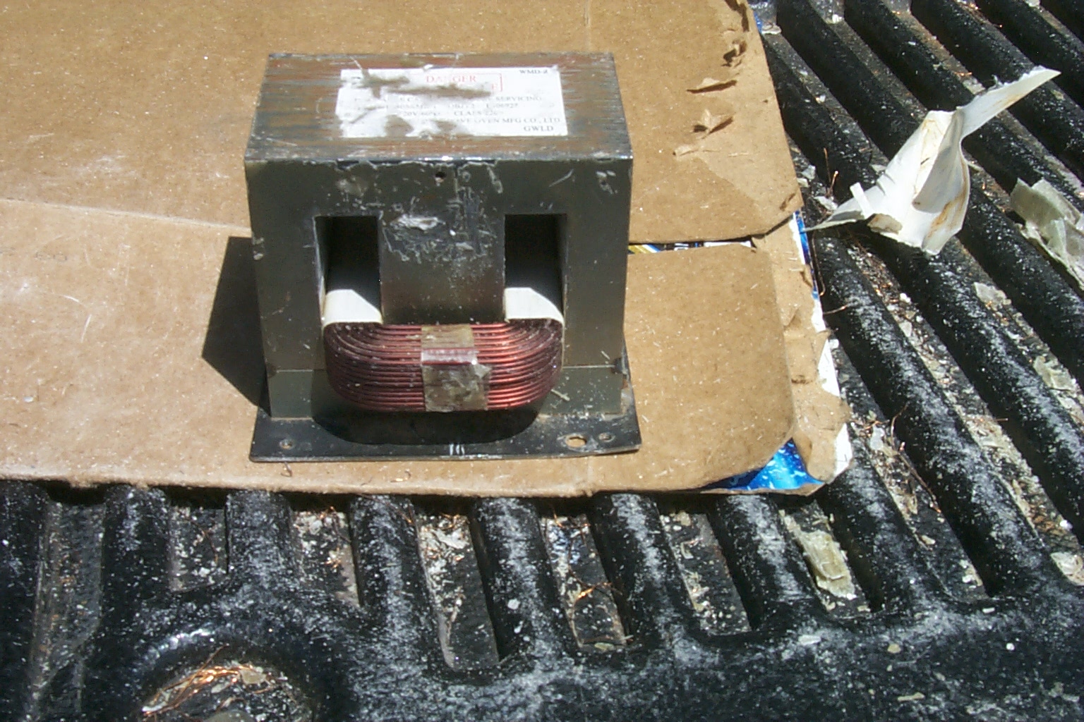

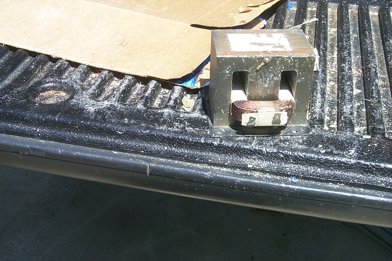

Pics attached.
These are pics I got off the ones I gutted.
That secondary is a royal mess - I did better on the first one than the second but that was due to the way it was wound.
