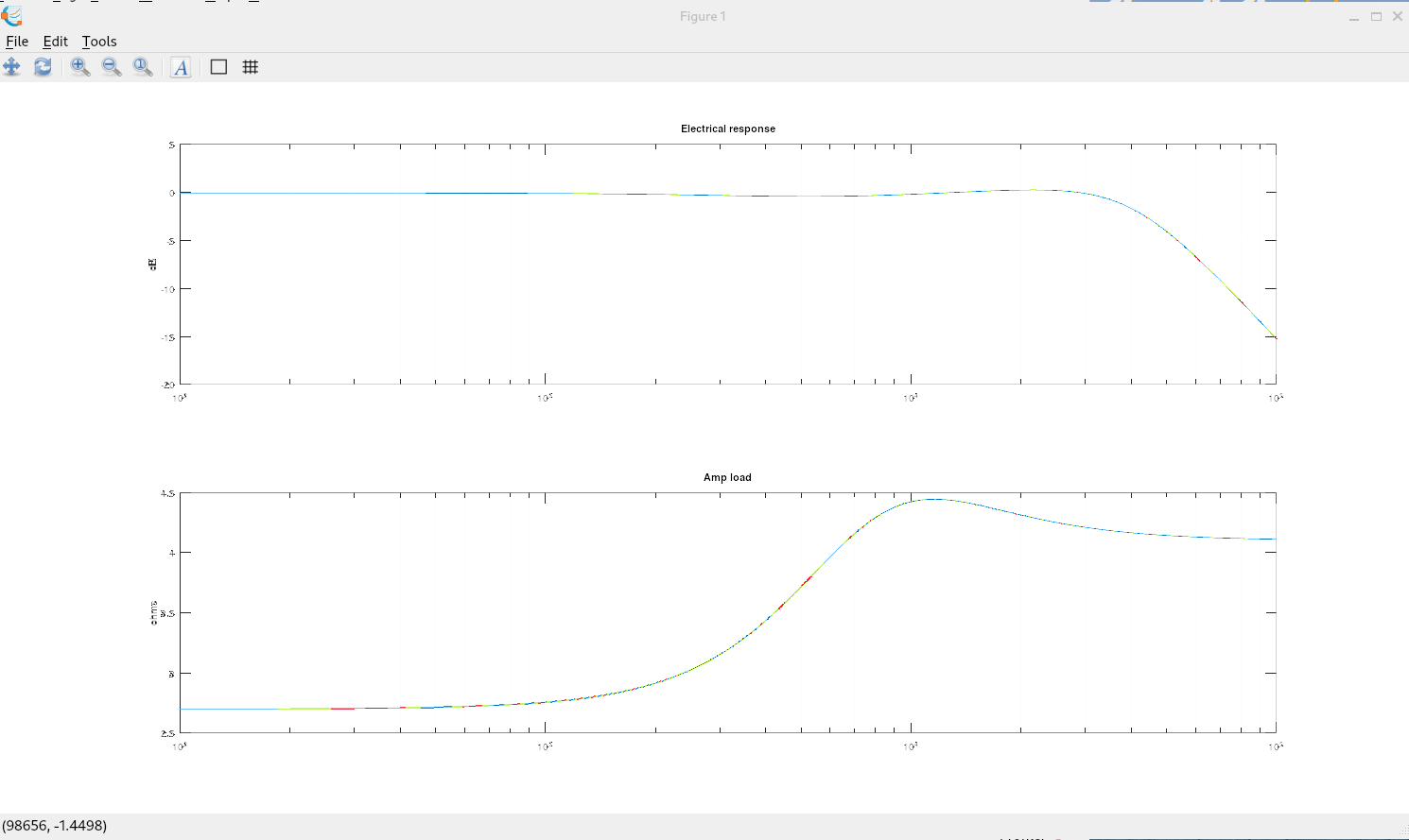

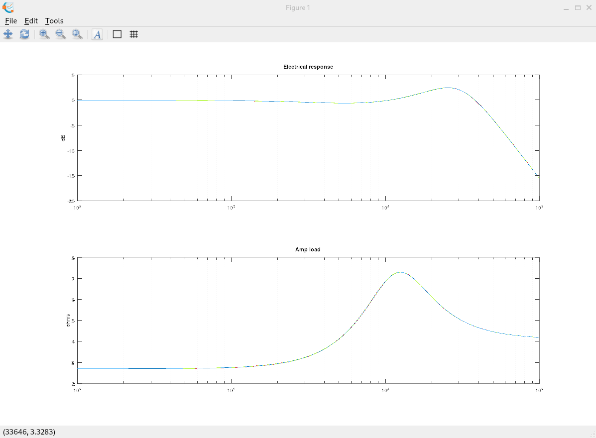

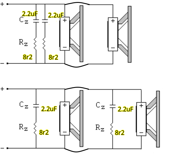

(digging through parts bin)
Well, I happen to have 4 x 5W 8.2 ohm Xicon metal oxide resistors, which could be paralleled for 4.1 ohms (each speaker).
And I have 2 x 2.2uF 630v Obbligato Film Oil (non-polar) "audio capacitors", which are each approximately the size of D-cell batteries.
The values deviate considerably from the calculated values, but as expected the GNU Octave simulation results are not "terrible". Response gently rises starting at 9KHz ending +1.8dB at 20KHz, and the impedance isn't "crazy". (see attachment)
Not ideal, and a really stupid use of the capacitors since component "audio quality" is basically moot in a Zobel. Thinking I might purchase some more appropriate caps. I guess while I am at it, I could do some math and buy some resistors to get closer to the calculated value.
I dunno. These Obbligato caps have been sitting in my bin for a long time and not been used. The DCR is 0.00 as measured by my component tester. Also, a small boost on the top end might add some "air" that might be welcome... (if I can even hear it).

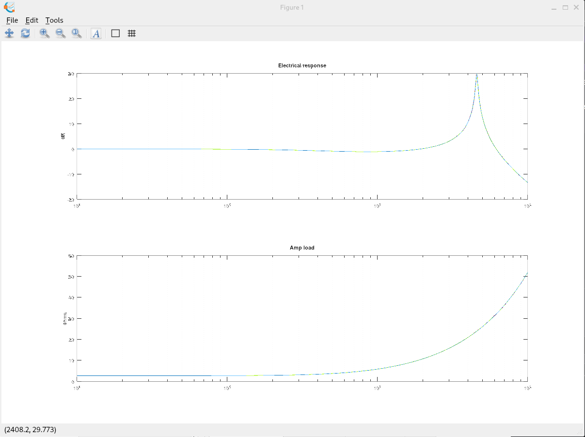

For reference, same sim, no Zobel. The massive peak is far out of the audio band, but for reasons that I don't understand this can still be a very bad thing (from what I have read). Something about ringing? reflections? possible amp damage (Wiener).

Today I finally had a chance to implement this change, and I have to say it was a huge success!
Wrap up: Speakers are wired in parallel and now include a Zobel (4.4uF--4R1) for ~3-4ohm nominal load. They sound excellent with the Wiener TPA3118 amp - all ringing and top end harshness is gone. To my surprise, I do believe they sound noticeably better with my Tubelab SSE now as well (using the 4ohm taps, of course). This was unexpected.
