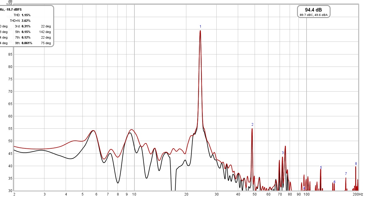

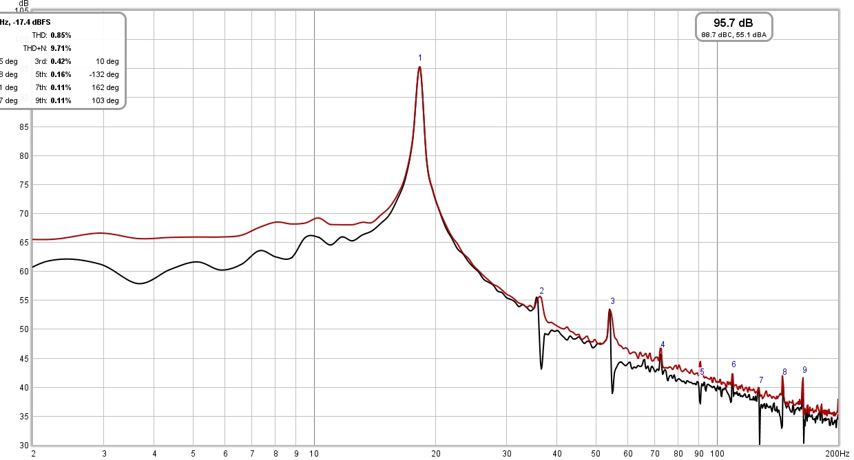

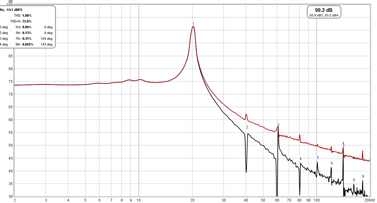

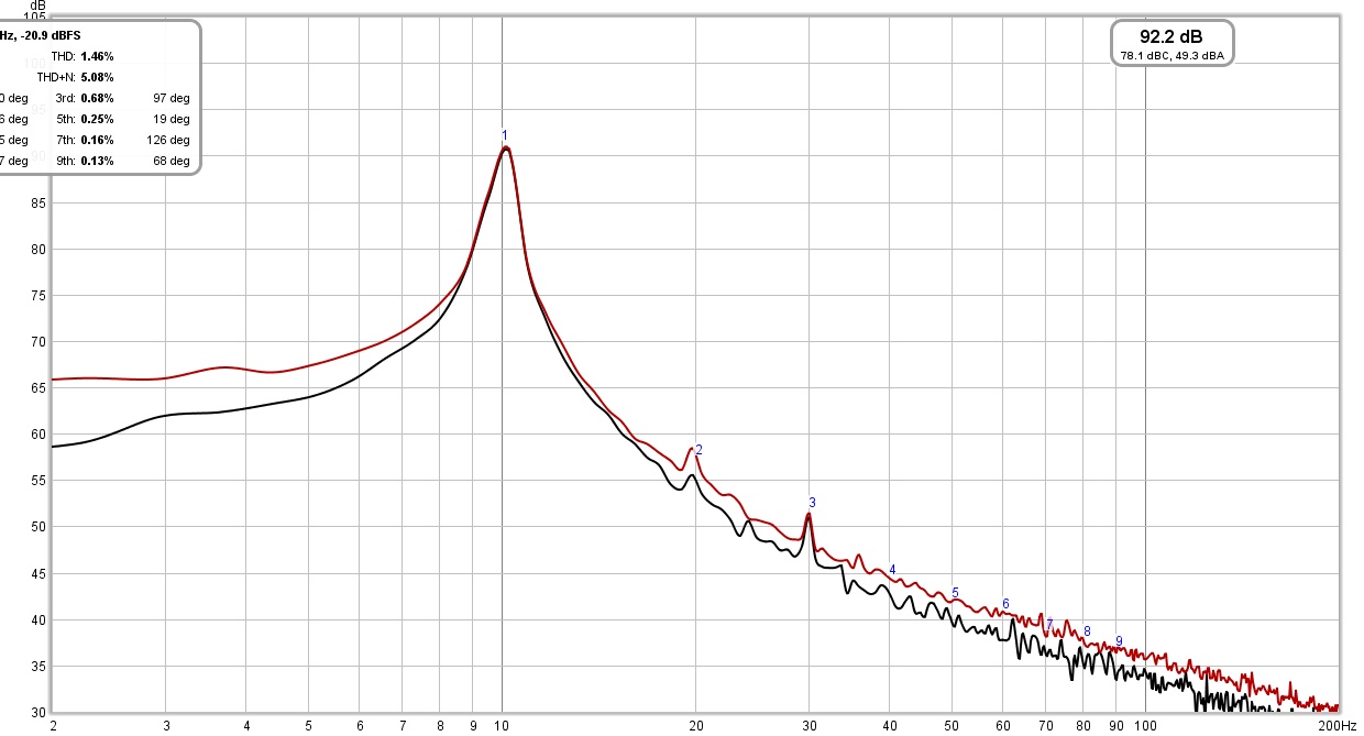

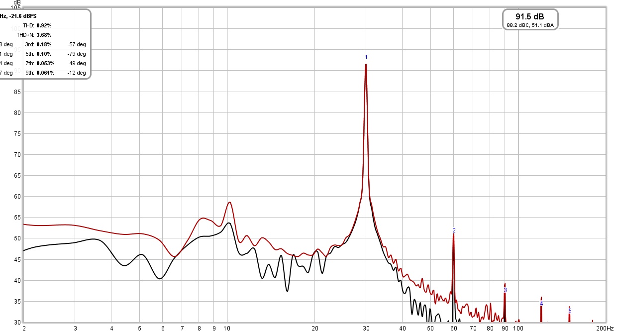

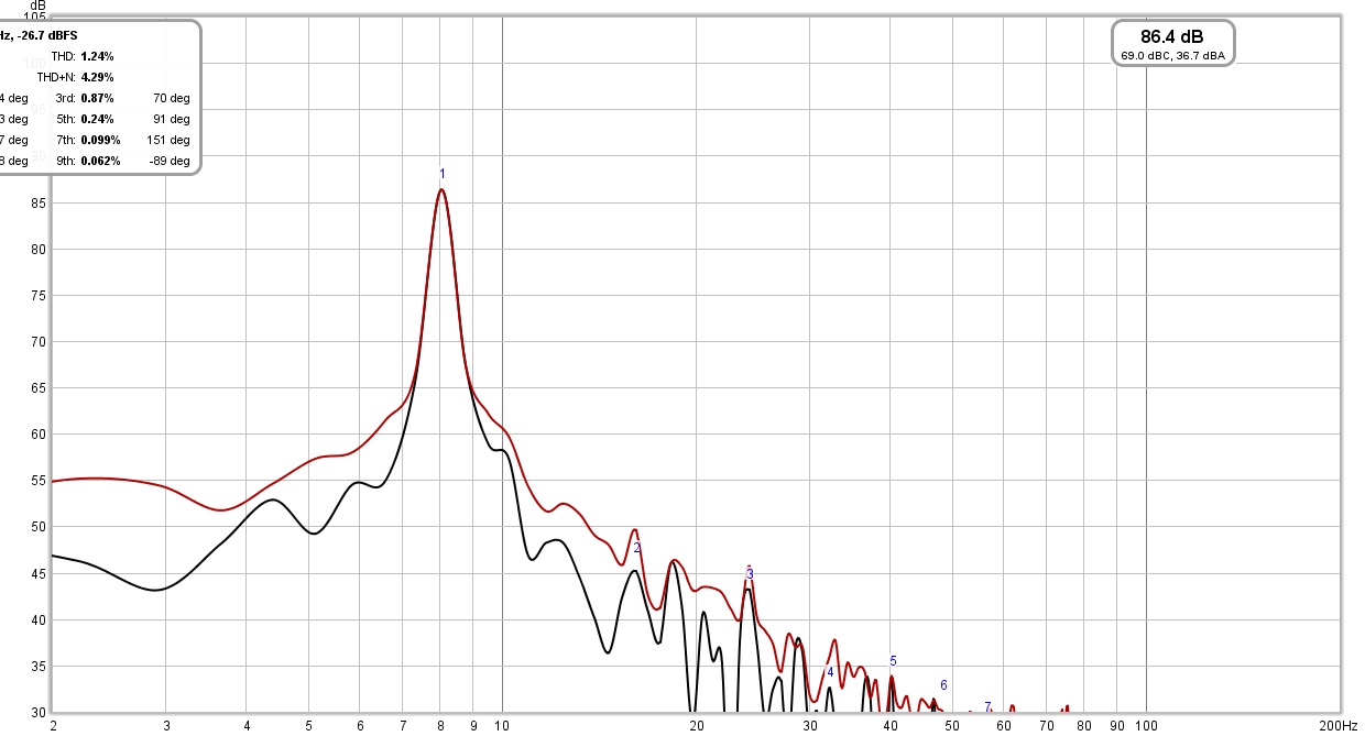

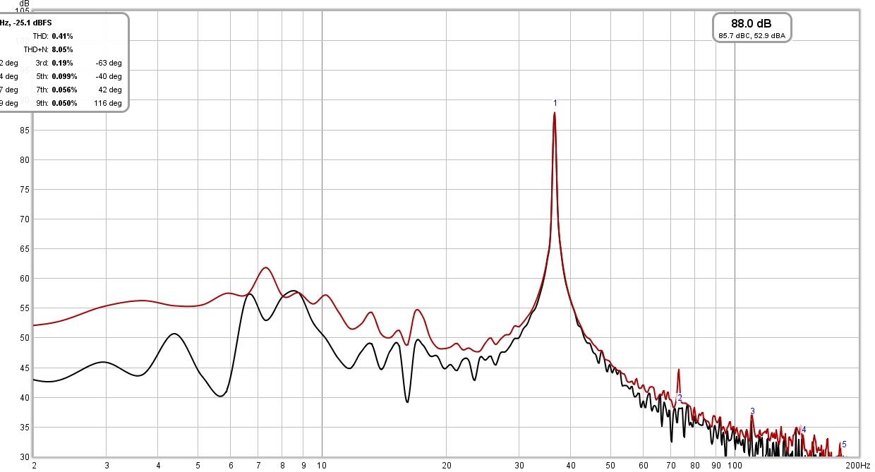

In my open concept room 28' x 40' with 10' ceilings and open to second floor and basement the 8" subs (x16) with 105 dB Pink Noise at 4m distance at listening position they measure only 1% THD from 8Hz to 37Hz.
Those 16 x 8" subs have the displacement of 2x 18" subs and only a fraction of their distortion.
In-floor subwoofer s- 8x8" drivers each, highest WAF factor
Increased number of smaller subs can outperform bigger subs easily.
You can get a lot cleaner bass from multiple smaller subs.
Some of the advantages are increased sensitivity (add extra +3dB each time number of subs is doubled), reduced thermal compression (the power is further dived between the individual drivers; heat dissipation is a lot easier when the heat load is spread out to multiple drivers) , reduced THD.

This is just plain wrong. You dont get the 3 db gain pr doubling up unless you also doubling up the power. 10W at one driver. 4 drivers will then get 2.5W each. So total sensitivity wil remain the same. And if you doubling up the power for each doubling of drivers to get the extra 3db pr doubling up, what then with your next point regarding heat dissipation? That goes straight out the window. You don't get the cake and get to eat it too. You never do in this Hi-Fi world.
No, you got this wrong.
You get 3db more output when you double the number of drivers in the group while the total power remains the same - that's due to increased sensitivity in the drivers group by 3dB.
When you double the group power on top of that so each driver remains powered the same amount - that adds another 3db to the output - a total increase of 6dB output relative to a single subwoofer.
That's why when a second subwoofer with the same power is added - and placed within distance 1/4 wave length of the highest frequency the driver is playing - besides another subwoofer the total SPL output goes up by 6dB. 😀
That's the main principle of multiple driver combinations.
