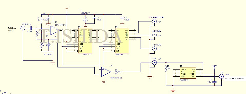

Yesterday, at elecon's site at Tokyo, I listened Mr. Ishida's SDTrans192 with Rubidium-based external clocking units.
The effect was especially and easily detectable on 352.8 kHz / 24 bit 2L DXD sources. I think its sound is the most perfect and accurate among digital sounds that I ever listened though my experiences are limited.
I felt every single tone was maintained as non-degradated. I was astonished that even a faint diminishing sound of strings and piano held its fine structures.
Mr. Ishida prepared his clocking systems after his vigorous efforts.
However, costs for materials are not so expensive at all.
He selected Rubidium Oscillator FE-5680A that was easily available at eBay.
1 Hz to 20 MHz|Programable Rubidium Frequency standard - eBay (item 290301888238 end time Feb-03-10 05:56:05 PST)
As SDTrans192 requires two master clocks, 22.5792 MHz & 24.576 MHz, he prepared two units.
(If you send appropriate commands to the unit by way of a serial control line, you can change its output frequency easily. This time, he prepares two units of pre-set.)
FE-5680A's frequency limit is 20 MHz and its output wave shape is sine-only. Mr. Ishida made a multiplier with sine->square shaping using Phase Link PLL502-02 and a comparator.
http://www.phaselink.com/pdffiles/PLL502-02.PDF
Therefore, two FE-5680A were set for 11.2896 MHz and 12.288 MHz, respectively.
The multiplier & comparator unit is shown on a sub-board appearing to the right side of SDTrans192. He also tweaked SDTrans192 clocking circuits in order to accept external clocks.
I'd like to express my gratitude to Mr. Ishida and "elecon" who offered his excellent audio room and equipment for listening tests.
can i know how to make the clock into square wave, and the design of the circuit where the 11.2896mhz clock enters the clock multiplier IC?
i read after the ic specsheet, it says only accept 12mhz and above up to 50mhz?
Would be nice to have detail for the external clock multiplier and comparator circuit and which are the modification at the transport in order to accept the external clock?

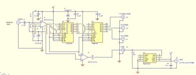

Mr. Ishida sent me his schematic and asked me posting here.
He hopes it is helpful.
can i know what are those IC? i know only 74AC163 and PLL IC others i don know.
can you help more? what are those other chips? where can i source it?
A line-receiver IC is SN75157 and counters are 74AC163 and 74HC163.can i know what are those IC? i know only 74AC163 and PLL IC others i don know. can you help more? what are those other chips? where can i source it?
I think these are available on Digi-Key web site.

As you have noticed, they are used for a frequency demultiplier to get relevant LRCLK or word clocks. In the case of SDTrans192, it just requires a master system clock. It can't accept any external word clock input.what counters are 74AC163 and 74HC163 for? what are those 176.4khz,88.2khz and 44.1khz for?
Bunpei
so if let say i would just like to use the clock as 22.5792mhz output i dont need 74HC163?
You don't need those counter ICs.so if let say i would just like to use the clock as 22.5792mhz output i dont need 74HC163?
Bunpei
Bunpei
u mean if i want to merely multiply the clock frequency i don need 74hc163 and 74ac163? do i need sn75157?
You need the SN75157 for sine wave -> square wave conversion.
(It's a comparator.)
