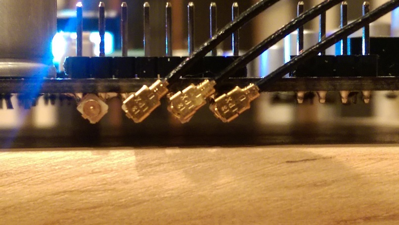

UFL 12s connection from Ian PCM to I2S converter from a SDtrans386
Hi there gents, .....bit of a newbee question😀
Ref:- 12s connection from SDtrans 386 to Ians 12s to PCM converter PCB...then onward to a Aya DAC (With Sim mode option)
Just about to get my SDtrans 386 and i have Ians 12s to PCM converter to hand also.
If i wanted to connect the SDtrans to the PCM converter..as i see no UFL Outputs on the SDtrans , i asume this must be done from the header on the SDtrans to the Header on the PCM PCB (only way I think?)-
-From there it easy (UFL to UFL cable from PCM converter to Aya DAC
....OR is the PCM conversion a mute point as the DAC can run in Simultanious mode from 12s any way??
My thanks to you sirs
Johnny

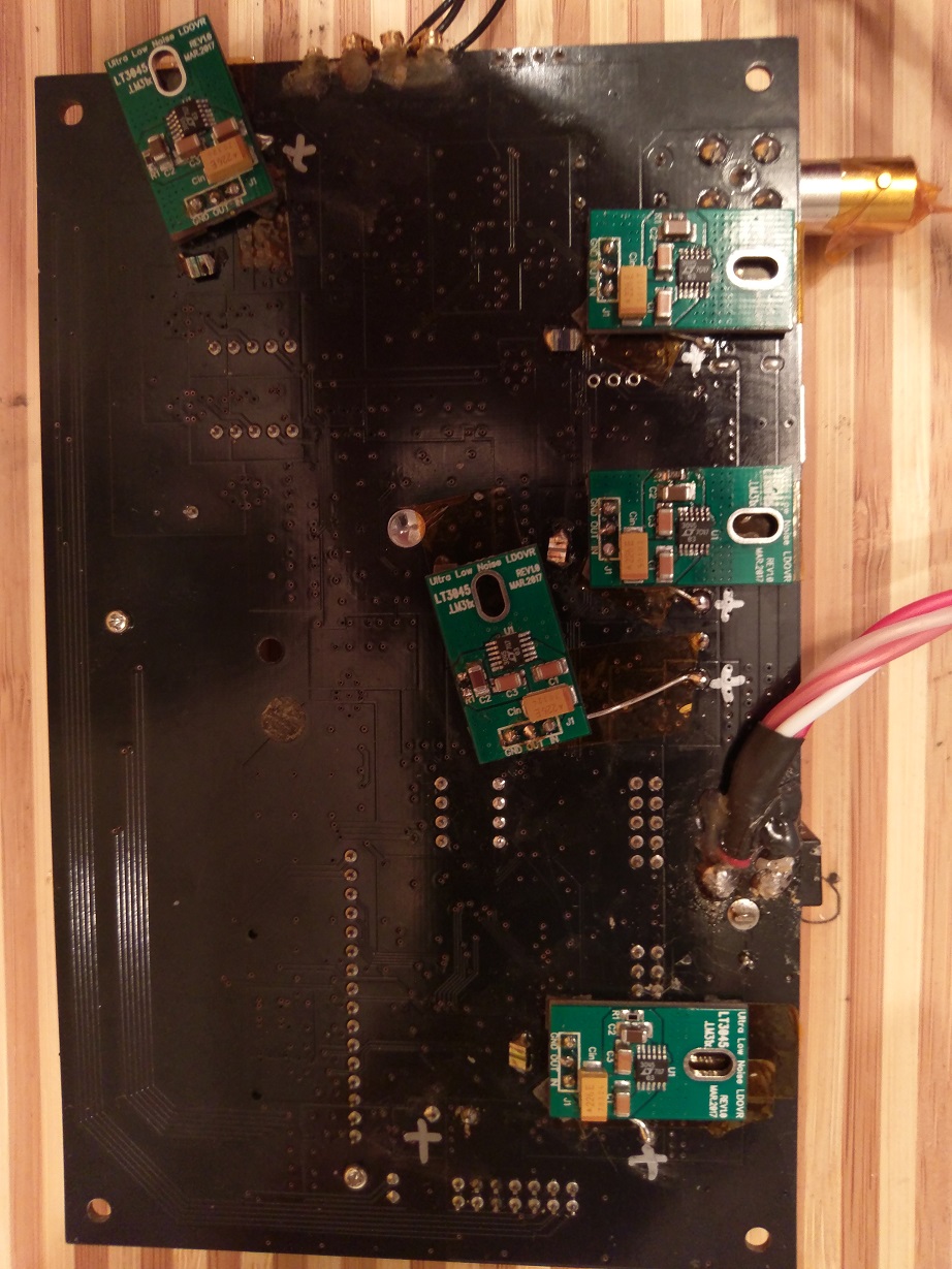

A few weeks ago I did a pretty extensive modification to mine. It involved replacing all of the on-board regulators with small LT3045-based boards from ldovr.com. Given that the SDTrans384 has readily available external voltage insertion points, it made this mod pretty easy. Nice upgrade in definition too. Clocks possibly next, I've got some of the higher-quality NDKs from Lorian's group buy. Though I really want to put a Pulsar clock there!

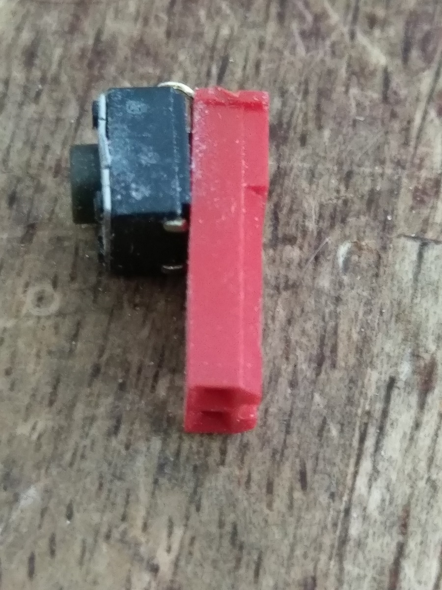

Time for an SDTrans384 Mk2?
In post #224 of this thread dated November 13 2010, Bunpei announced the release of the current HW version of the SDTrans384, then only supporting 192. Several firmware upgrades have enhanced the functionality of the unit, including DSD functionality AND increasing the maximum bit rate to 384.
I've been using an SDTran as my reference digital source for several years now. I have it connected to a highly modified Soekris DAM DAC and listen to it on a nearly daily basis. I've also done some modifications/upgrades to my SDT by using the 5 included external power feed points (3x3.3V, 2.5V, 1.2V) as insertion points for ldovr.com LT3045 boards, along with a quick and dirty 4-relay board remote functionality and a backlight jumper switch. I also added u.fl jacks directly soldered on the bottom of the TTL I2S output pins.
I love this unit and expect it will be in one of my systems for a long time. I especially like the use of distributed power regulation which helps improve the SQ by reducing interaction between different sections of the unit via their power rails.
BUT the platform is now almost 10 years old. I'd like to start a conversation calling for an upgraded hardware platform for the SDTrans. Here is my wishlist for the hardware side:
- Upgrade each of the local regulators to LT3045 or equivalents. Consider adding another regulator and external power feed point to exclusively power the SD Card.
- Upgrade the clocking inputs/outputs and TLL-level I2S outputs to include at least pads for installation of u.fl connectors for better signal integrity. Include dual sets of u.fl pads for the TLL I2S output to simplify use with dual-mono DAC board setups.
- Upgrade the on-board clocks... at the very least go to the lower-phase-noise SDA version of the NDK clocks on the board. Better yet might be to go with a plug-in carrier board similar to what Ian Canada uses on his FIFO setups to enable less invasive clock upgrades / replacements.
- Consider flip/flop style synchronous reclocking of the 2 I2S outputs right at the output connector points for the highest signal integrity.
- Look at upgrading the S/PDIF output chip to one of the later ones. That world has seen some improvements in the last 10 years. Also look at the LVDS conversion chip used to create the LVDC I2S output. There might be better (adding less jitter) ones available today.
- Plug-in add-on boards to enable easy remote operation (via relays or custom solutions), synchronous clocking (similar to what Chaiki did for his DAC designs), momentary switch for backlight (similar to what I did with a custom header), remote display operation.
AND here are some thoughts on some SW upgrades. NOTE that I would not want to see any of these implemented IF their implementation compromises the SQ we get from the SDTrans. It is currently and always will be a bit of a hair-shirt affair to use. While these could provide some useful upgrades, nothing will make it an easy-to-use unit appropriate for every digital playback setup. SO if any of these requires either HW or sufficiently extensive SW upgrades to compromise the SQ, I personally would not want them. BUT if they can be done with no compromise in SQ, here's my thoughts:
- FLAC decoding
- Higher PCM & DSD samplin rates
- Larger SD Cards... at least 64Gb
- Output signal phase reversal
- I2C signaling of output type (PCM or DSD), bit-rate, bit-depth, AND if possible, de-emphasis flag (used in a very small number of CDs)
Any thoughts?
Greg in Mississippi

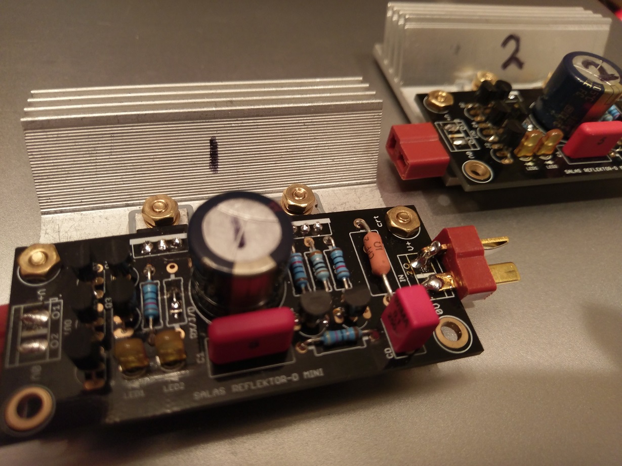

As I said above, I now have a 5V/450mA Salas Reflektor-D and intend to try it one powering the SDTrans with several different raw DC supplies, several AC-powered ones and an LPS-1.2 at 12V. We'll see how those setups compare to my current reference supply.
Greg in Mississippi

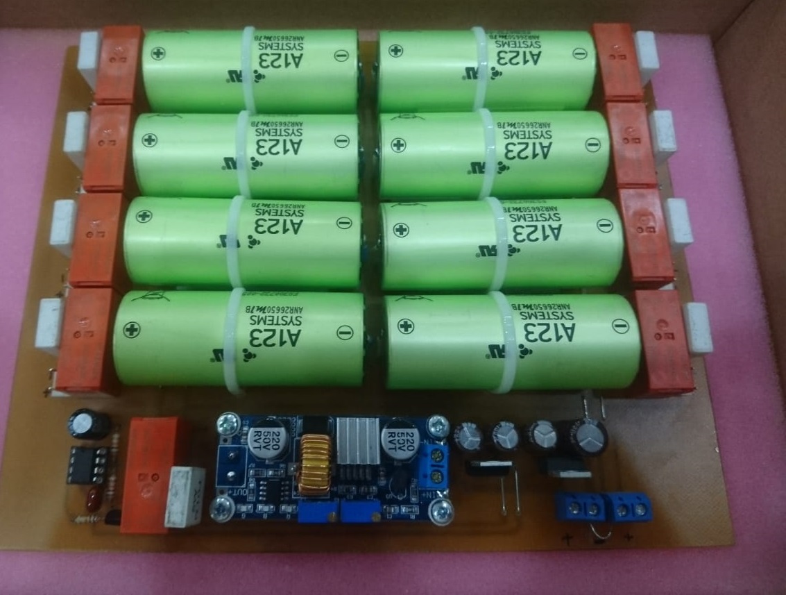

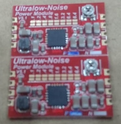

Hi Greg,
Below is my LifePO battery power supply.
It was made by my friend, intended to follow information from RandyTsuch on Tirnahifi.org for Soekris DAM. Then we found thread from Ian for battery power supply but cannot wait for completed version.
I plan to use these LifePO PS to feed both SDTrans384 and Soekris.
For regulators to get lower voltage, I got some China made base on TPS 7a47 which rather good.
Hopefully I can finish project in next 2 months 🙂

@bitinhvi,
That should work very well. While the TPS7A4700 are not the latest and greatest regulators anymore, they are still good and should serve you well here... and be significant upgrades over the ADP151 LDO's on the board.
Looking forward to hearing your report.
BTW, Ian will be starting his Group Buy soon AND his LiFePO4 board will be around $200. Looks like you have what you need with this, but just in case...

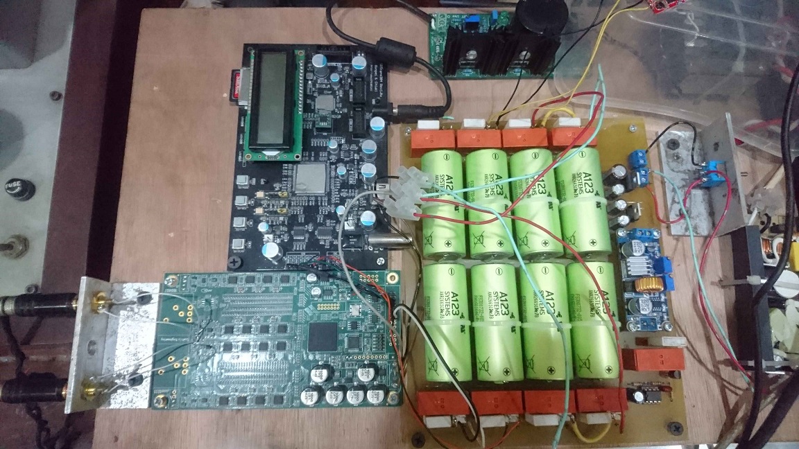

Hi Greg,
Thank you very much for SDTrans manual, below is my progress so far.
Not all running on battery yet. Unfortunately, my regulator board has minimum voltage output at 1.4V, so the SDTrans is fed by TwistedPearAudio Placid shunt power supply. Sound is so good.
Just place order for 02 ldovr.com LT3045 boards, after that I can run SDTrans on battery. Can't wait to here how it sounds.
