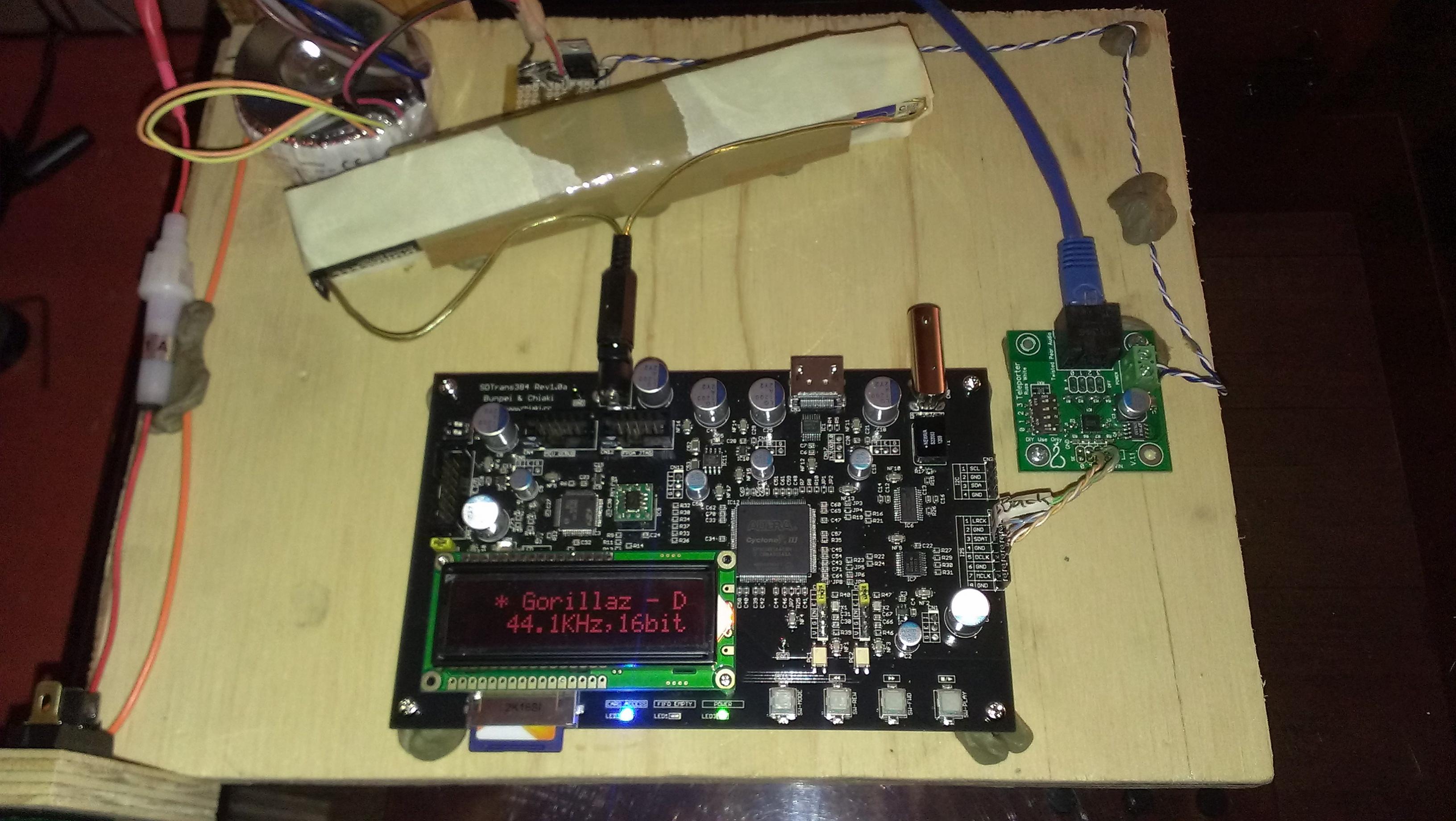

I got the Sdtrans384 working. It is powered by 4 c cells. I tried 3 but the LCD wasn't visible. I have the I2S output connected to a TPA Teleporter. I am listening to 16/44 for the most part. I have some of my own vinyl rips that are 24/192 so will need to get some high res files to check out what it can really do. It sounds really nice. Very full sounding, like sacd. Great job on the excellent digital source. Thanks guys!

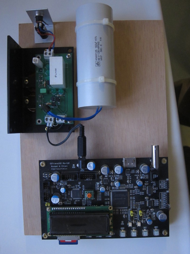

I am using a fully discrete series regulator, 500mA, that is being fed by a good raw power supply and a toroid transformer. I think this is better than batteries. Batteries are noisy and do not have low output impedance.
I just received shipping confirmation of my SD Trans from Tachyon. I hope to have it soon! Can anyone point to a great ps scematic to use with it?
SDTrans384
I replaced the batteries with a TPA Placid and it sounds much better. I looked into getting the TI TPS7A4700 evaluation board that Bunpei suggested but it requires hotair mounting the smd parts. I haven't done that before and dont have the tools to do that. Any schematics for a really good regulator I can solder?
What are people doing for a case? The face looks like it needs a thin material to make the card slot easy to use and needs to let the leds be viewable.
Has anyone got a remote set up to contol their SDTrans384?
How long can the I2S wires be before there are issues. I am connecting to a Teleporter so it isnt too hard to setup but it would be good to know how far back to the back panel.
I will get the PPS caps from Bunpei to improve the sound.
This thing is a real step up from the shigaclone cdp I was using before.
Thank you again for the great SD player.
