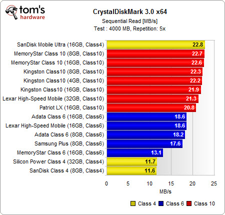

It makes sense that for SDtrans read speed is what matters, I'll try a few others.
here is very interesting group test at "Tom's hardware"

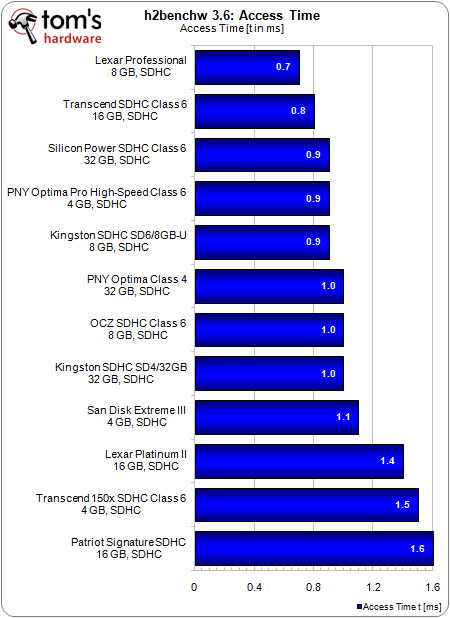

It is still not clear to me if response time of the SDHC card is also critical for SDtrans, this parameter also varies a lot and is not directly related to Class classification.
Here is Silicon power class 4 read speed and a access time comparison test:
