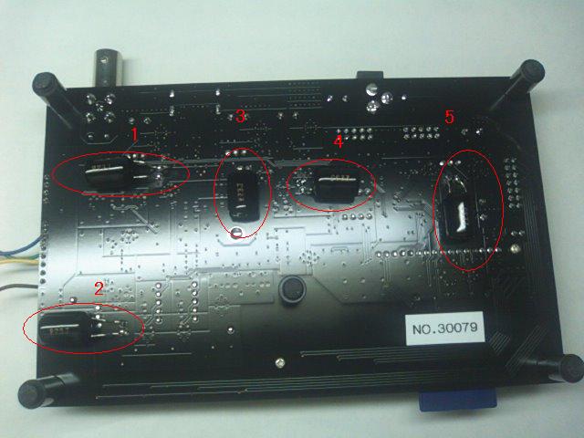

Could you please explain more in details how to update the Eprom and to install the pps cap? An attached image of the sdtrans192 with the pps caps installed will also be highly appreciated.
You have a new EEPROM onboard. You don't need to update it.
As for soldering PPS caps, please look at the picture attached.
At the back side, you will find two leads of C2, C19, C26, C50, C9 are soldered at two points, respectively.
Please solder the leads of new PPS caps to the soldering points of those original caps at the back side. Priorities for adding caps are labeled on the picture. The number 1 means of the top priority.

Mr. Bunpei,
Thank you so much for your explanation! Will try to do the same. Right now already very impressed about the sound quality, very excited to test it out.

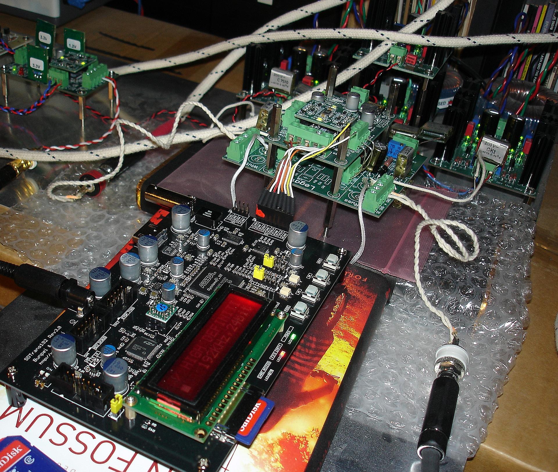

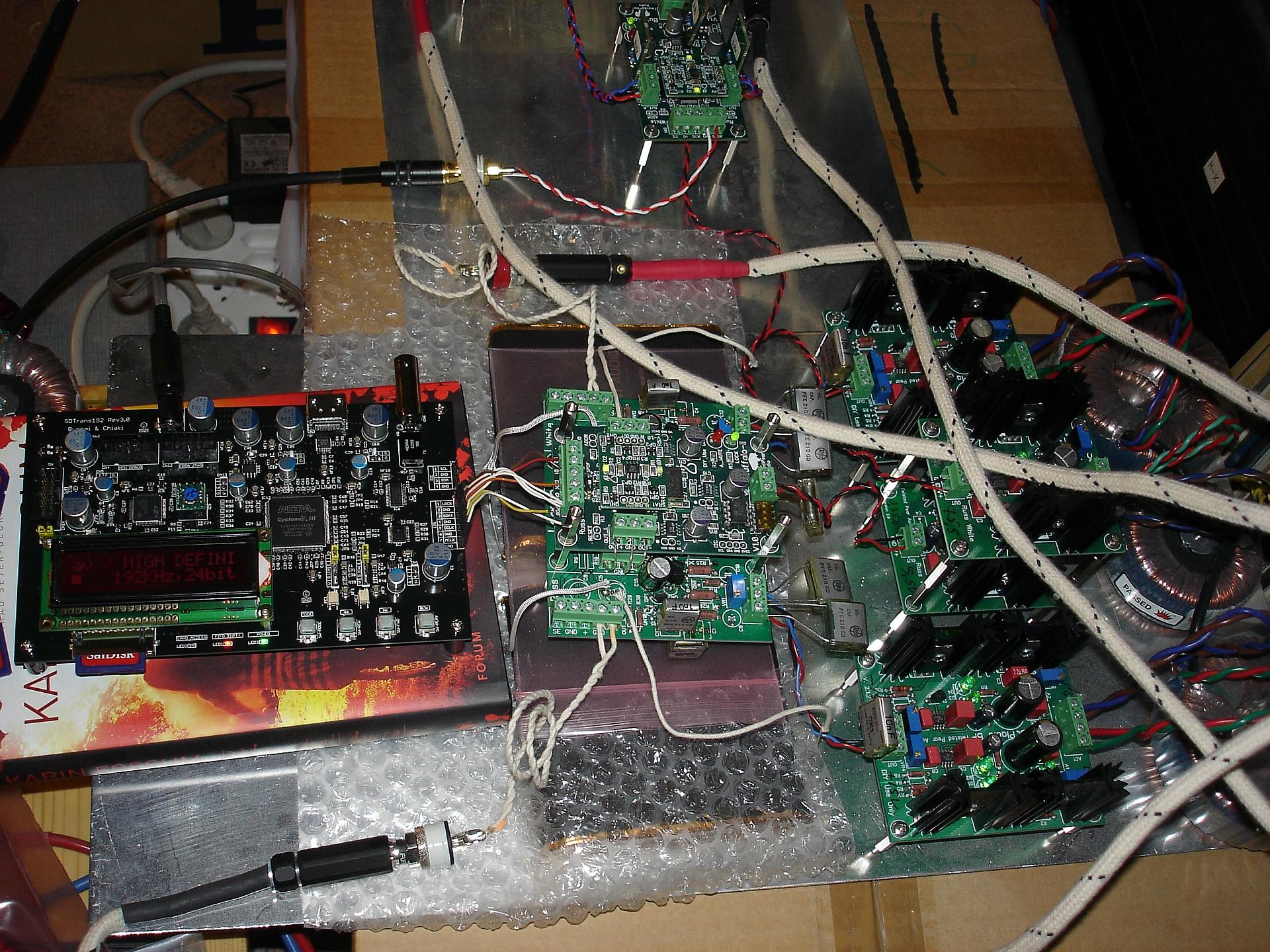

I am very satisfied with my SDTrans192 version 3! It sounds fantastic and the user intereface is better than in version 2.1.
I am using my SDTrans192 with the Buffalo 2 via I2S and a highly modified Legato 2 with Duelund VSF coupling caps and film and foil polystyrene caps from RIFA.
In the photos below, you can see my setup.
I also have another Buffalo2 which is connected to my computer via a USB-SPDIF intereface - for background music.
