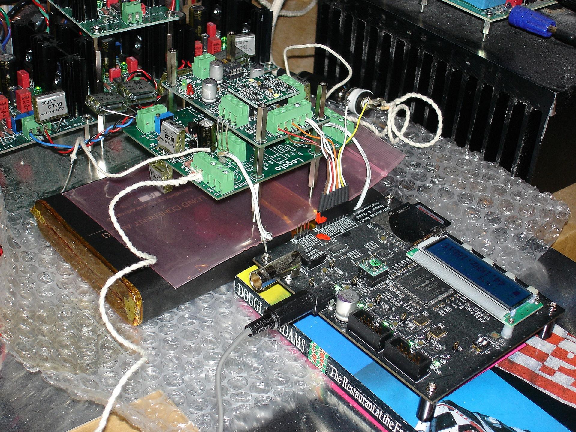

Mini Review of version 2.1 vs version 3.0
Here is a SDTrans192 mini review of version 2.1 vs version 3.0.
Hardware used for both version 2.1 and 3.0 of the SDTrans192 as well as DAC and IV converter:
ScanDisk SDHC 16GB Memory Cards.
5 cm I2S cable between the SDTrans192 and the DAC.
Twisted Pear Buffalo 2 DAC with 80 MHz clock using a - by me modified - Twisted Pear Placid Super shunt regulator at 5.5VDC.
IV Converter: highly, by me, modified Legato I, with for ex copper foil Duelund VSF 10uF caps in the signal path. Power Supplies were, by me modified, dual mono, Twisted Pear Placid BP Super shunts at +-14.5 VDC. One toroid transformerper channel was used.
A MOSFET series regulated +5 VDC for the SDtrans192 was used. It has a separate toroid transformer.
Twisted, solid core, silver wire, in unbleached cotton insulation, and Furutech Rhodiumised connectors were used between the Legato 1 and the line amp. Silver wire was also used between Buffalo2 and Legato 1, and between the huge Duelund caps and the Legato 1.
Software versions were 3.03 for SDTrans192 version 3.0, and version 2.21 for SDTrans192 version 2.1.
Changes made between version 2.1 and 3.0: please read Bunpei’s post here http://www.diyaudio.com/forums/digi...ry-card-transport-project-23.html#post2372262
Mini Review
This upgrade is a major one. The PCB is much larger than the old one, and the SD card inlet has been moved to be under the very bright and sharp display. You can now also disconnect the backlight of the display if one feels that the display being on can affect sonical quality. I did not check this. I like to have the display on all the time. As before there are SPDIF output (up to 24bit and 192 kHz - limits of the SPDIF specification) and I2S output (max 352.8kHz/24bit or 192kHz/32bit) but there is also a new interface and that is a HDMI connector. The specification for this HDMI interface is based on a specification developed by PS-Audio and one sends I2S signals via this interface - up to several feet long cables can be used. I have no possibility to test this interface.
A very important part of the upgrade is that version 3.0 uses low phase noise crystal oscillator modules (clocks) from NDK in Japan. Another, equally important, is that on version 3.0 much work has been done on the PCB layout, and not to forget the work that has been made to the power supply circuits to obtain lower noise .
For the hard core user, one can use an external master clock (how about a Rubidium clock – anyone?), use separate power supplies for most voltages on the board (batteries, anyone?), as well as more easily add a remote control to the board.
I have used my SDtrans 2.1 as my reference digital player for about a year, and have been very satisfied with it. Bunpei's support has also made the experience a good one.
I received version 3.0 from Mr. Bunpei Matoba in December, and immediately hooked it up to my power supply to let it burn in for a few days. All listening tests were performed using I2S between SDTrans192 and Buffalo 2 DAC. The highly interesting HDMI interface was not used. Nor the SPDIF output.
When doing the comparison between version 3.0 and 2.1, I first thought that I should listen to music with different resolutions, and then comment on sonical quality for each resolution, but after having listened to version 3.0 for several hours, I hear that the sonical improvements are valid for all resolutions I tested (from 16bit/44k1 up to 32/192 kHz WAV music files - my Buffalo2 does not support DXF files).
Listening to Allan Taylor's "The beat hotel" (16-bit / 44.1 kHz) I find his voice is one of the most powerful voices I ever encountered. With both version 2.1 and 3.0, his voice is full bodied, and close, with good S-sounds, and with version 3.0 there is a more better sounding fatness of his voice, and also I can hear the room Allan is standing in when singing using version 3.0. I also hear that the ambience of the recording is better with version 3,0. Bass is not as voluminous in version 3.0 compared to version 2.1, and the drums are superb on version 3.0. Not as good on version 2.1.
Kari Bremnes’ “Byssan Lull” (16-bit / 44.1 kHz) presents a lullaby song I heard when I was a small child. It brings out some pleasant memories. Kari has a fantastic voice which is not as voluminous on version 3.0 compared to version 2.1. Drums have a more firm bass sound on version 3.0 but the sound is not as big on version 3.0 relative version 2.1. Bass is deep, powerful, and warm on both versions, but with version 3.0 I can hear the room in which the drums were played. There is also mor body to the hihat on version 3.0. Treble is soft and nice and polished on both versions, and version 3.0 presents an even sculptured instruments.
Moving to a high resolution file like “People Make The World Go Round” (24-bit / 96 kHz) bas has punch, slam, and it sounds fast and dry on version 2.1. Even more firmness is presented by version 3.0 whilst keeping the other adjectives in place. The hihat sounds more pure or clean in version 3.0. The tambourine has more details and is better sculptured in version 3.0 relative version 2.1, and the guitar is more easy to hear.
Continuing with another WAV file in 24-bit / 96 kHz resolution, “Love At Last” has a nice choir that is broad in the sound stage. Version 2.1 cannot as easily pick out individual voices as version 3.0 can. Listening to the hi hat it is more airy in version 3.0, and the bells is clearer. Bass is dry on both versions but version 3.0 presents a more clear and detailed bass instrument than version 2.1 is capable of.
Making use of the second oscillator, the song “For Alun Lewis” (24-bit / 88.2 kHz) has some nice cymbals that sound bright and detailed. With a deeper and more detailed bass in version 3.0. Also, the snare drum has more punch in version 3.0 when compared to version 2.1. The superb piano is soft and has good tonality, and with version 3.0 the echo, defining the room, is more easy to hear.
Another song in 24-bit / 96 KHz resolution I listened to was “Up from the skies” and I find myself repeating myself when I say that bass was more punchy, guitars sounded clearer, cymbals had more details, snare drum was had more punch, the organ and slap on the rims were more clear, and in general there was more slam to the version 3.0 compared to version 2.1.
The final song I will present (as I feel am only repeating the same sonical improvements over and over) is a 24-bit / 192 kHz clarinet virtuoso playing the “Vibraciones del Alma Op 45 – Allegro”. The clarinet sounds more pure, more detailed, breathings are more easy to hear, sound is more nuanced with better sound staging, and a sound that is less voluminous.
The only drawback with this version 3.0 player is that I cannot keep it as a guy in Germany is waiting for it.
Conclusions
The updated SDTrans192 player is something extra. It sounds better than version 2.1 which was my previous reference digital source. It sounds awesome.
It is a well-built unit and the price is more than OK for the sonical qualities version 3..0 possesses. Highly recommended.

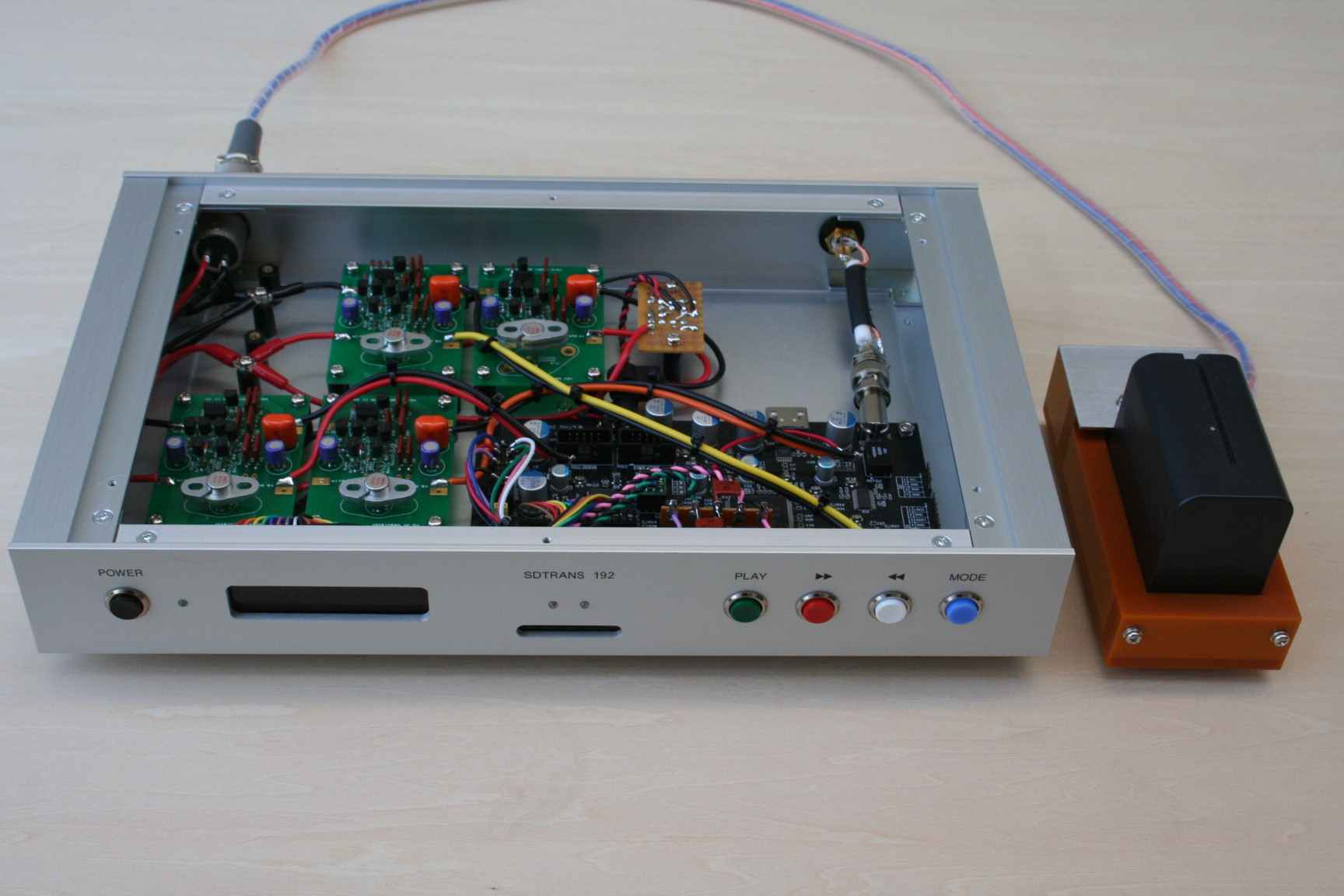

2. Casing
You can use our board kit without casing for a while.
Some Japanese users reported wonderful casing.
(I will report their pictures as soon as I get their permissions.)

2. Casing
Mr. Suzuki, a Japanese user, built such a wonderful casing,
with state of the art metal panel processing.
In this case, he uses S/PDIF interface, an external Li-ion battery unit and additional multiple sophisticated voltage regulators.
Thank you Bunpei for the thorough answer. PM sent.
The PC alternative is one I will consider carefully. I am in no rush. I could pick up an SDtrans this summer when I visit Japan. In the mean time I look forward to seeing more builds that might give me the confidence to put this together. Perhaps your team will be producing some wiring diagrams that are beginner friendly for the likes of me.
Suzuki-sans build is especially impressive, particularly the battery and it's mount! The coloured buttons are a nice touch.
