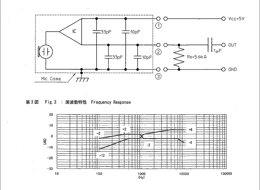

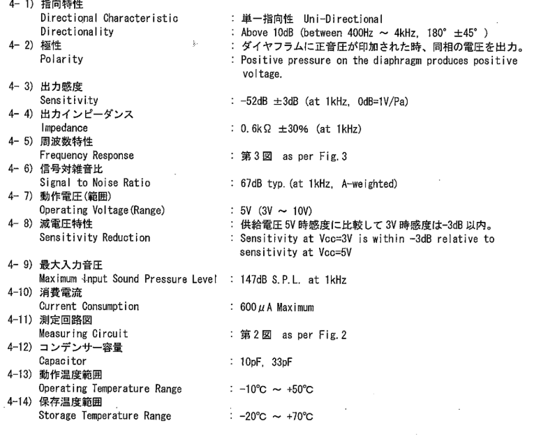

Hi everyone,
I'm looking for a preamplifier to pair with an electret microphone capsule. Can anyone recommend the best preamplifier for building a circuit? My main goal is to fully unlock the potential of the capsule and achieve high-quality sound. I'll attach the parameters of the electret capsule.
Thanks in advance!
