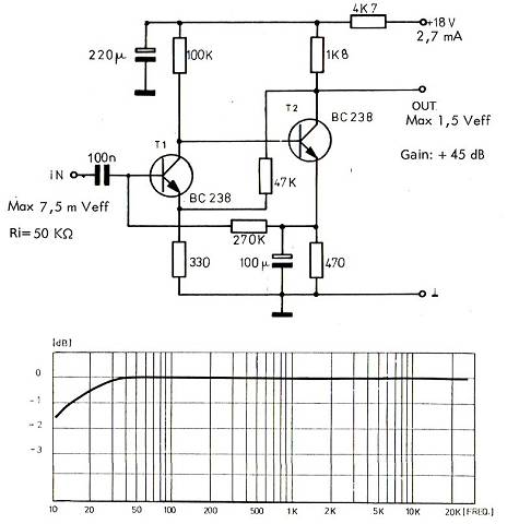

Any one out there with a simple transistor mic pre-amp to connect to a mic to the aux input to a HiFi ampllifier ?
from an old diy-kit:
one should add an output capacitor.
