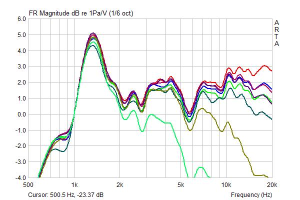

here is how some of my mics behaves in the top end, only five of these is within +-1db, two should be thrown in the trash can, and one is within +-2db
(i hope the attachment feature works)

Wow, MFG states +/- 1dB on the FR between 20 and 20k. Seems hard to believe, but if that is correct that is pretty incredible.
But how do you know if it is not calibrated and compared to a reference mic? The MFG can say virtually anything in their marketing literature... sorry, I am somewhat skeptical!
