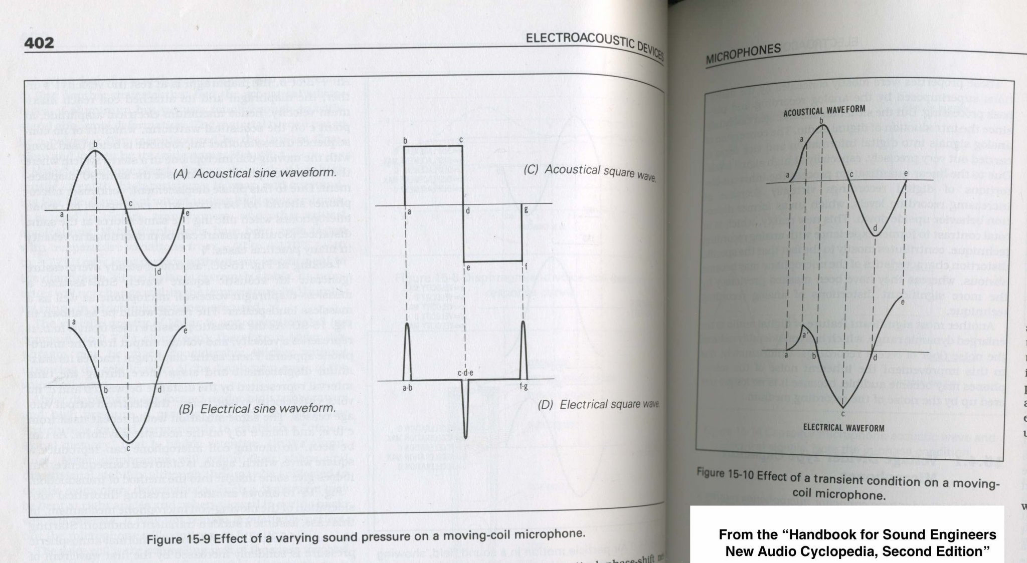

As well as the "sound signature" and "character" of a dynamic (moving coil) microphone being affected by (optional) transformer saturation, frequency response, proximity effect and polar response, there is also waveform distortion to consider .Why would the "sound signature" and "character" be related to intermodulation distortion? Aren't they caused by the frequency response, proximity effect and polar response?
Wired according to the Pin 2 positive standard, a condenser (capacitor) microphone's output electrical polarity and phase response is the same as the acoustical waveform, while a moving-coil (dynamic) microphone's electrical waveform lags by 90 degrees and distorts the amplitude of the initial transient as can be seen in the attachment above.
Back to transformer distortion, in the early 1980's Shure developed the transformerless SM78 and SM77, but the market didn't care for the sound, look or feel enough for them to continue production.
Art
That's a differentiation to time, equivalent to a +20 dB/decade response, not the intermodulation distortion that this thread is about. It would be nice to know the context. I guess it relates to the far-field bass response of a directional microphone that compensates for proximity effect, because a response like that over the complete audio range would be unlistenable.
