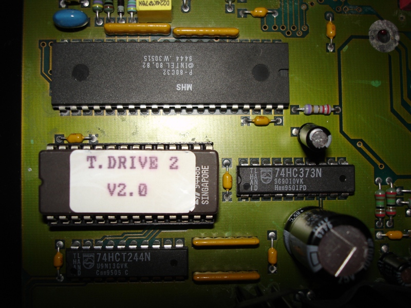

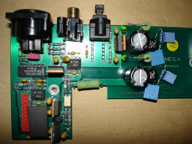

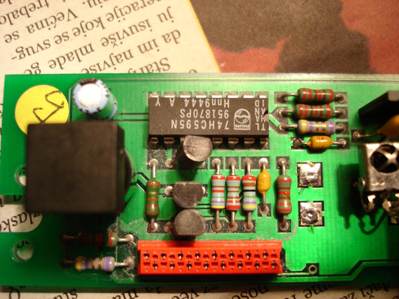

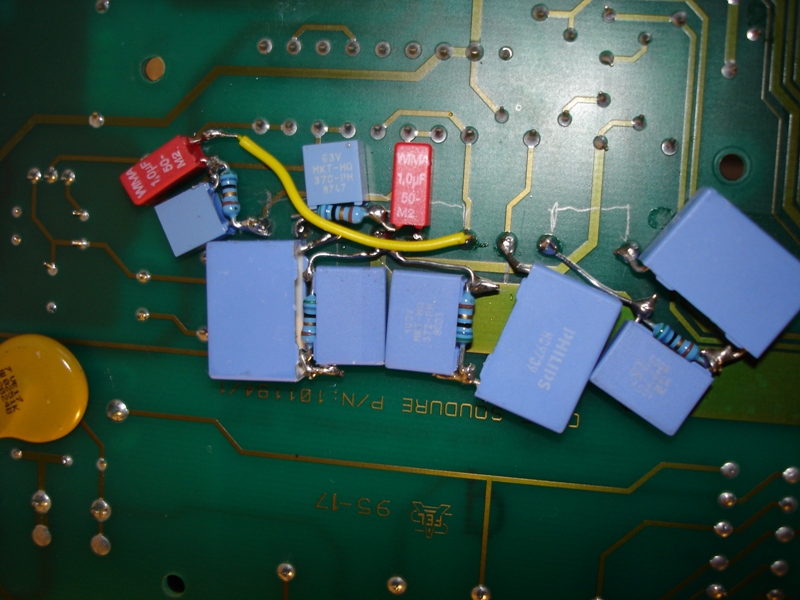

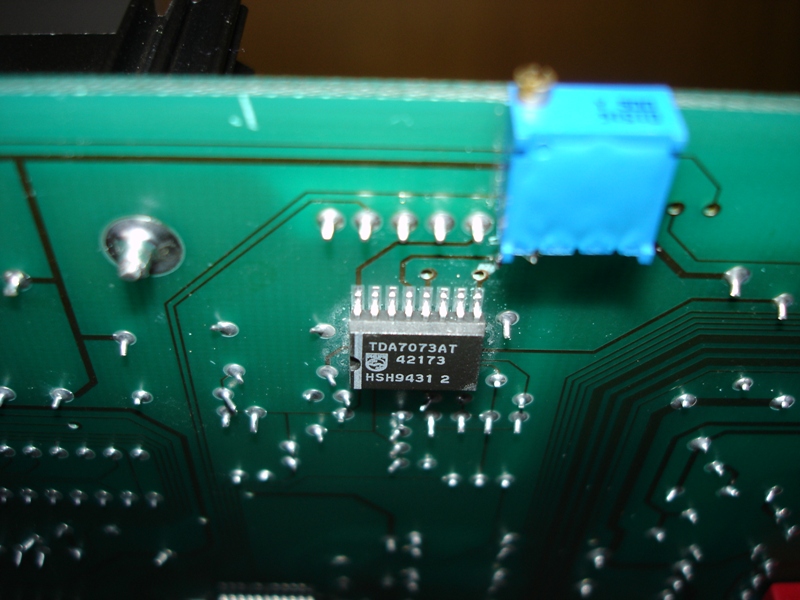

Here are some pictures.Tell me you opinion what can be connected to my problem with remote control unit ?
No easy answer I'm afraid.
With any fault finding once you have tried a few seemingly obvious things and got nowhere, then you have to start measuring.
So that menas checking the basics... that the supplies are clean and correct, and that the IR receiver is outputting clean "jitter free" data.
For all this you need an oscilloscope.
I see it's has had work done on it too, so that makes it harder. You don't know if it's a "real" or a "man made" fault.

Mooly,
As I see you have the very similar PCB board in your stage 2 cd player. Perhaps you have the eprom near the flat cable that comes from display board. And can you tell me what is purpose of that eprom, what is his function? Is it related with remote control functions? 🙂
