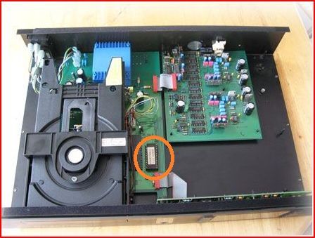

hi fellow members i am abit new on here got a few projects on my hands and i need help i was just wundering if any one could help me i managed to get a micromega stage 2 for pritty cheap as it is faulty as the tray doesnt seem to want to go all the way in or out :s i have done some research and it seams this was a common fault on these , i was wundering if any one could shed some light and is there any fix i have a realy funny feeling it as somthing to do with a little switch on the frount right on the cd tray

hi thanks mooly for the advise just had a look and the belt doesnt seem too bad its more like the tray has some sort of power fault as when i press the eject it opens bout 1 cm the stops as if the motor looses power but if i press the eject again it will open abit more it will take about 3 pushs of the eject to fully open but then it will not return the tray just keeps trying to push the tray out, i also forgot to metion it also says ERR on the screen of the cd player
You need to check the basics for this, and these kind of faults are usually mechanical in nature.

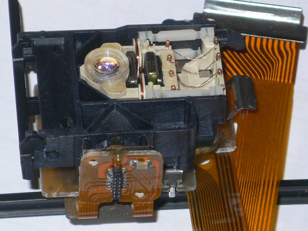

Make sure that the laser pickup is in the normal rest position toward the platter. If you wind the sled out manually and then power the player up, the sled should then return to the centre.
The microswitches should be easy to check by operating the drawer manually... make sure the mech goes into the lifted up position.
The loading motor could be faulty. You should measure the supply across it when performing an open or close command.
You could also disconnect the motor from the PCB and apply 1.5 or 3 volts and see how it performs. Are there any dead spots on it.

Service manuals from the CD713, CD723 and CD753 are also helpful for Micromega's "Stage 2", because there is the same mechanism (but not the same loader) in use. The same loader is in use by the model "CD910" and "CD920", also from Philips - go to
http://www.hifiengine.com/manuals/philips/cd910.shtml
One of the most mechanical issue is the fact, that the loader comes out again shortly after the "close" position. In such cases is to clean or to replace the switch 4822-276-13222 (go to the exploded view from the loader 1210/L1210 by page 38-40 from the service manual of CD910).
