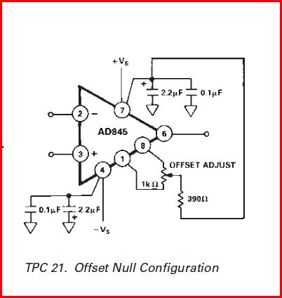

Hiya,
I know this thread is quite old but I have been reading it with interest and am now getting stuck into modding my stage 2.
My question is relating to the removal of the grey multiturn pots as shown in you picture. Is this imperative and do I need to make sure that the reamining holes are joined up?
Excuse my ignorance but I'm a complete novice and trying to learn stuff as I go.

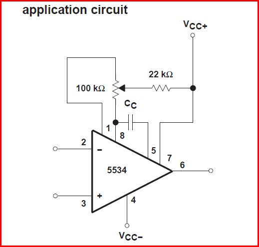

Only just seen your post...
The multiturn pots are used as an offset null arrangement on the final NE5534 opamps in accordance with the standard arrangement for that device. They are used to trim the output to exactly 0.000volts DC with no disc playing... and even that is not as straightfoward as it sounds as the slight AC hash and noise can give an (slightly) incorrect reading on a DVM. A 'scope is perhaps best or failing that a simple RC filter made on the end of a phono plug to use with a DVM, say 10K and a 0.1uf or higher non polarised cap. Its just nice to get it right 🙂
Opamps vary in the connection details and in the polarity required and also in the recommended value of pot to use. If you tell us what you are replacing then we can advise better.
The holes where the pot is must not be connected to anything or "joined up".

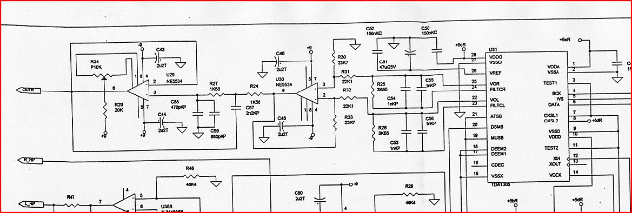

Just to clarify... the picture in post #36 was one I grabbed off the web, it's not my player which kept and used the mutiturn pots. The way I marked the opamps is correct, AD845 for output buffer and the OPA604 straight from the DAC.
The attached picture is of the Micromega Stage 2 analogue stages and shows the pot on the final NE5534. Also shown is the 5534 and 845 offset null details as taken from the IC data sheets.
Keep the pot "as is" and initially just test and see what the DC offset is as I described earlier and see if it will adjust to zero. If it will not adjust correctly then the value of R29, that's the 20k resistor that goes to the wiper of the pot can be reduced right down to 390 or 470 ohms. Then adjust the offset again for zero.

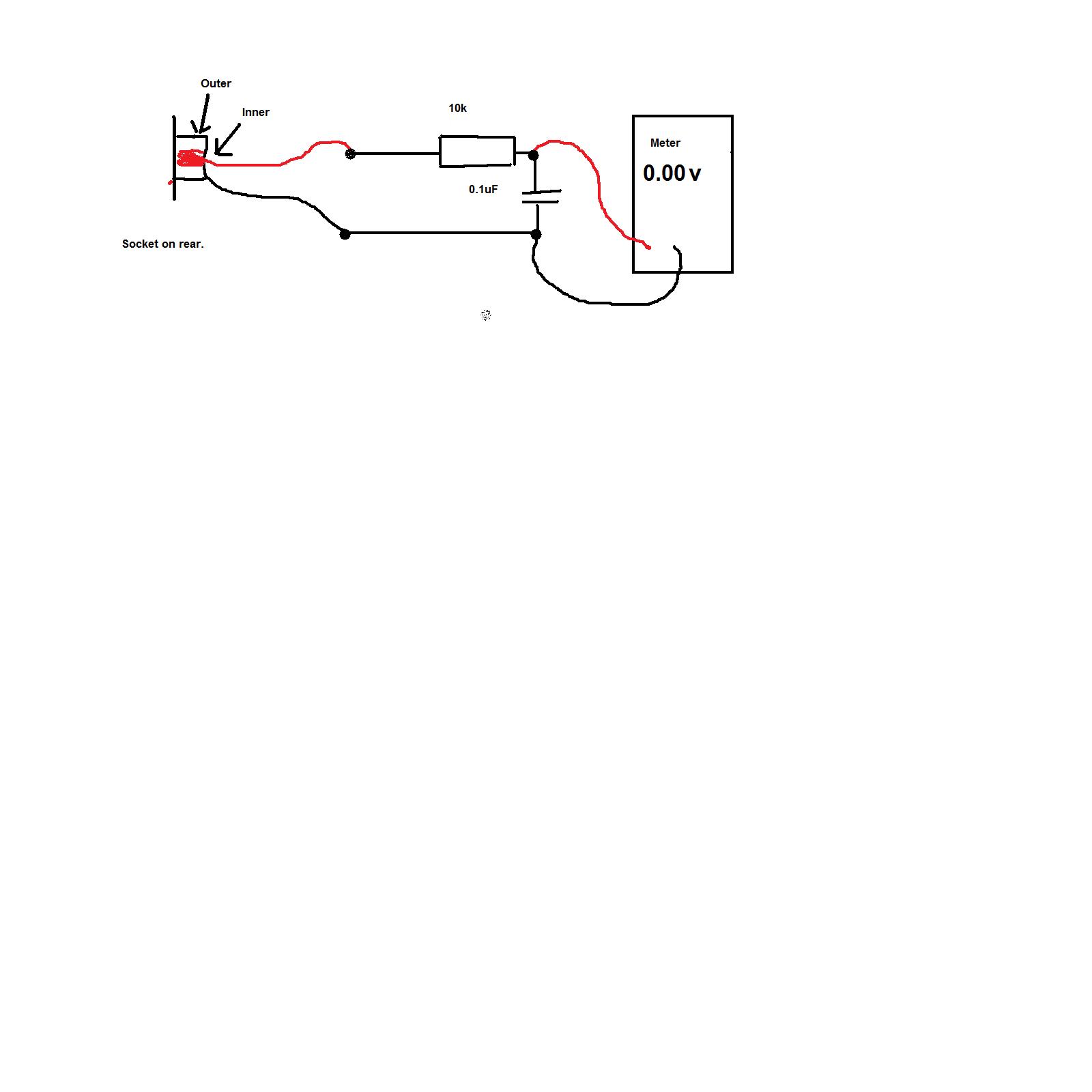

Pleased you have successfully swapped the opamps OK. I found they made a significant difference to the sound quality too. Your experiments with the shielding are interesting... I would always say listen for a long time over several days whenever you do any mods as sometimes your expectations get in the way. Its appened to me many times.
To measure the offset accurately you actually measure at the phono sockets outputs on the rear. You can measure it approximately without the filter, just have the unit in stop mode and with your meter on its most sensitive DC voltage range connect the - lead to the phono outer (which is audio ground) and the + lead to the socket inner. The reading should ideally be near zero.
The filter allows a little more precision in removing the small amount of hf noise present that can "upset" the reading on the DVM. The filter is just a resistor and cap of say 10k and 0.1uf connected in series. Not critical at all. Connect for each channel in turn and adjust the respective pot for each to give zero volts.

I've fnaly got myself a DVM and have managed to check the outputs, they both read 0.1 microvolts (I think - does that sound right?) so I didn't bother to alter the pots as I figured thee reading was low enough...I did it without the cap and resistor you suggested.
It sounds too good tbh... it wasn't in standby was it ? 🙂 Most DVM's wouldn't resolve something so low too... hmmm.
When you have the top off and with the player in stop mode (not standby) measure on DC volts from ground to pin 6 of the AD845 buffer... which is the output.
