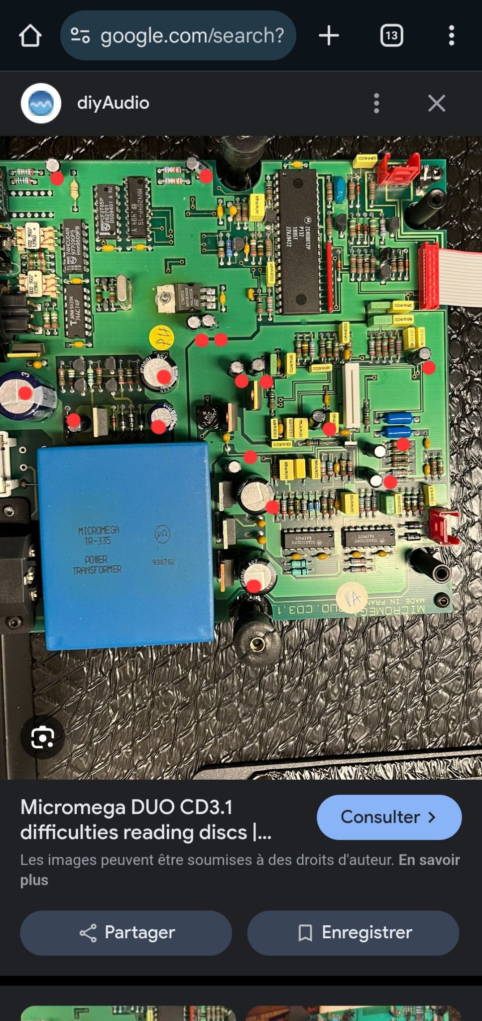

Well, as a precaution, I changed all the capacitors and I think I was careful, but in the end, counting all the old capacitors I changed, I ended up with 19, whereas there should only be 18.
I ended up with:
1000uf 25v x3
3300uf 16v x1
220uf 63v x1
47uf 25v x12
33uf 35v x 1
100uf 25v x1
So I'm looking for a list or at least detailed photos to find the intruder. It's possible it came from another device I repaired, but I'd like to be sure which one it is.

Sorry if my messages appear in French or are poorly translated, my corrector is not very practical.
There is a picture earlier in the thread that shows the PCB and I count 16 ecaps. Either way you should be able to count them on your pcb and see if you missed any.
look carefully, there are 17 in the photo +1 on the small front card, my problem is that when tidying up my workbench after changing them I found myself with 19 capacitors, that's why I'm trying to find which one is the intruder in the list I gave you in my last message
