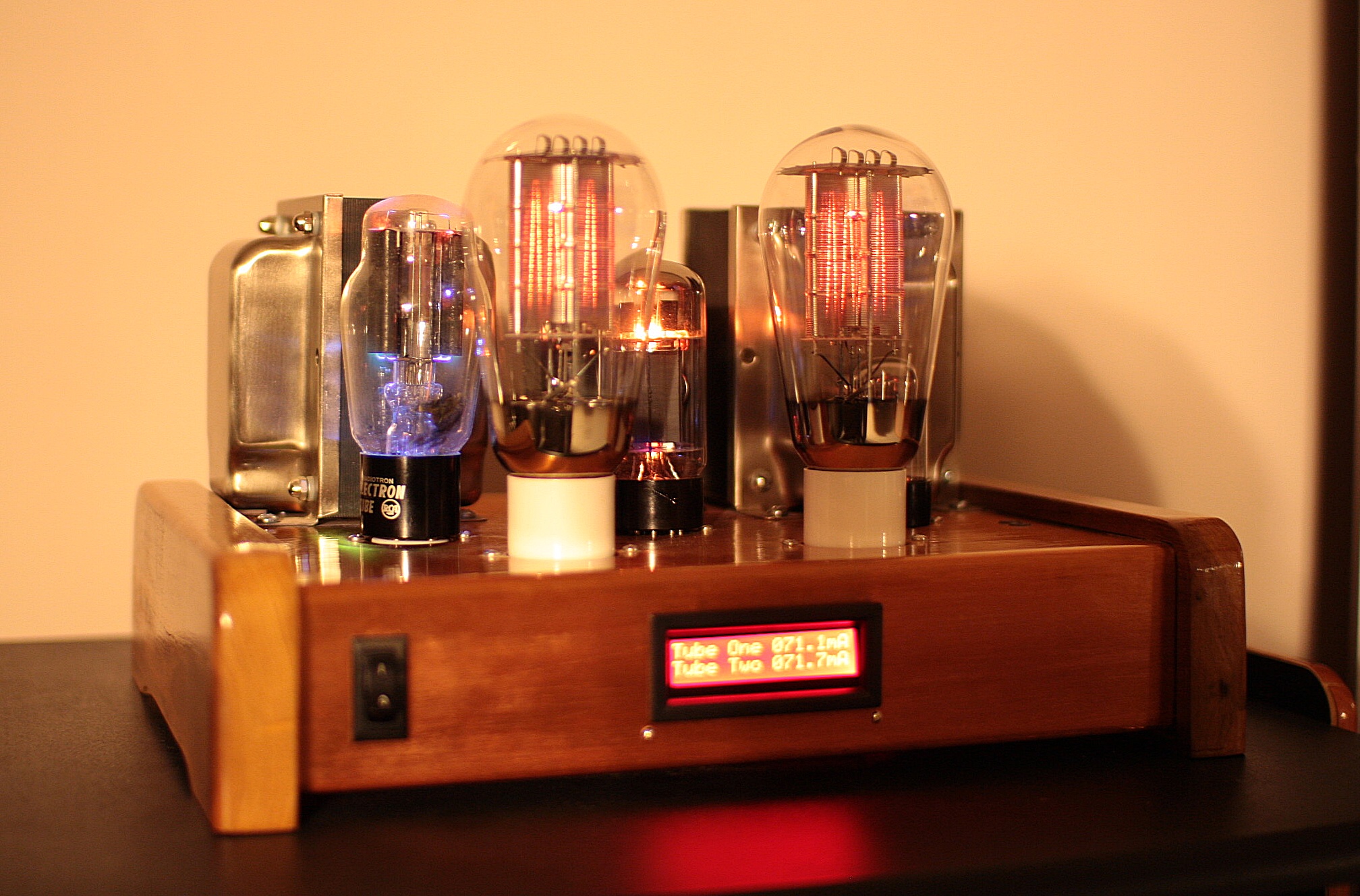

PIC 16C773 using it's 12 bit A/D converter with 8x oversampling and two INA122 opamps as a custom two channel ammeter. The INA122's are at +400v as I have a common filament circuit for the 300B's and it's the only place I could measure the separate current through each tube.😱 Been running for 5 years without a hitch. Could add a relay and shut down if one of the tubes runs away, which would be an incredibly good idea as one always does after about two years.

I managed to extract a very clean sounding 20 watts out of a single 6AS7GA with the sections paralleled in SE mode. I can tell you that the tube will melt if you try this without "digital augmentation". How does it work?
The tube amplifier itself looks pretty normal (board on the right). It isn't quite what the average SE amp builder makes though. The smaller tube is a 6EM7 in a two stage SE triode amp. Its main purpose id to develop about 300 volts P-P of drive for the output stage. The output stage is a cathode follower using both sections of a 6AS7GA, or 5998, or even a 6336A in parallel. Why a cathode follower? The cathode follower is relatively immune to ripple on its plate (high PSRR). The amp was tested with a normal bench power supply, and makes about 8 watts in SE mode with a 175 volt power supply and a 600 ohm OPT. This is limited by the dissipation in the output tube.
Now what if we created a variable power supply and modulated it with the audio signal. Set it up such that the output tube sees a constant voltage across it for all signal voltages. It turns out that the voltage dependent nonlinearities inherent in the triode, goes away and distortion nearly vanishes. This is not new, in fact it was patented by Ross MacDonald in 1957, and was the basis for several succesful small signal designs like the SLCF and the front end of many Tektronix scopes. A thread about it is here:

The technique is simple, you just need some DSP power to sample the incomming audio signal (I tapped the plate of the driver tube) and control an SMPS such that it's output closely follows the audio signal. Microchip makes some dsPIC's for SMPS use that do all the hard stuff in hardware inside the chip. The software just sets everything up and loops forever. There is ample processing power left for houskeeping like bias control, current monitoring, and even tube condition monitoring.

OK, you asked for it. The witchcraft, magic, and smoke containment is all in the modulated boost converters. The rest of the stuff is pretty straight forward. First I will cover the tube amp since it is the easiest to understand. Both the amp and the digital controller share the same ground although this is not obvious in the schematics. In fact during the debug sessions I found I had to run a short fat copper strap between the ground planes in the two boards. The power supply ground is soldered to this strap. This was needed to solve voltage transients and general instability in the boost converters. Everything worked great until the converters approached max voltage. Here there are 450 volt P-P square waves at 1 MHz
See the amp schematic.
The input stage is the small section of a 6EM7. It is a typical gain stage with LED bias and resistive plate load. No processor control is provided, or needed.
The second stage is a grounded cathode amplifier with a CCS load using the big section of a 6EM7. This tube and topology was selected for its ability to swing the plate from 30 volts to 450 volts. I can get over 350 volts P-P ov clean drive from this tube. 6EM7's are highly variable even between tubes of identical construction. There are at least 6 different constructions too. Gain in the first stage, and bias voltage in the second stage vary a lot. Select a pair of tubes with similar first stage gain. The bias for the second stage is microprocessor controlled. R20 and R28 bring bias in from the controller. C12 and C22 form a low pass filter to remove any noise that sneeks in from the boost converter. R8 and R9 (R7, R17) form a voltage divider to reduce the plate voltage to about 50 volts to travel to the logic board. 50 volts or so is safe for the ribbon cable and the SMD parts on the controller. This signal will be split to two circuits. One measures the DC plate voltage for adjusting the bias. The stage operates at a constant current fixed by the CCS, so the bias voltage sets the plate voltage. The other feeds audio into the high speed ADC inside the processor for modulating the boost converter.
The output stage consists of both sections of a 6AS7, 5998A or 6336A paralleled, but with independent bias adjustments controlled by the processor. These tubes are notorious for mismatched sections, so selecting a tube with similar gains and reasonably close bias voltages will allow for the most power output since both sections will share more equally. As with the second stage R26, R34, R30 and R33 brings in the bais and the caps remove noise. R3 and R4 allow for cathode current measurement by the processor. One section is cutoff (max negative bias) while the bias voltage for the other section is determined. Then the process continues for the other section.
The output stage provides all of the current gain for the amp. It operates with a constant DC voltage across it. That voltage depends on the tube in use. Optimum was about 90 volts for the 5998A. The first and second stages provide all of the amps voltage gain.
