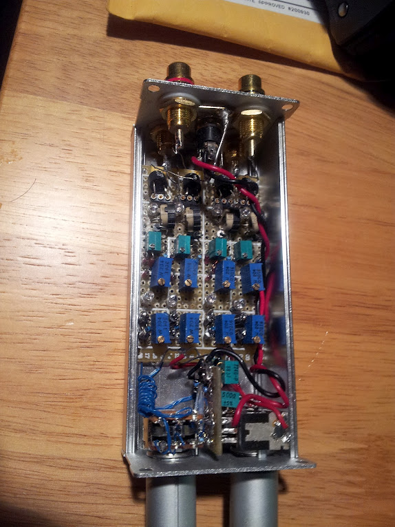

You can try direct variable DC voltage to control the LDR led to make it simple.
I had desigh a ciruit used variable DC voltage to control the LDR led and get good
result. I had try many diffrent ways since last year,which included fix voltage
at 5, 3.3, 2.8, 2.5 volt, LM334 CCS, 24 step switch all need mach LDRs and I don't like that.
Then few months ago, I come up with the idea of direct used variable voltage
to control the LDR led with excellent result.
The circuit I desigh can drop in most LDRs,and easy to calibrated the channel balance to less than 1 DB . The ciruit had four trimmer used
for each LDR calibration.
first trimmer for 30 ohm to 100 ohm range adjustment, second one
for 100 ohm to 2K ohm range,third one used for adjusted of 2K to 80K range,the last one
for adjusted from 10K to over 100K. I can adjusted the resistance curve
easy, for example the shunt LDR I can adjusted the value to about 20% of
maximum value and series LDR to 80% of maximum value when set the
voltage control pot at the middle, the shunt /series LDRs act like A type
pot.
