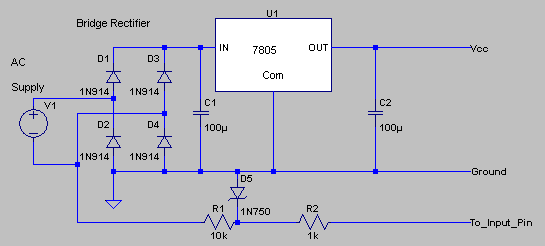

If it's running off mains power then you could put an input from the ac secondary of the transformer (use an AC plugpack/wallwart) and count waves. AC power, while not perfectly accurate cycle/cycle, has a very tightly controlled average frequency (lots of clocks depend on it 🙂). Shouldn't need much more than a zenner and a couple of resistors to condition the signal to suit the micro.

I've drawn up a schematic of what I was thinking...
The 1K resistor R2 is there because the voltage on the zenner gets to -0.5v (1 diode drop) relative to ground and some chips don't like negative voltages past a certain current. Adjust value to suit...

Hi Duncan, that looks great. So my question is when the zener ceases to conduct every cycle, would the input pin be floating enough to cause random toggles? Should there be a resistor to hold the pin low during this time? Thanks!
Looking at the diagram I can see there might be an issue, I'd also put a 10k from what's shown as the '-' pin on the transformer (it's ac obviously but you get the picture) and ground to ensure the transformer voltage doesn't float when the diodes aren't conducting.
Most PIC micros have hysteresis on their inputs and should have no trouble but you can also de-noise the signal in software by waiting for the pin to be high (or low) for an amount of time before acknowledging the change of input state (and incrementing your 'clock' counter).
