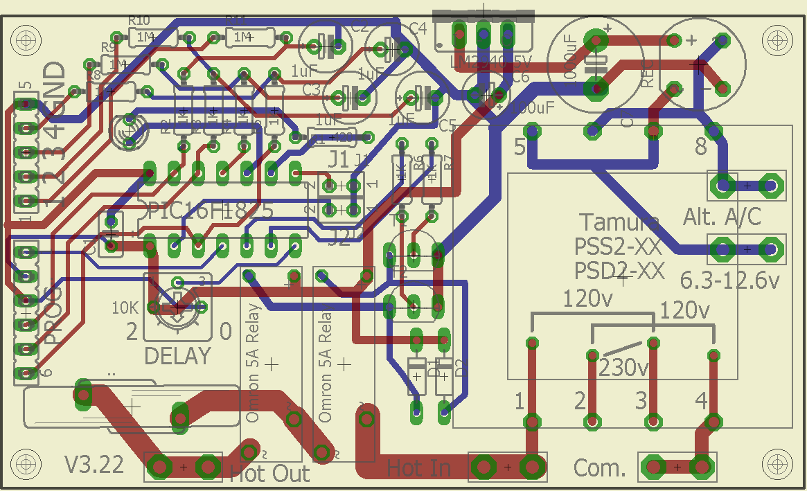

I made up these little boards using a PIC16F1825. It does not adjust the bias but monitors up to 4 tubes and tells you if any tube is 5% out of balance and shuts down the amp with a 10% imbalance. So for push-pull it compares the pair of tubes constantly looking for imbalance.
The main idea here being to shut down the amp if a tube starts to run away
The 16F1825 has a 1.024V internal reference for the A/D converter so you just need like a 6 ohm cathode resistor to use to measure the tube current. At $2.00 each these little things can really do a lot.
