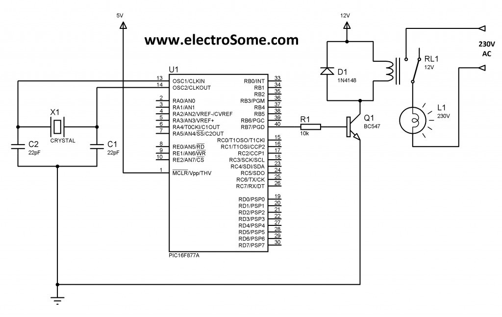

So in @rayma's example above, that 1n4148 is used as the protection diode for the bc547, right? So when the coil's field collapses (i.e. after the current pulse), the momentary voltage spike will cause the diode to conduct, and put that temporary big voltage on the +12v rail (instead of the transistor).
But couldn't parts on the +12v rail possibly be damaged from that brief voltage spike? For example, that +12v rail likely has a bulk electrolytic capacitor on it. Aren't we just moving the problem around? Maybe we also need a small (1nF?) high voltage cap to ground on that 12v rail, since the high voltage spike will be short enough that the small cap can act like a short?
Side note: in researching this, it seems like I've typically seen Shottkey diodes used as the flyback protection diodes?

Hi. When relay coil is turned off, voltage is removed , relay coil generates voltage spike of opposite polarity , and only then the mentioned diode will conduct, and that spike is limited to roughly 1V . So with 12v supply to relay transistor is getting close to 13v spike.So very simple and effective. Also in place of NPN you can use N-Mosfet like 2n7002.

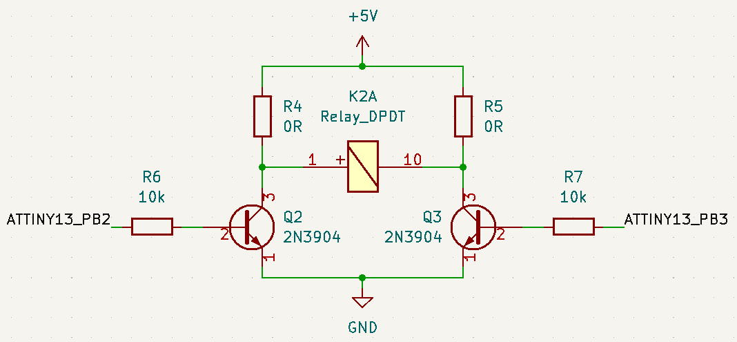

For the single-coil relay, if I do something like this, are the protection diodes still necessary?
The MCU IO pins (ATTINY13_PB2 and PB3 in the schematic above) will be kept low. To change relay state, one MCU pin will go high temporarily, to give the relay coil a path to ground. After the current pulse to change relay state, the NPNs' bases will once again both be low, making the transistors look like an open circuit. So won't the flyback voltage go through the 0R resistors to the +5v supply?
In the 5v case, I would actually omit the 0R resistors. I put those there as a placeholder, thinking that I can actually use a 3v relay, and a 3v3 supply, and those resistors can drop the voltage a bit from 3v3 to 3v0.

In the schematic I posted above, for the super duper conservative design, are flyback protection diodes still needed? And where would they go?
I realized that schematic I posted will almost certainly not work! When only one transistor is turned on, current will flow almost entirely "straight down", as the path through the coil will have higher resistance. So little to no current will flow through the coil, certainly not enough to reliably activate the coil.
I think I'd need four total transistors to make this work, basically replacing those 0R resistors with transistors, and then it's obvious where the flyback protection diodes go.
Your schenatic in post #8 will not work because 0 ohms resistors shorts the coil, and when you turn on any transistor, it will try short circuit power supply with know consequences. Because of this h bridge is designed, where 4 devices needed and additional circuitry to control them. Much more simple is relay with two coils .
