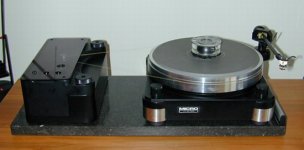

It is similar to this (picture), with alu-platter.

About $ 350+ = "cannot resist" - price.
Condition: worn, but not bad...and modified by an amateur...
Luckily it seems that the mods are easy to rectify, (in the process).

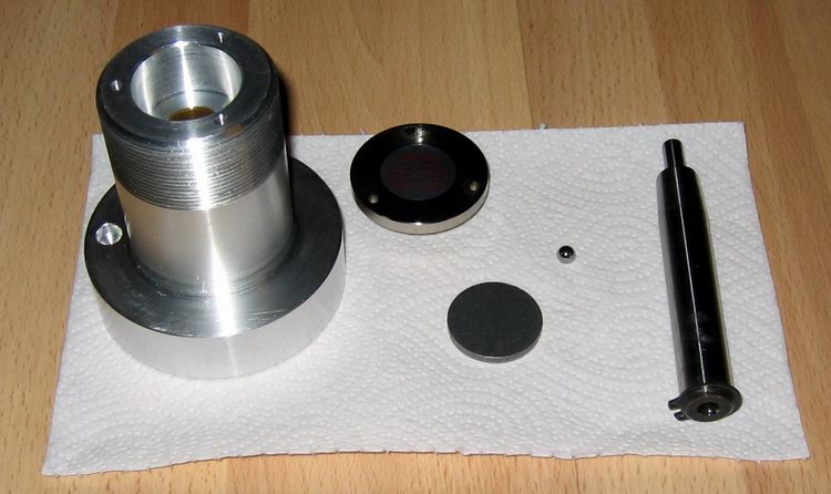

My M-S have now been in "atoms", and rebuit, working perfectly.
Damper-feet have been greased with new silicon-grease(Molykote-111), main-bearing has been cleaned and refilled w. Mobil 1 synthetic automatic trans-fluid.
When giving the platter a slow hand-spin, it runs for several minutes!

About oil...
I have also seen this at Teres...but I do not think the Teres-bearing have the same fine tolerance as Micro Seiki.
The Teres also have a speed-checking strobe to control the motor-speed.
And reason for ATF fluid, is that it is usually less aggresive than gear-oils, and have less useless additives than motor-oils.

think you'll find the Teres/Redpoint/Galibier bearings have finer tolerances than the MS. Teres does't use "thick" oil to take up the slack and Galibier/Redpoint use thin oils.
the Teres bearing can take a few hours to a day to sink properly into the bearing so fine are the tolerances.
I assembled the bearing dry-wiped, (but not de-greased), and could not get the AIR out!!!😱
That is a tight fit in my book....

check the Teres site for instructions on how to fill their bearing and it might help you in getting the bearing seated. It needs to be degreased before assembly otherwise it may not seat properly.
No problem
Under the label that tells you ; "This bearing is hermetical sealed", there is a vent-screw with o-ring.
