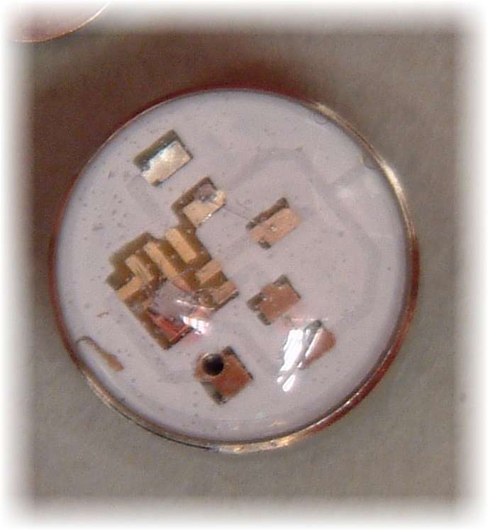

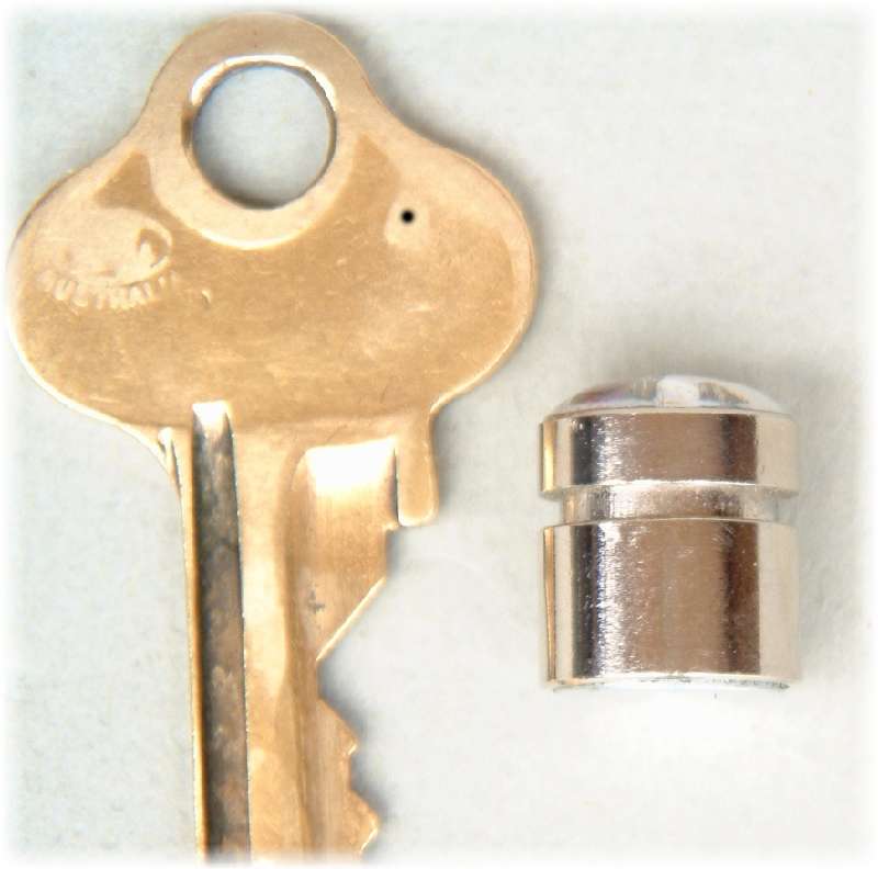

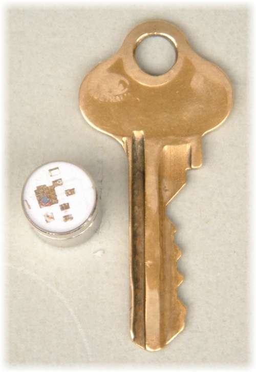

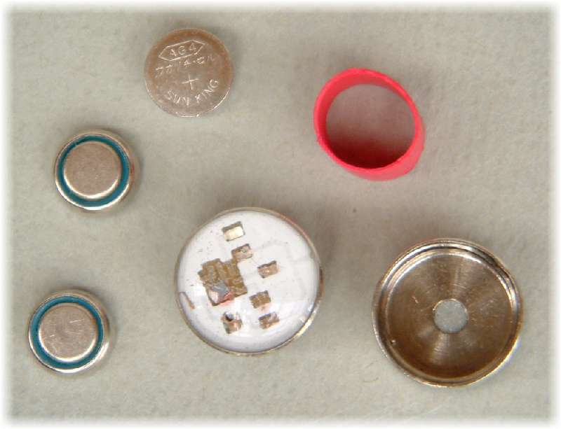

Anybody have any info on this micro camera ?.
It measures 10mm diameter x 15mm long, runs on three watch cells, and has a magnetic base for fixing to ferrous surfaces.
I believe that it is wireless coupled, has IR illumination and may have a PIR for sensing.
Eric.
See the attached photos below....

Looks a heck of a lot like those toy LED flashers that are the current rage. Runs off 3 watch cells (need the voltage for blue and they use cheap 1.5 volt batteries), have a magnetic base (and also a metal piece) so that you can attach them to clothing, and looks pretty much like what you have.
If it was a high tech camera, it would likely only run on 1 or tops 2 lithium batteries. You would be using Lithium batteries for the superior energy density. Hence you would have 3 volts per cell. If you had three cells, that would be 9V which would be too much if you wanted a low power design. CMOS image sensors run on low voltages as do RF transmitters, IR LEDS, etc.

Let's see a photo of the objective end: the lens barrel.
If this device is a wireless unit, there's no detail on the broadcast antenna. I've played with units that required a 9v power source, total device size 10mm x 25mm. This looks entirely different.

I am led to believe that the clear encapsulation is a suitable fish-eye lens.
In the near future, GHz+ spectrum analysis will be used to investigate more exactly what it is does, but until then it's purpose and origin is somewhat mysterious.
Can you give me any links to photos of these ?.
The cells are rated at 1.55V.
Eric.
It was solved a few posts ago....... 🙂
However, for interest sake, not only is it possibly to make a camera this small with RF output, but it is not terribly difficult. You would likely run off a single Lithium battery or two giving more room for circuitry. It would not likely be something you built in your garage, but If you did not need high resolution and could live with a very low frame rate, it could be done with off the shelf chips. You would need to do it with die in order to keep the thickness down. IR illumination would eat batteries really quick though.

I thought those were LEDs in the detail photo. Note the IC and lead "fingers" running to the LEDs. If the device is a camera, an array is required (CCD) as well as a means of focusing an image across that array . No lens, and she's just a photocell!
