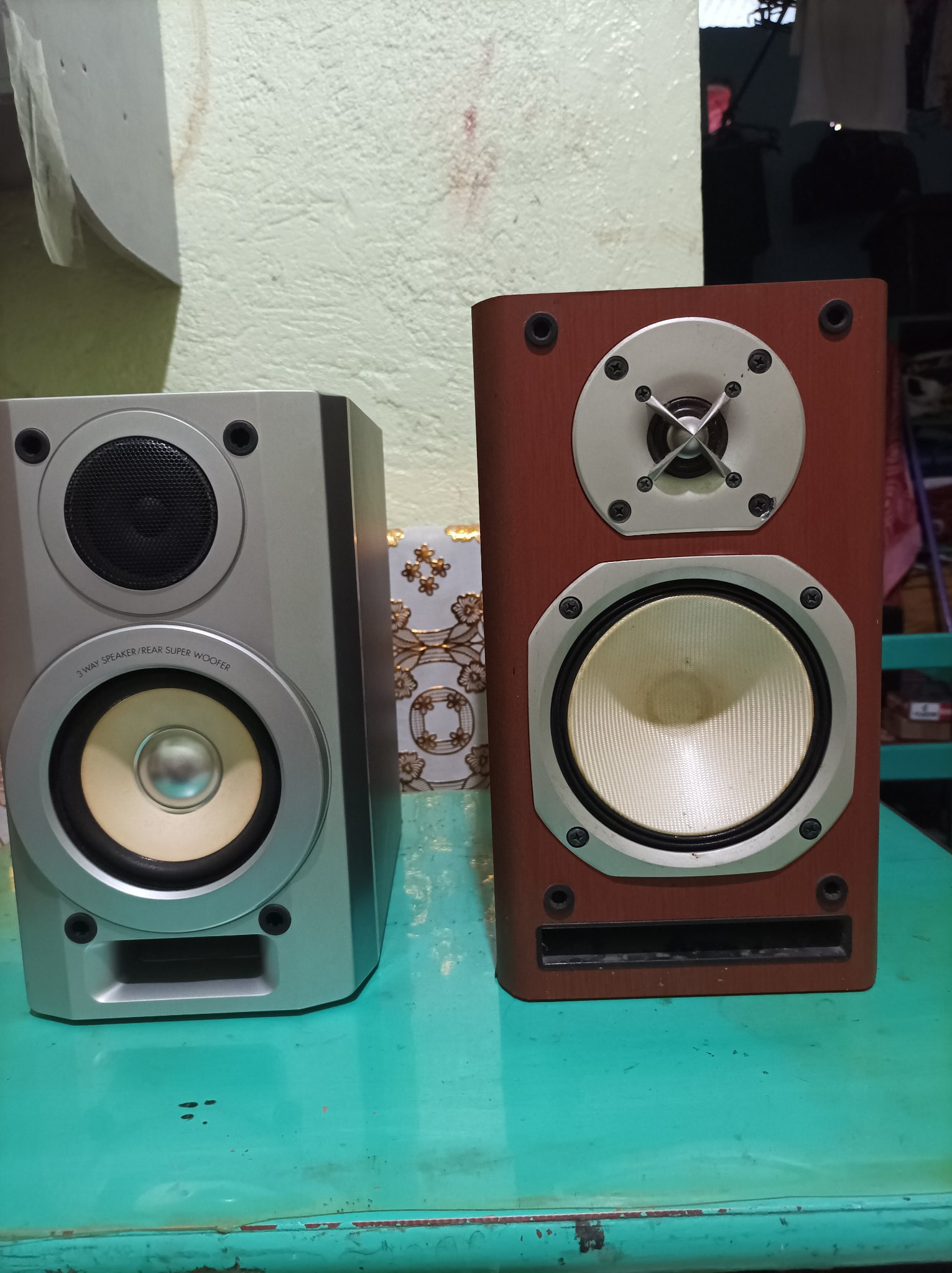

Hi all, is there a simple way to check if the tweeter of the Onkyo speaker is working? While listening to it, all I could hear seemed to be coming from the woofer, yes it does have some highs but to my ears the low frequency overpowers it. I've listened to a mixed of music material but they seem to have the same energy, not much coming from the highs. The highs is very audible (and evident) when listening from the Panasonic speaker.
The Onkyo is on the right.
The first thing I would do is gain access to the tweeter terminals, disconnect the connecting wires, and measure the resistance across the terminals using the ohms scale on a multimeter. You should expect a working tweeter to give a reading of somewhere between, say, 3 ohm and 6 ohm.

Thanks Galu, the pair of Onkyo's sounds lacking in highs to me. It just occured to me that this symptom could be a fault in the speakers, they are surplus items from Japan of course.
I do know that high frequency can be heard from the tweeters when you stick your ears closer to it but the Onkyo's sounds dead to me. I am not so familiar with these Onkyo types though, this is my first time hearing them.

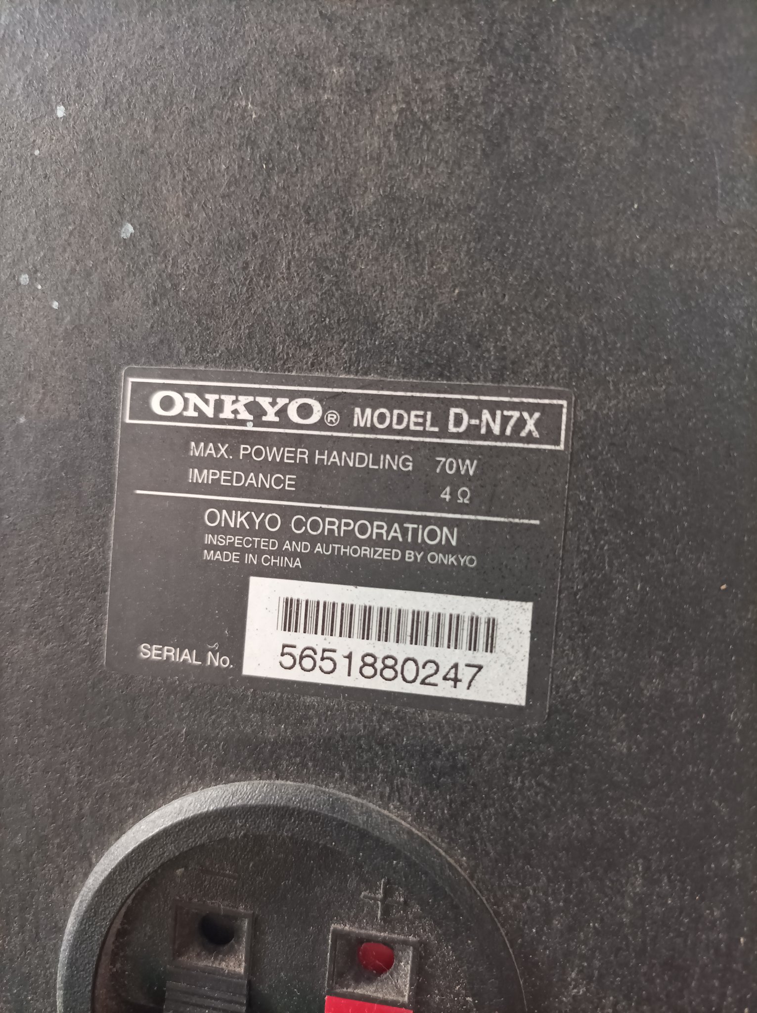

I have a pair of those Onkyo D-N7X. What intrigued me about them were the midwoofers. They are some sort of composite, synthetic one piece cones with very thin surrounds. It seems Onkyo was pursuing something along the lines of B&W's FST midrange drivers, but tried to adapt it to be a midwoofer. They used similar woofers in a variety of bookshelf speakers packaged with their mini systems and also in their very pricey D-TK10 flagship model.

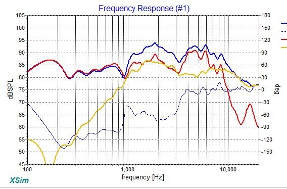

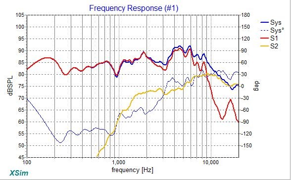

Now, to the tweeter problem. It's likely that you're tweeters are working ok. The problem is the tweeter sensitivity is too low. The first pic below depicts the raw responses of the drivers, showing the tweeter being drowned out by the breakup of the woofer. The "crossover" is just a 2.2uF cap on the tweeter. The second pic is with the cap in place. It does help protect the tweeter but obviously does nothing to help the overall response at high frequencies.
