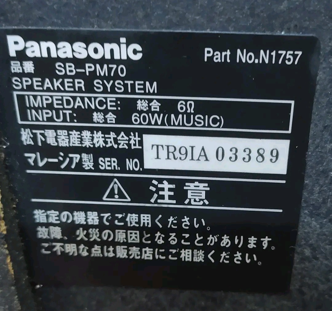

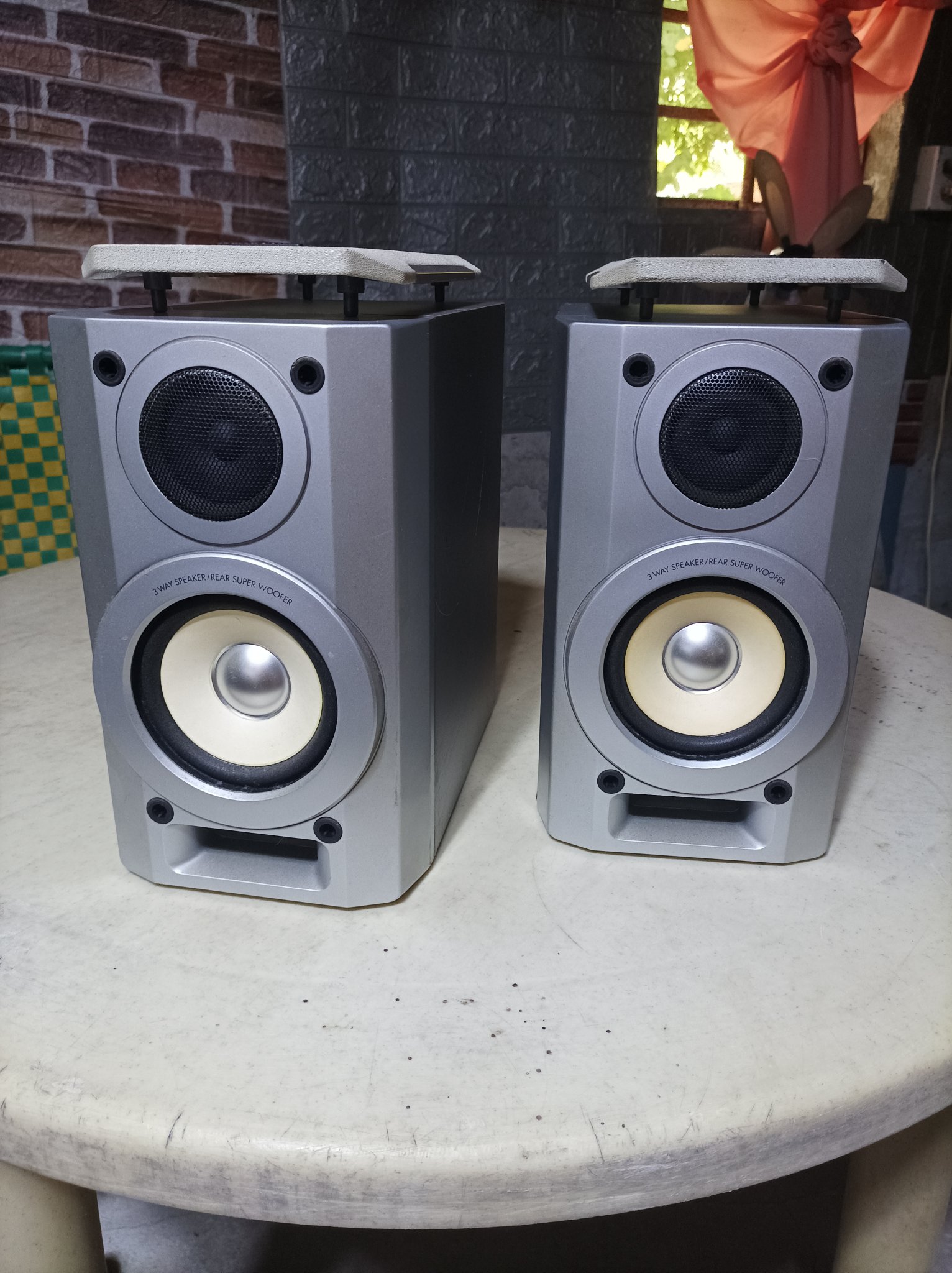

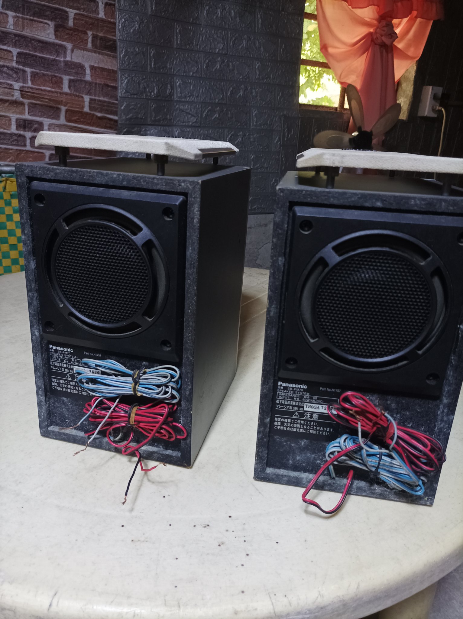

I bought these pair of Japan made surplus speakers. I intend to use it for my DIY amp. However I didn't realize that it comes with 2 pairs of wires. Is there a way to convert them for single wire use? something like parallel or maybe series parallel combination.
Thanks!

I'm guessing one runs to the rear woofer. Could you try to confirm that either by looking into it or using a meter. If that's not possible you might use a small battery.
When you have different woofers in parallel, they may partially cancel each other at frequencies where they differ.
The first things I'd probably do is determine the resistance of each to see whether you can safely run them in parallel. Check the front one measures resistance to see there's no high pass filter on it. Listen with and without the rear woofer playing and decide whether it has a similar sensitivity to the front one, meaning you'll hear a clear increase in bass, but not a very large increase.
This way you could consider using both at once, or even using one to make a 2.5 way.

My guess is that Panasonic actually used an active system for these and that the electronics unit, that came with the system, utilised 4 power amplifiers. Two channels for the woofer/tweeters on the front and then two channels for the 'sub' woofers on the back.
Quite how they would perform with the woofers wired in parallel is another question entirely.

Nico, that was my worry 6ohms in parallel will become 3ohms, I'm thinking of re wiring the tweeter and the front woofer in series and then connect them in parallel with the rear woofer. I do not know if this is possible though. I may have to take a peek inside I guess and see how the speakers are wired.
By the way the last image was a photo I've taken from the internet in order to show a clear model number (the same as mine).

You are ignoring the fact that you are bypassing the active crossover and also ditching the level adjustability of the sub. Instead you will get a bloated, booming upper bass and midrange.
