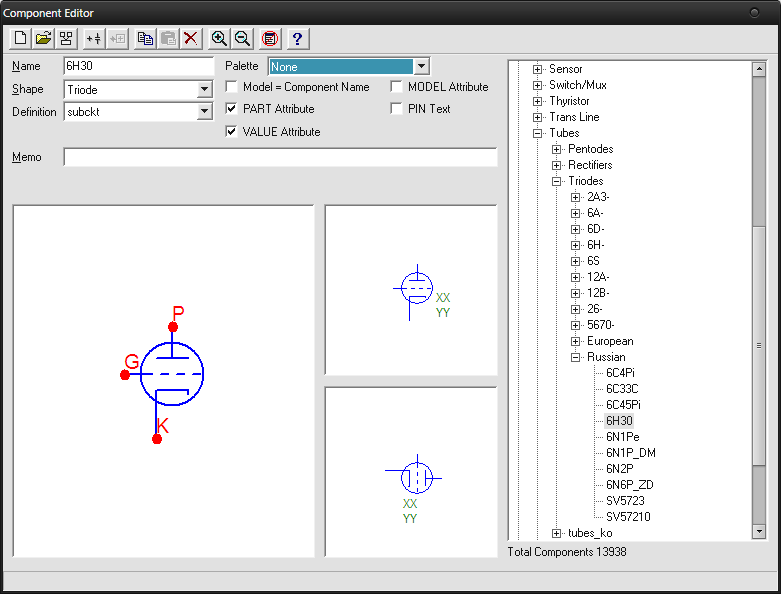

He wants to modify the parameters to those of other tube types. Best way to do this is to get the spice models and manually edit the params based on what is in the model you want to use.
Truthfully LTSpice IV does a much better job, is free and has no limitations on number of nodes or parts in a circuit being simulated. Lots of tube models all over the web for LTSpice as well.
Open tube.lib in MicroCap or a text editor and add this subckt to the library file.
.subckt 6H30 P G K
Gp P K VALUE=
+ {(0.3800825583m)*limit(V(P,K)*ln(1.0+(-0.02540430176)+exp((7.018331616)+
+ (7.018331616)*((15.85848193)+(-66.34009258m)*V(G,K))*V(G,K)/sqrt((27.2125877)**2+
+ (V(P,K)-(5.267363515))**2)))/(7.018331616),0,1e16)**(1.211856956)}
Cgk 6.3p
Cpk 2.4p
Cgp 6.0p
.ends 6H30
Save tube.lib. Now in MicroCap open the component editor. Windows ->Component Editor.
In the component editor on the right is the component tree.
Expand Tubes->Triode->then to whatever branch/group you would like to put the 6H30, like in my screenie below.
To add a group, click add group. To add your tube in a preexisting group, click add component.
Place 6H30 in 'name'. Use the drop down menus to select Shape->Triode, Definition->subckt.
Left click on each pin to set the node names/labels as in the screenie. Be sure that the dots are positioned at the end of each terminal.
Adjust the green XX YY positions to your liking. This is the text, part number/name (X1/6H30) that appears when you place the part on the schematic.
Close the component editor. When save changes dialog appears, choose yes.
That's it. 😉
