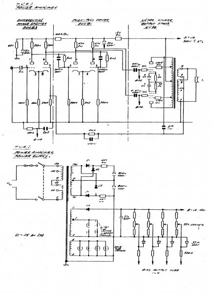

this is another digram of TVa 1

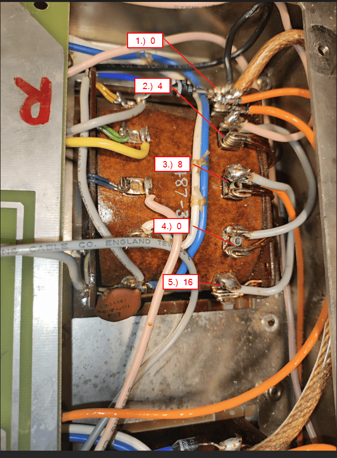

The photo on post 16 there is, on the right side, the section to output.
On tap 8 ohm there is a grey cable and orange cable, this one goes to + of loudspeaker connection?
Then follow the cable from - of loudspeaker connection to the trafo, it is 0
But if you look on the top of connrction you can see a big cable, maybe it is 0, check the way to binding post.
So the connections are in reverse mode.

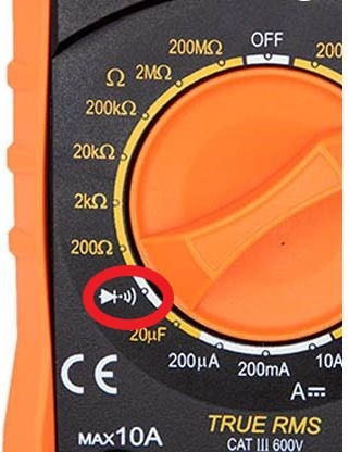

Ok I have spoken with my technican, he will make these beeper check he nows what you mean euro21......

My opinion is that if you move the cable from + binding post to the tap 4 ohm you can solve the problemIn the orginal manual is nothing mentioned about 4ohm application ?
Walter
I'm not so sure. The second winding will not be used at all if you do that. The "4-8" section and the "0-16" winding must have the same number of turns as they are currently connected in parallel. So I think they are both "4 ohm" windings.My opinion is that if you move the cable from + binding post to the tap 4 ohm you can solve the problem
