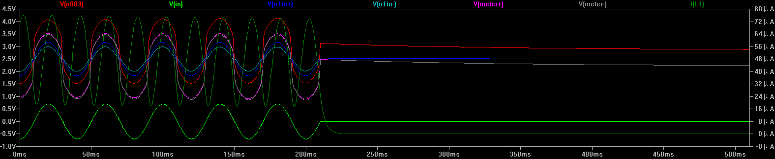

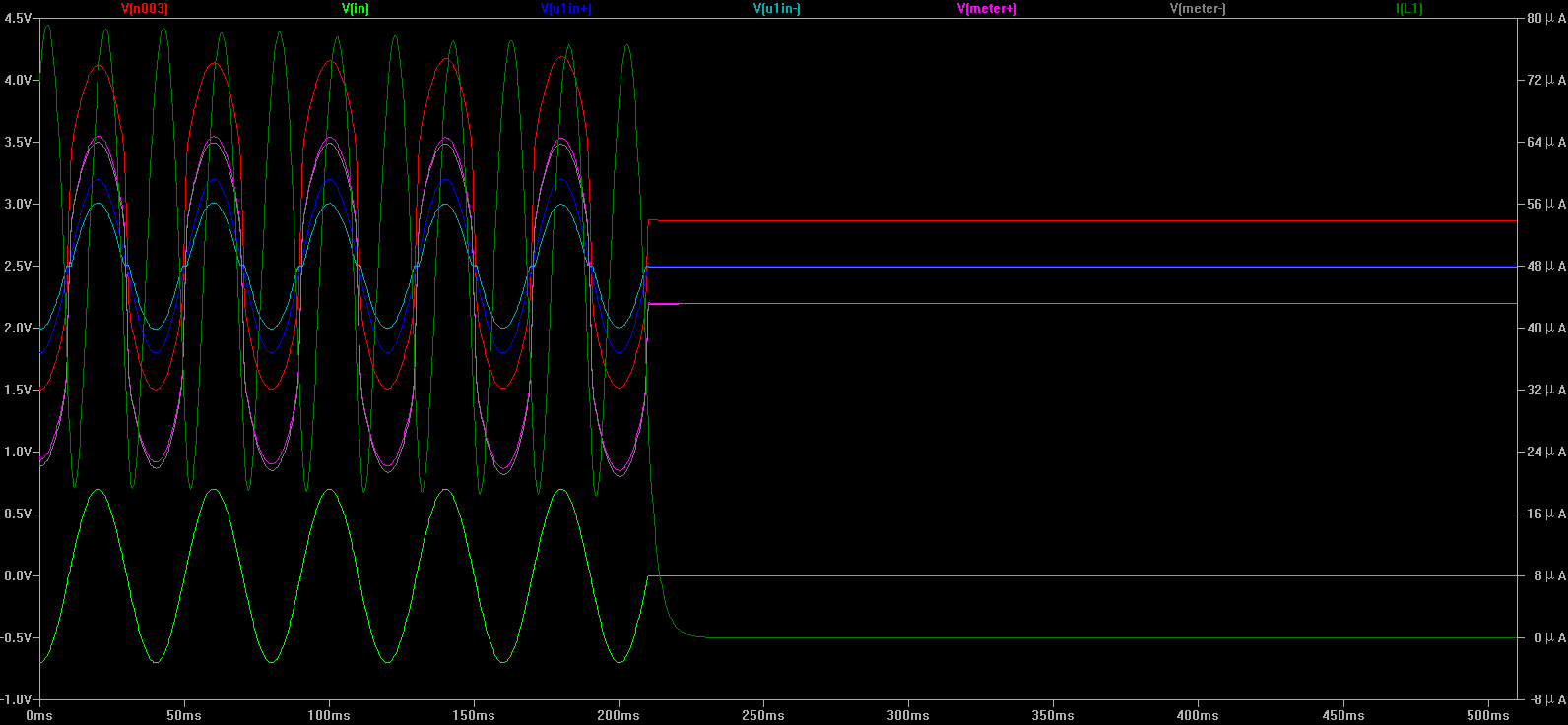

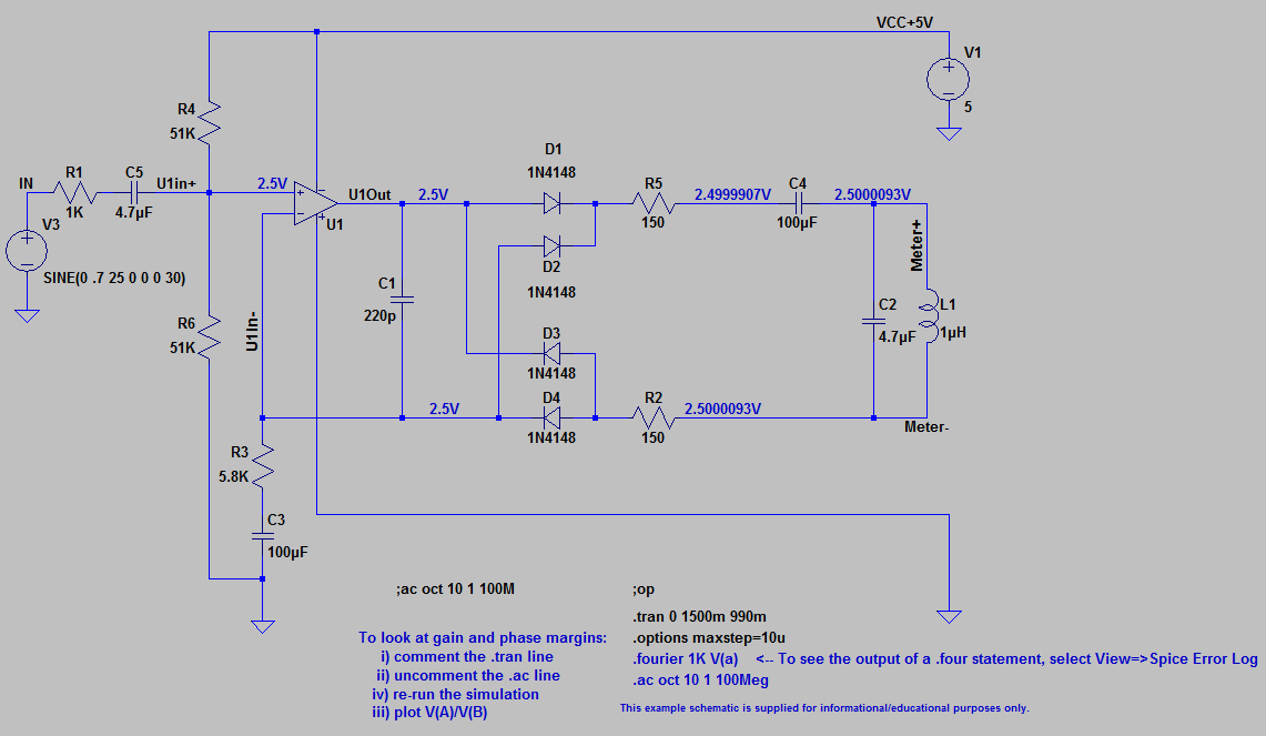

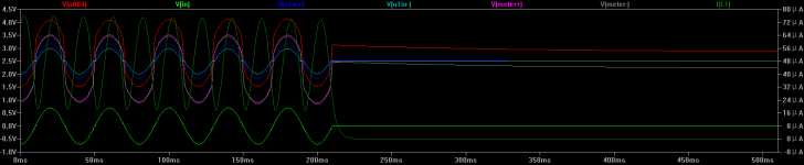

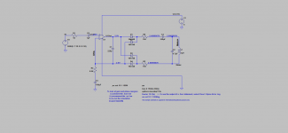

Recently I have read Michael Fearnley's article about vu meter driver circuit at the Objective Sounds website, and found it very interesting. I then simulated it with single rail power supply, and assembled the circuit. However, the actual circuit is not working as expected. There is not signal at the meter terminal. Can somebody help to point out where could I go wrong? Thanks a lot.

hi Sajti, thank you for your suggestion. Could you be more specific where to put that cap? Or maybe post an example circuit. I am lost here why i need a cap to block the DC in the feedback path, because I have not come cross such a circuit. Please enlightening me further.
I see on Your picture: C3 is the mentioned capacitor. Sorry, I just checked the original schematic. It will be OK with the divider, and C3.

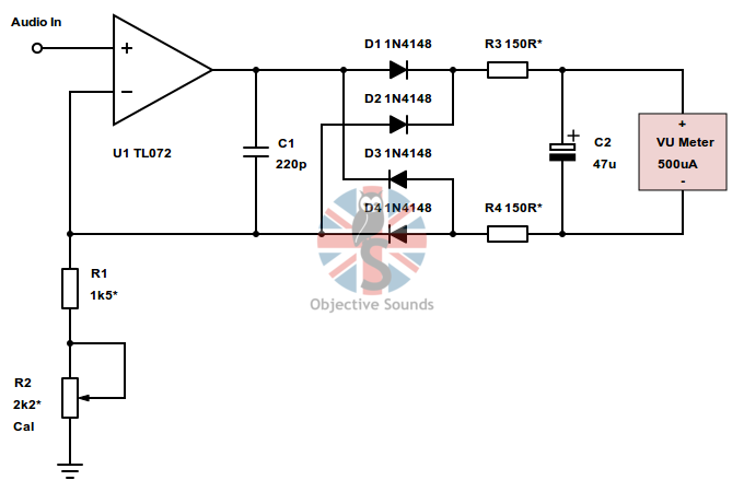

....Michael Fearnley's article about vu meter driver circuit at the Objective Sounds website....
It would have been kinder for all to link to the article you were reading, so we would know what you were talking about, and spot possible confusions.
Driving VU and other AC Meters - Simple High Performance Circuits
His "VU meter" circuits *omit* input and power connections. They do not work as shown.
His Fig 8, "Universal Volt-meter with selectable...." *does* have the input and power and bias connections completely detailed. Use that power/bias scheme to power-up the VU meter plan. The input needs a resistor to the C3 C2 node.

I see you are using LTspice. Here I attach the simulation file for you to play with and if possible, feedback your valuable comments. Thank you.
View attachment VUmeterDriver_SingleRail.zip

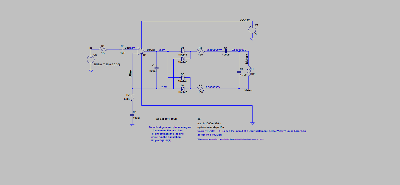

thanks for your post. Please could you point out how to make the circuit work? The simulation file is at the below link.

For lack of any other great need, copper oxide rects have vanished from the market. Ge diodes are a poor replacement. Your higher-Z driver in the other thread is a good simple hack. It does not give proper damping for true VU meters, but you won't get that from low-cost meter movements anyway.
Hi Everyone,
I thought I'd contribute rather late, but contribute nonetheless and say that the circuits shown are mainly conceptual and are shown in their simplest form (i.e. without AC input coupling/DC decoupling) and assume that they will be connected to a low impedance (at DC and AC) source.
I will shortly modify the article to show this as I have been receiving a fair few e-mails from people who have built the circuits as shown as standalone units and in some cases haven't even referenced the input to ground.
I didn't think at the time of writing that people would be building them verbatim and without the peripheral components necessary for them to be operated as standalone units.
Cheers 😀 !
