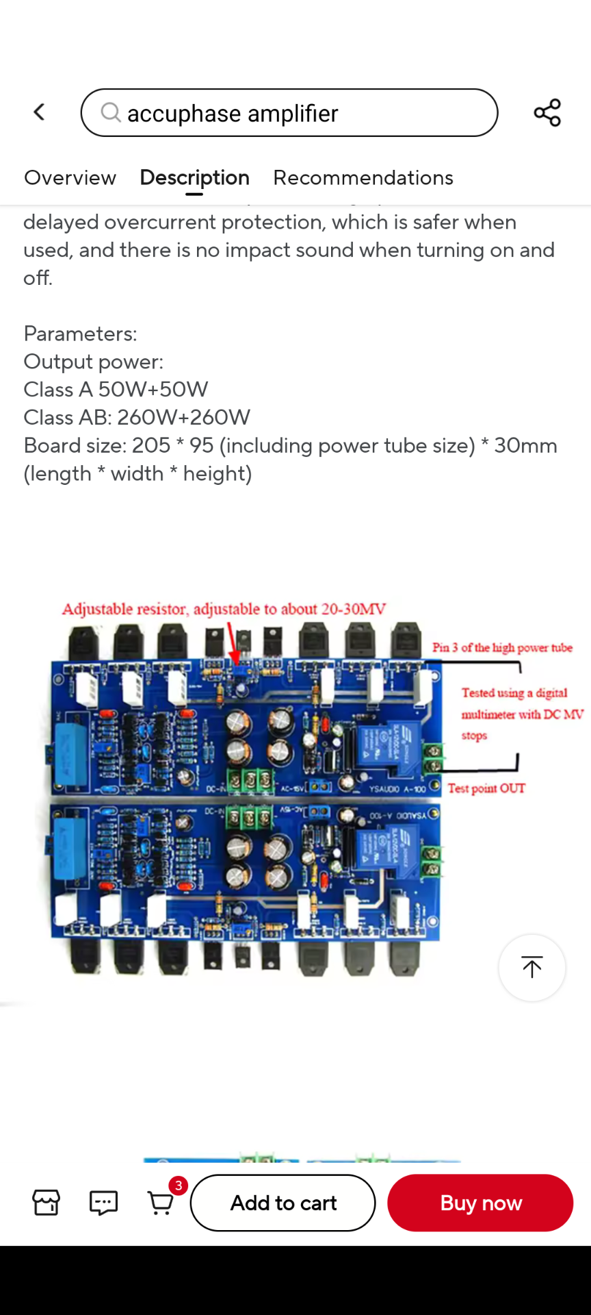

Calvin,
I am building a 6 ch amp with the Rev2 boards. How would you suggest to approach a power supply for all modules together? I won‘t be needing more than 50w/8ohm from each (actually MUCH less on four of them). How about regulated supplies or choke input (or small input cap + choke)?
Calvin,

Where are you finding all of the revisions of the boards? I am only seeing the version 5 videos and not an schematics or directions for the other revisions
the versions prior to the infamous Rev_5 can be discriminated by their Layout.
The former versions had 3pcs TO126 transistors mounted in the middle of the upper edge of the PCB on a common cooling track.
Rev_5 moved the driver transistors to cooling fins close to the output transistors.
And here´s Mr. Beeny´s thread and video that started the uproar: NEW L12/2 version 5. I have just received a pair of these amplifiers, I stopped testing because the boards are unstable
And here´s My website
jauu
Calvin
