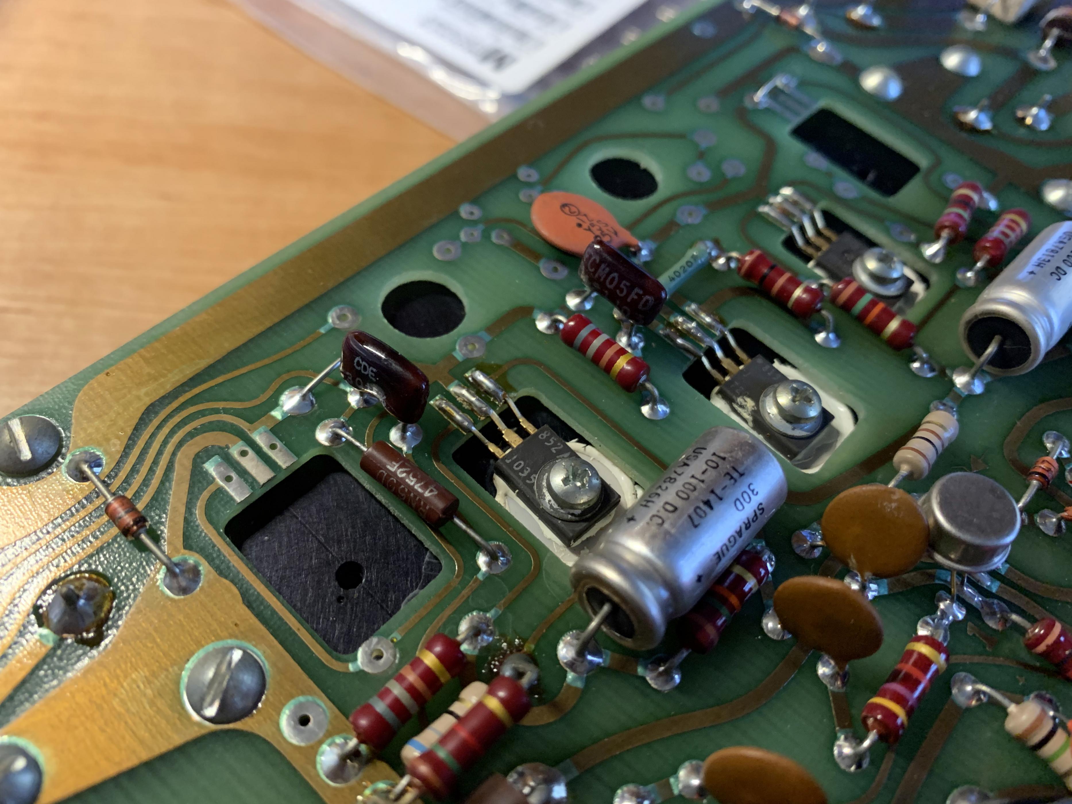

I'm in the process of restoring a 40+ year old un-molested power amplifier. It works, sounds great and has almost no DC offset on the speaker terminals.
I found two mica capacitors (30pF and 120pF) both of which have a dark spot in the middle. Not sure if that is a burn mark or just color aging with time.
Question - do mica capacitors degrade with age or is this due to heat and I need to replace them?

Mica capacitors are one of the most stable materials for capacitor dielectric, it shouldn't be easy to make those parts fail in that kind of applications. The brown part you say is cause they are dipped in colored epoxy/silicone resin and then are made to drip the excess

Thank you for your explanation re epoxy/resin. I will leave them in place and just focus on replacing the bead tantalum and electrolytic capacitors.

That power amp appears well built, who is the manufacturer?
If it's working well I'd be tempted to leave well alone.
This is a BGW-250D pro-audio power amplifier from the early 1980's. It is very well built and in great condition inside.

The only thing I'd do if it were mine would be to clean the flux off the connections that were made (power transistors, wires) after the PCB was mounted to the heatsink.
Bit of isopropyl, and a toothbrush, and it'll clean up beautifully.
You see this so often on boards. The stuff that was done in the wave soldering machine is pristine, because the board goes through a wash afterwards. Then there's those last few connectors or pots or what-have you that are put on by hand afterwards, and they're a filthy mess.
