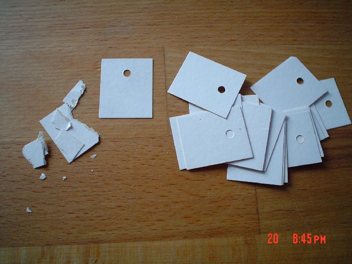

Has anyone ever seen insulators like these, and/or know their name ?
It looks like a very thin layer of Mica covered on both sides with something chalky, the outside has a plastic feeling.
I stumbled across some obsolete devices again, the insulators came with them in the bag with Japanese labelling.
Before my time ? :clown:
