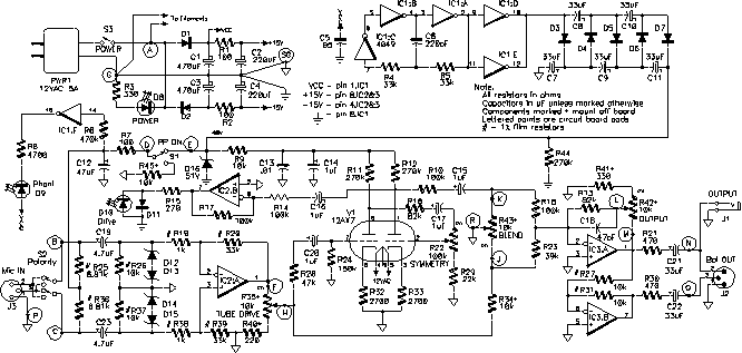

...here's that lovely £60 diy mic-pre.
There has been loads said about it on the net; so see what people say.
Better still; just order a pair NOW, with your plastic.
Couple of hours soldering; gets you a valve based mic-pre with op-amp front-end; that you would be hard-pushed, not to know didn't cost $1000 ( serious ).

I would look at replacing components c1 c2 c7 c8 on the schematic; all of which are before the first op-amp.
I think after the big contact clean-up; you listen ( hopefully be TOTALY amazed ! ), and then do the strip-mod on 1 channel & listen to that.
See if it is noticable.
Components c1 & c2 block the 48 Volt phantom-power from getting to the first-stage ( leakey, noisey, electrolytics, not good ).
Any DC leaked through from phantom-power obviously makes the first transistor pair VERY UNHAPPY ( sob...sob...).
My thought is that the component value here ( I think it says 47uF on the schematic ) does not have to be this large a value.
10uF should be fine.
The schematic states c7 & c8 to be 10uF also.
I would replace all 4 of them with 10uF 63 Volt Polyester capacitors.
The orange-blob shape ones are great.
They come to this 10uF, in a very modest sized package.
Can be mounted slightly off-board on short insulated leads etc. if needed.
In the UK I would order CPC part # CA05390 about 1 euro each.
These are actualy 100 Volt, I am sure RS have similar in 63 Volt maybe.
I'm sure you know this component as lecey-guy, very easy to get & compact.
